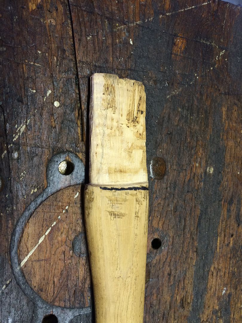

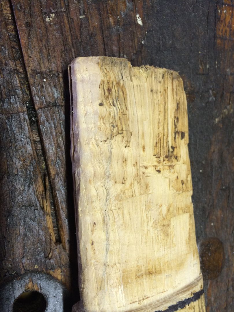

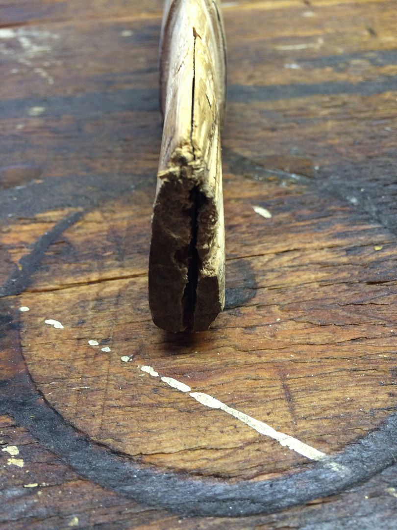

How much of the shoulder can be taken down? I've cut down quite a bit, to the point that the shoulder needs to be slightly reworked and it will be smaller. I'd really like to save this haft if possible, even though it is slightly mangled at the top of the eye and the grain is very wavy. Most of those cracks and chips will be cut off as they currently stick out of the top of the eye. Can this haft be saved?
...How much of the shoulder can be taken down?...
The shoulder should ideally make a nice tight fit with the bottom of the eye, filling the bottom of the eye, and not allowing the head to slide down. So it's a matter of measuring the dimensions of the bottom of the eye, and finding the lowest part of the handle that will still fully fill the bottom of the eye -- you can usually bring it down almost this far.
I'd bring it down just enough to get rid of the mangled part at the top of the handle (saving the rest of the shoulder for maybe another rehang sometime in the future).
