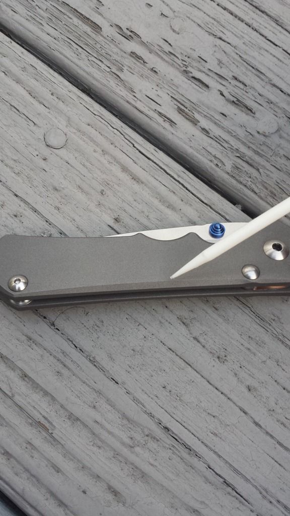

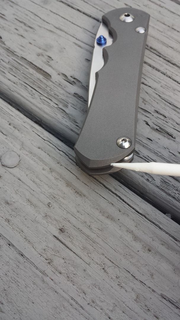

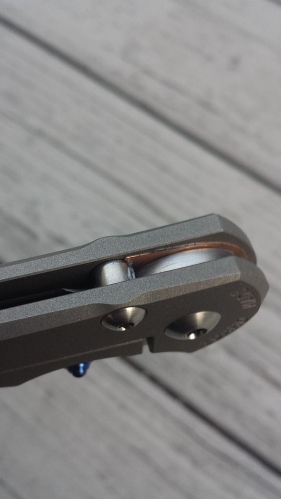

Some changes ive noticed. I dont have an original 25 to compare but these are things i think might have changed. The washer pic is just to show how it looks.
I also think the jimping may be a tad less aggressive...could be wrong on all these insights, but its really hard to compare without having a 25 right next to me. Overall, the knife is outstanding BUT i dont notice any improved grip/non clip digging with the clip now angled nor is the action any smoother than the 25 i had...knife feels almost identical.
