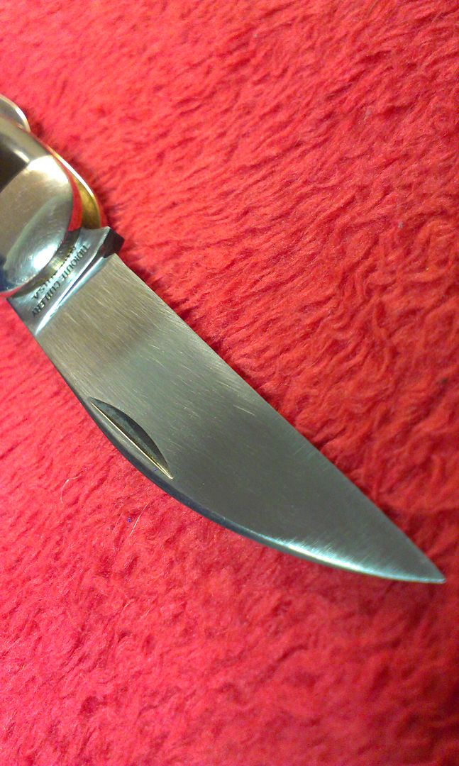

I only have experience with my single GEC, but the grind, not the bevel, but the blade grind was not all that even. The thing is, it looked good, and if I had sharpened by hand I may never have noticed, but with a guided sharpening system it became apparent from the variance in bevel height across the length of the edge.
I ended up regrinding the whole blade myself and now like the results.
Here's how it looks now.
It's an excellent edc. I can't wait to get more, but just like most knives, I'll expect to put a little time into making it mine. :)
That is pure awesome. Great work :)
That reminds me of the Kerry Hampton treatment that someone had on their SBJ. I like the idea of a thinner regrind!
i was inspired by Strigamort and full flat ground my #25, and put an edge on it with some water stones, and cut some food to make it patina. I really like the satin finish on yours Strigamort:thumbup:.
Thanks guys, and especially you shrapne1 for your kind comments via email. :)
