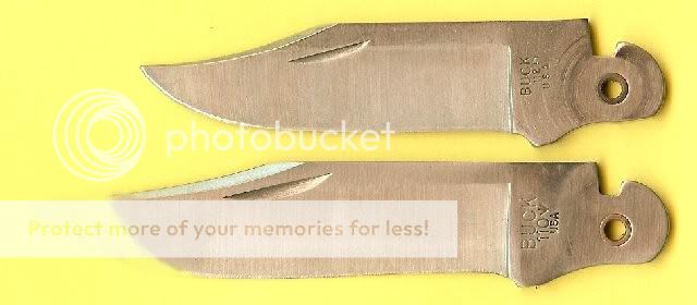

We have talked frequently about reprofiling a blade. So I played with one today.
A tip got broken off of one of my 470's.
So I thought I would play with it versus sending it back to Buck. It didn't take all that much time using the coarse diamond hone in the Lansky clamp.
Here is the reprofiled blade and a normal 470. I like it as it looks like it might give more of a skinner type edge, like on a 103. Going to take it out tomorrow in the event we get something.

Nice job, Pack Rat. I bought a 120 and a 192 from the bay with broken tips. Got a good price and I wanted to try to reprofile a knife. They came out a lot like yours. The blade just isn't as pointy.
Ed, I could have put the same curve and point on it as the regular 470. Just wanted to play with the curve some. Stick some pics in here of your 120 and 129.
I may still profile that one to look more like it is supposed to, if I don't like the curve I have on it. But will wait to try some deer skinning before I decide. Or give it back to mom and let her play with it in the kitchen for a while.

I actually like the look of your re-profile more than Buck's original shape... :)
...And it looks familiar (well, not your pic, but the shape)...I think there was a question during the Summer about an eBay auction with a blade that looked like it had been shortened but the auction owner denied it...
Anyway, that looks pretty nice...I wonder if a shortened & "Pack Rat Profiled" 110 blade shaped like that and put in a 112 frame would look as nice... :p

Um...No, Dave...You are wrong again... :rolleyes:
And I've built several 110/112 combos, as well as 426/442 combos...and the only real difference in the *blade* is the length...Rocker bars are longer, but the notches, tangs, bushings, choil, etc are all similar...
Reprofiling a 110 to the Ratty Profile and mounting in a 112 is very do-able...since all you are doing is grinding ~3/4" off the tip of the 110... :)
Here's an idea...Let's do a "Group Build"...I can donate a new "Idaho" 110 blade w/bushing and a pair of used 112 liners (with or without Buck scales)...Let's talk Ratty into re-profiling the 110 (grind the tip to the same profile as his 470 re-profile), and if we can come up with a 2005-era 112 rockerbar, spring, and spacer, I'll put it back together...then we need to talk Flatlander into mounting a couple scales on it... ;)
...And we'll have a Custom 112 to give away at some future date... :D

Question: Would the reprofiled blade still lay down inside without a tip sticking out ??
Sure, I could do that, but so can anyone with a Lansky or one of the other clamp or other systems. Or whatever one knows how to do that with.
I am still out in the country and don't have a 112 along to compare to.
Crude photoshop on this laptop touch pad.
I don't think I took enough off as compared to the 112 blade
I believe the point on your photoshop image would be sticking above the frame of the 112. I think some of the top would have to go.
