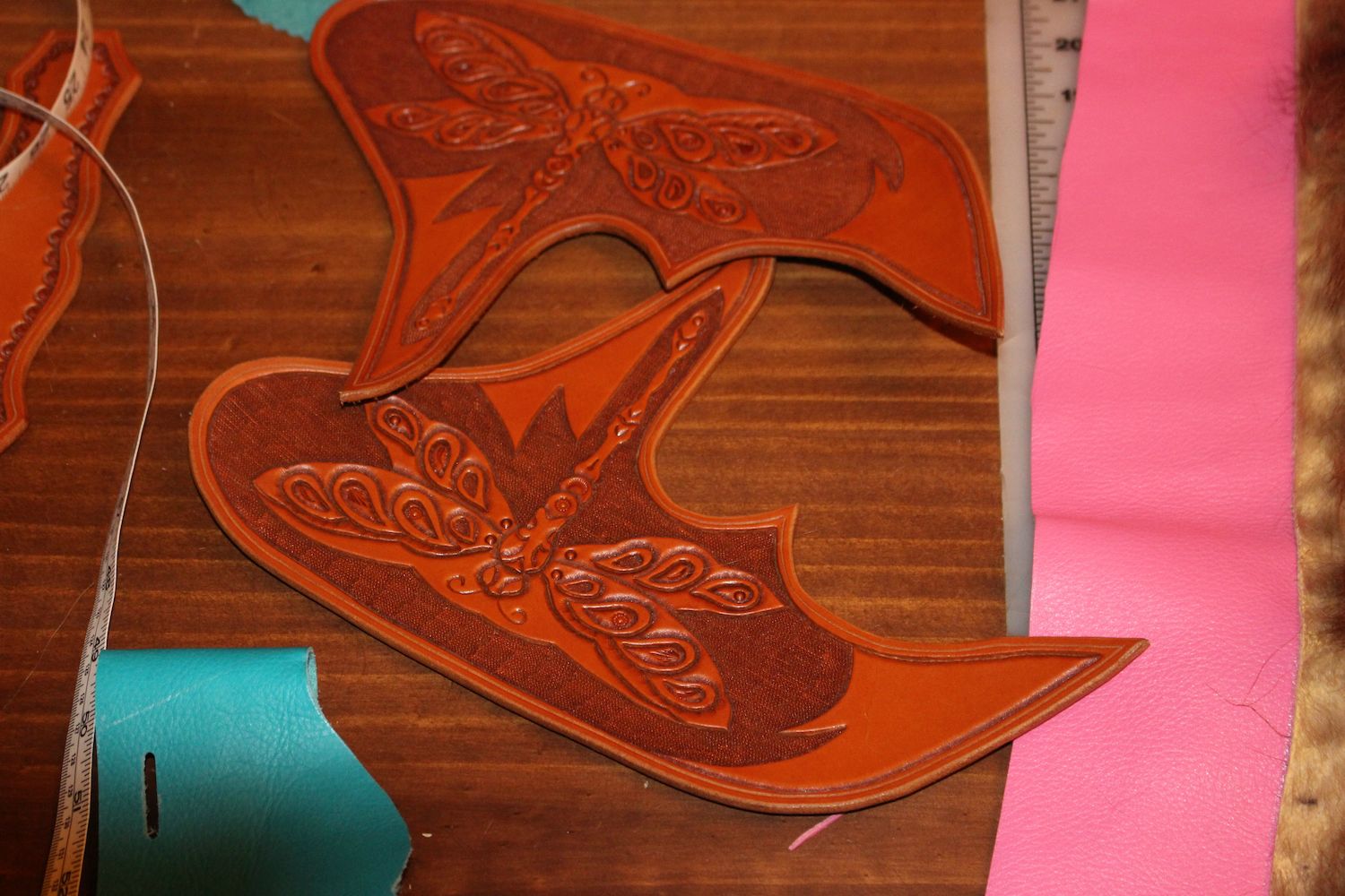

Cara wanted the yoke to be carved in a dragonfly pattern. Not just a dragonfly but a tatoo style dragonfly. This created a design change right from the get go as what she wanted would not fit on any of our standard yoke patterns. Hold on here we go:
Nichole carving the tatoo dragonfly on the new yoke pattern:

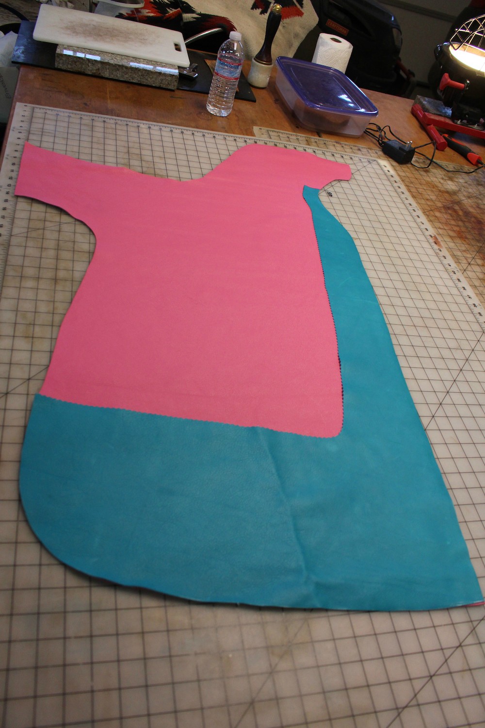

Here she has all the bevelling done and is doing the bar backgrounding. Meanwhile out in the shop I'm working on other parts. Here is one leg with the double fringe overlay part cut out. The original plan was to have the whole leg tourqouise with pink highlight fringe but that side wasn't big enough so we had to flop the colors. I also had to change the top of the leg quite a bit due to the new yoke pattern,.

Here are the two dragonfly yokes. They have been oiled, finished and had the edges rubbed. They are waiting thier turn to get glued on.
