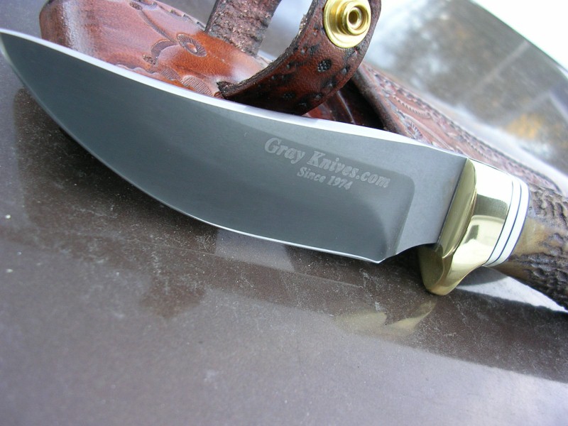

this is O1
I think it would have looked cleaner with-out the double quench
Brian, you're on. It's a mess because of when I beat it with the file (the edge suffered a little), but I wouldn't mind keeping one of my own knives. Or really, if you can resurrect it and like it, you can keep it. I will try the fresh "O1" first and if that goes, then we at least know the steel isn't mismarked. One step forward, two steps back! The story of my knifemaking life...
nice and clean Dan. Here is one of my cleanest to date.
Yep...here are the dirty hands again ;)
