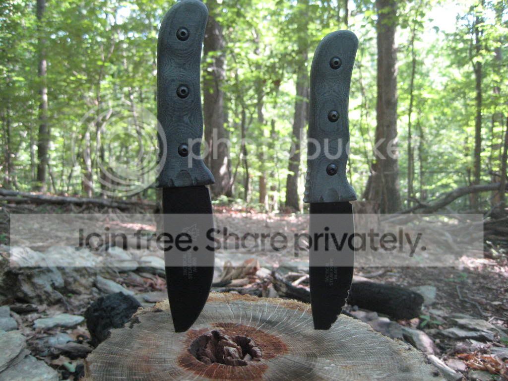

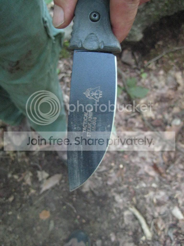

A shot of the TOPS knives:
Wonder why they serrated the tip like that. Hows it work?, Ive never seen that done before.
When you think about it, the design leaves the best part of the knife for whitling wood. If I were going to have a serrated blade w/ me I would be glad its there.
I agree. seems pretty innovative! Do they extend all the way to the tip, or fall short?
They work, but they are obviously designed for cutting the gristle on meat. That's the spot you hit when you are really digging into a steak! They aren't as pronounced as other serrations. Steve and I agreed that, for bush purposes, if you WERE gonna have serrations, they should be just behind that spot and a little smaller in span. So, just before the belly of the blade. They don't go to the tip. Check for my past threads with other close-up pics of the serrations.
The tip of the blade is where you do the most skinning (Steve, a very experienced hunter, thinks this'll make a great skinning blade), and so serration anywhere there would be in the way and make things messy. We all know that serrations by the choil interfere with whittling, carving, and notching, so that's not the place either.
Very neat knives though. I think serrations have no place on a skinner as well. They do look very subtle on these.

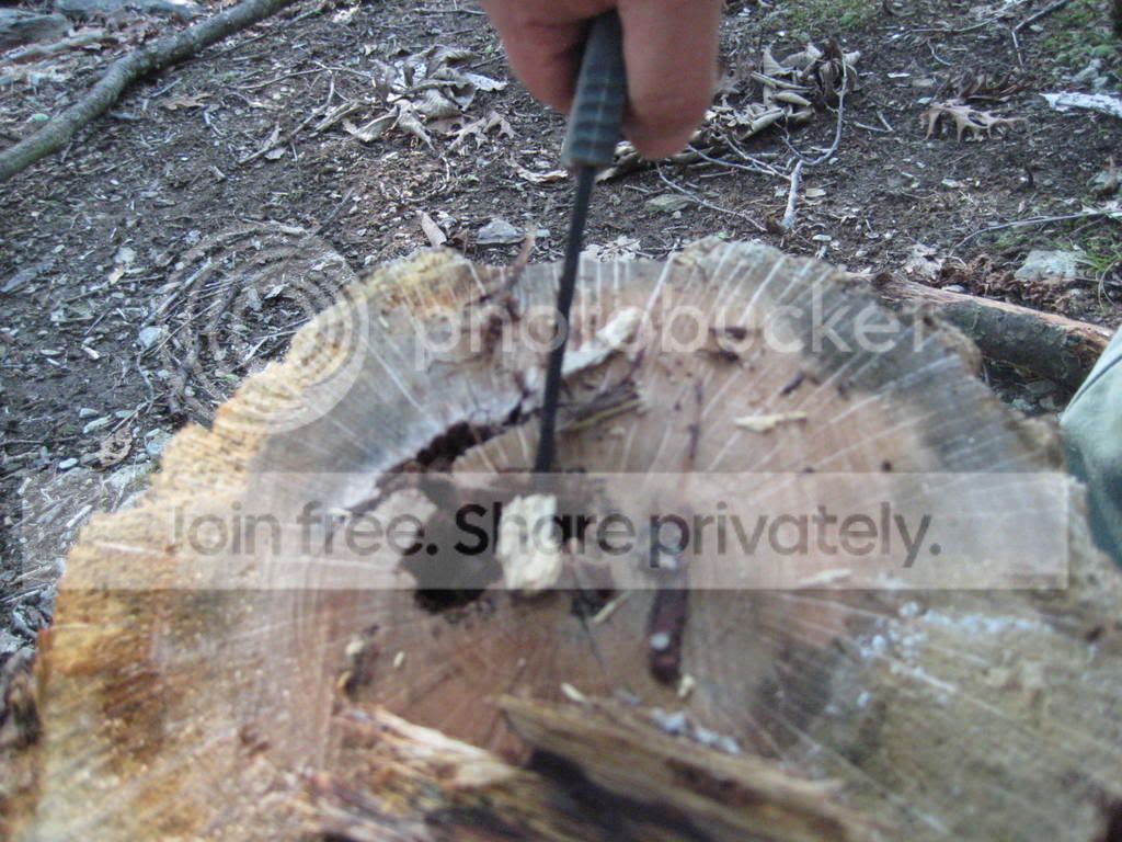

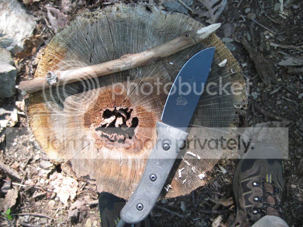

The knives are only 5/32" thickness at the spine, and are flat ground down to an almost zero edge - there is almost no bevel. They whittle through hardwood very easily, and you can penetrate deeply or shallowly as you ewish with superb control. I whittled a quick stake (stake knife? :D) here in no time with just push cuts:

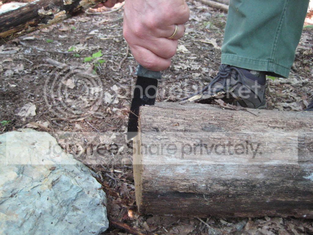

It also handles abuse superbly well. I think it is differentially heat treated, because the edge holds amazingly, and the blade geometry makes for easy batoning, but it bends incredibly wothout damage, returning to true. We just did baby hits with the baton and this thing sunk right in:
It also took lateral stress very well. Note the bend in the blade (crappy photo sorry), and it returned to true every time:

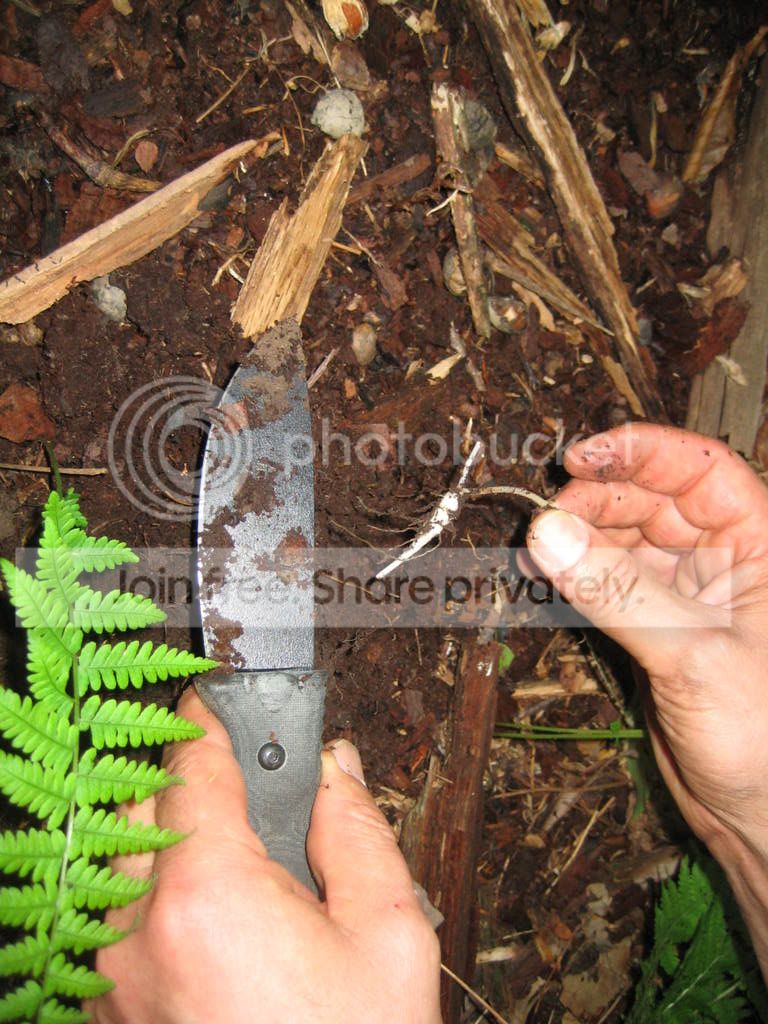

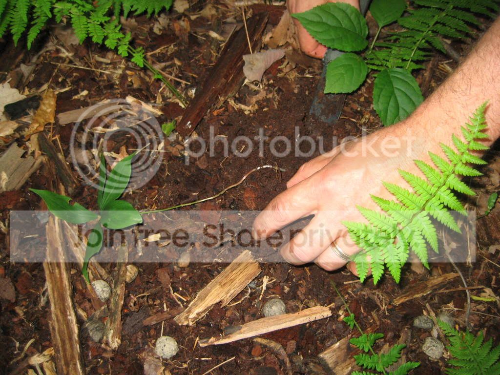

We also dug up and ate some cucumber root. We found them in soft soil and harder rocky soil. The blade had no damage to the edge and still shaved. See photos in next post. Also. a link to the TOPS site:
http://www.topsknives.com/product_info.php?products_id=258
Here are the diggin' pix:
