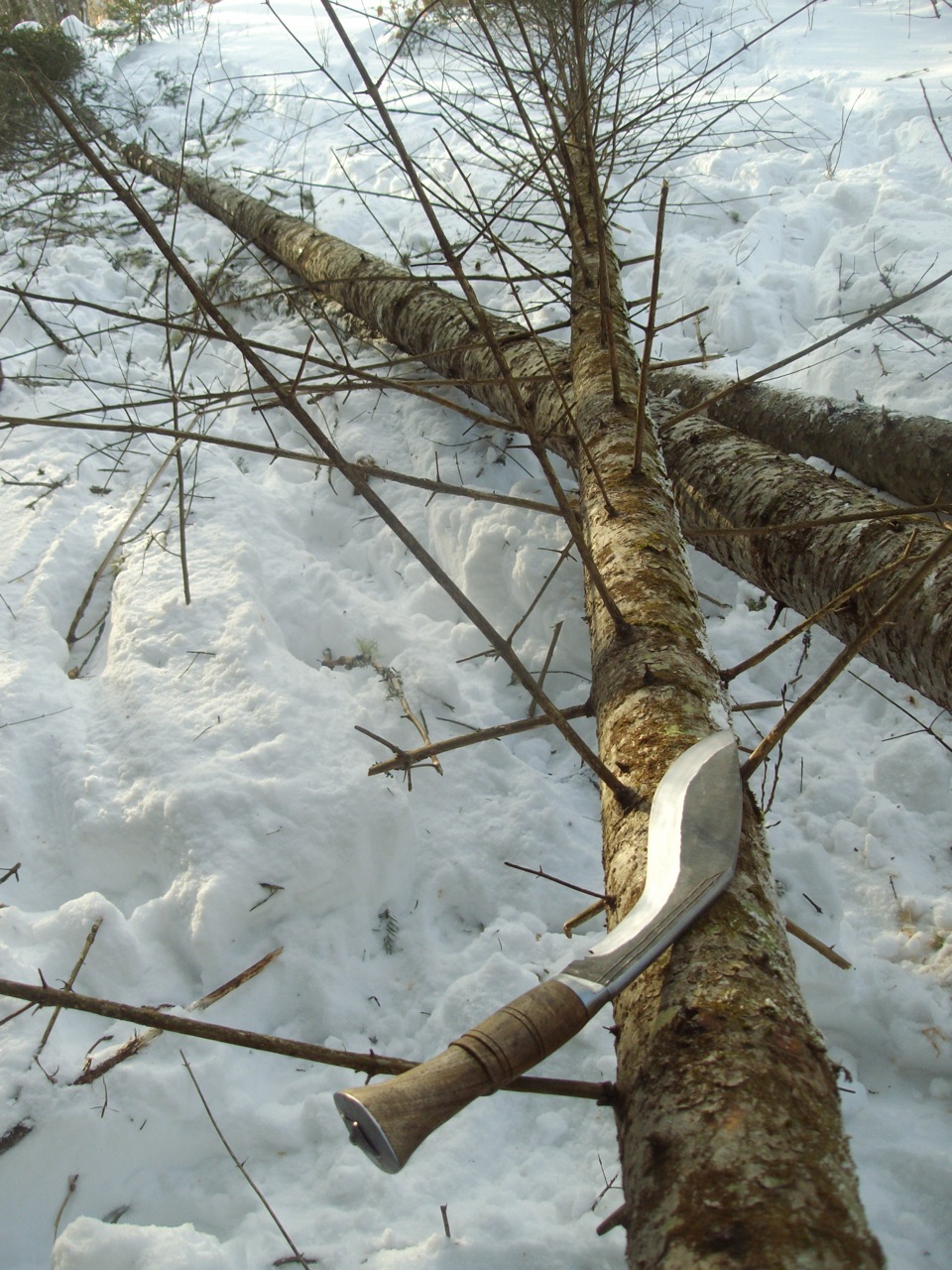

I had taken another ax along that day, a 2 3/4 lb. Swedish military surplus single bit on a 27" handle, with the edge filed down the way we like them. So before heading back home, I felled and limbed another fir with that one. The edge remained intact…
Then for good measure I chopped down and limbed a third tree using only a kukri knife, a new one that a good friend had kindly sent for us to test out. The edge on this kukri was thinner than others I'd seen, but when put through the same treatment as the cruiser, it passed the test with flying colours, no damage whatsoever.
Thus I suspect that it can't have been only those 'tough' branches that were to blame…
