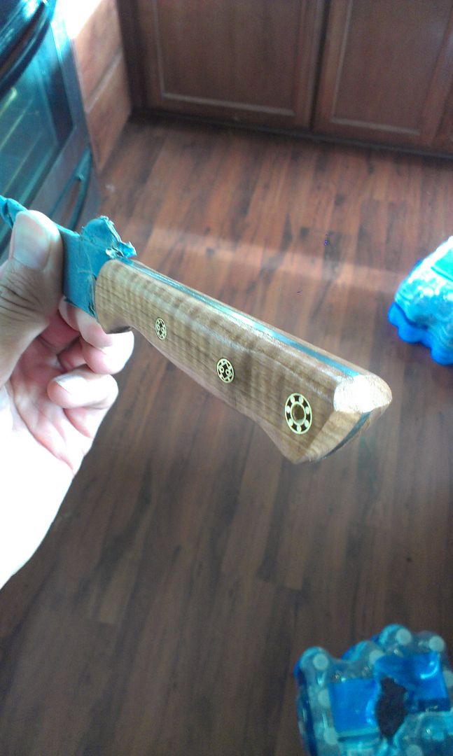

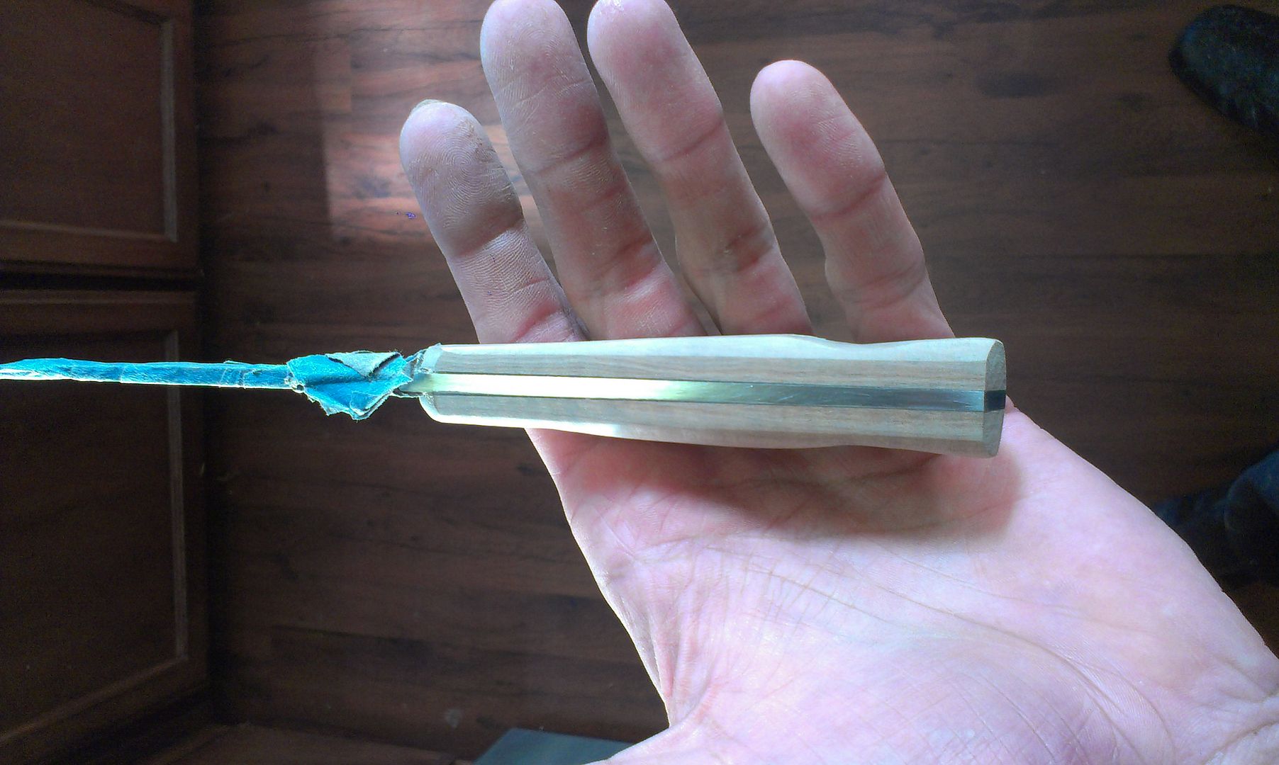

Here's a couple of pics of the scales as they sit. The second pic has a little water on the scales to show the flames. I've still got work to do, but let me know what you think.
There is no need to apply CA to stabilized wood. Sand, polish, wax.

The smearing is more than likely from your paper. Try some of your paper on a piece of scrap wood and see if it leaves behind any discoloration or smearing.
A matter of preference, I think.
Stabilized wood can be brought to a nearly glass like finish without the CA.
I agree that with the CA, and done right, it looks phenomenal, but I'd go with 2000 grit and maybe a light buffing depending on how it looked.
Reason? You are setting yourself up for extra work, for no benefit.
Either way, you're going to need a lot finer sandpaper than 220 grit.
CA won't absorb into stabilized wood, so the finish would just be on top of the wood. Polishing the wood will have the same effect as polishing added CA.
Why bother?

Yeah, I thought it was probably the paper. I tried the same 220 on scrap (and on the top of the knife, away from the pins) and there weren't any problems. My hunch is that the wood/resin is hard enough to keep loose abrasives off the wood and that it is the epoxy/cf I'm seeing.

That makes sense. I went ahead and tried the finish on a lanyard bead that I made from the same block of wood and after two coats it's just a little hazzy, but it really does look good to me.
I'm going to try the same thing on another scrap using just fine paper, buffing and polishing and see what happens.

I didn't clamp the front with enough pressure while the epoxy was setting. Because of this I have a couple of voids between scale and tang. The obvious answer to me seems to be mixing and filling with a little of the same epoxy. Does that sound right?
You are depositing brass/metal dust into the pores of the wood. It darkens almost immediately at that fineness. Carefully filling all pores before sanding, and sanding in such a way as not to smear the dust into the surrounding wood will help. Cleaning the surface with a cleaning spray , like Windex, and then rubbing it off with a clean paper towel will usually remove any remaining smutz.

Okay, that's exactly what I'll do then. It's a little difficult because I don't have the rear pin on a flat, but I can figure it out.
Regarding the question about the gaps... The epoxy that I used is clear. It looks a little bleh... Would it be possible for me to cut a little bit of the epoxy out between the tang and scales, then fill it with dyed epoxy? What about mixing wood dust with the epoxy? I've never heard of, or tried anything like this, just trying to run it by you guys to see if it's a huge mistake to try. I'd love to make the front end look better, but I don't want to totally mess it up trying. If it's viable, what's the best course of action?
