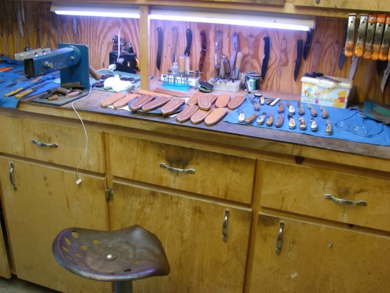

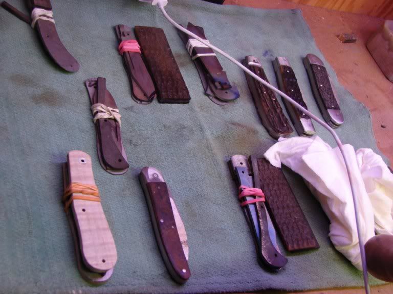

I have been working instead of being here for a week or two. Stay tuned i have a few pictures of the the big show knives. Several 2 blades moving on to three and four.
Here are a few kwik shots Rick snapped off.He's been busy,trying to take care of custom orders of many types of knives & set some Blade Show knives aside
I figured you'd like to see these.Most of these are not 100% finished out.

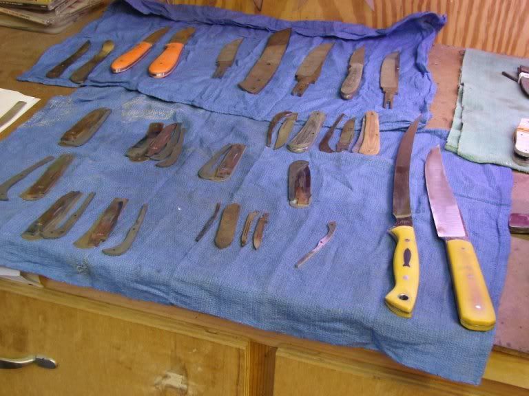

Various WIP stages here

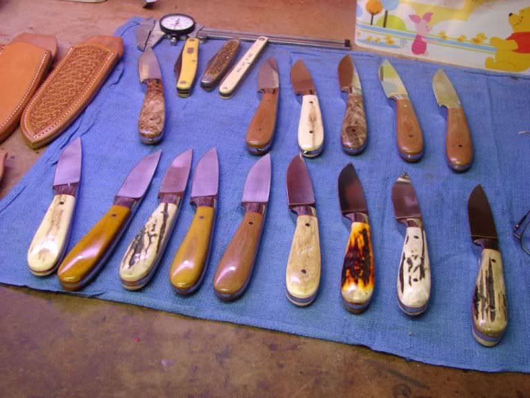

This is a large order of Hunters,for a long time customer of Rick's,from way back

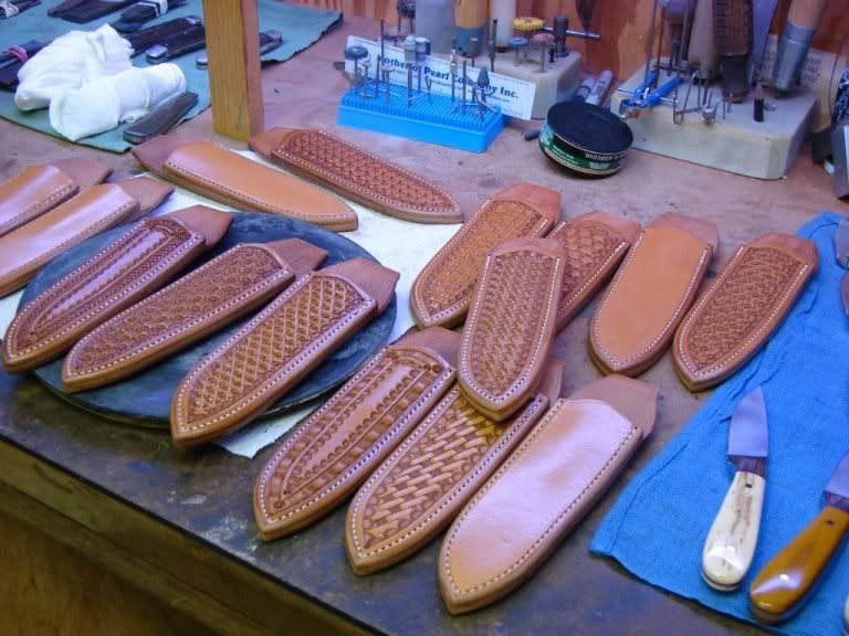

Here's the Larry Parson's custom leather sheaths for that pile 'o' beauties
Folders for orders & Blade Show
Rare stag Menefee folder has a home already & it's not finished

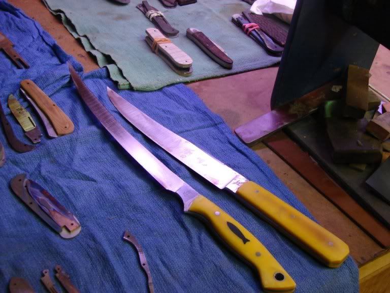

More folders & a peek at two BIG knives,one a fillet (newest & biggest size & design to date) for a very deserving hard working man & the other,is actually a one of,it's a new addition to my kitchen set from Rick witch has been in the making for quite some time. I named that the "Five Points Coffin" A large steak slicer,fillet,big bad boy,5/32" CPM 154 ss tapered tang,the coffin handle was Rick's idea. Top left corner,second knife in is another one for my set,a very unique design swayback handle utility/parer,that's all Rick's thinking up,can hardly wait.

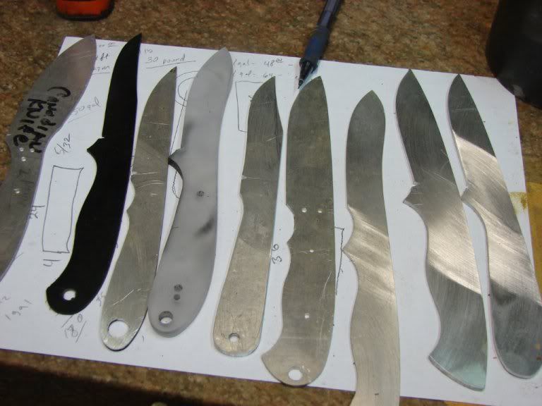

Here's some straight knife patterns,some new/reworked,some old,some exclusive
Well,you certainly can see he's been busy making knives.

Thanks for the kind words. I have been in high gear. I work different than most people. I make knifes like you work livestock in batches. I try to use my time wisely. When knifes are in the heat treat oven or cryo-cycles i cut out and profile the next bunch. When glue is drying on handles i am grinding blades. I have about 5 grinders each with a different belts when i start finish work i just go from machine to machine alot of time several are running at the same time. I go to 600 grit belt on everything and then i go back and hand sand from 400 grit to 5000 grit by hand. I try not to use a buffing machine most of the time. This year will be the least amount of knifes i have ever took to a show. Maybe ??????????? 12. The last several years i took 30.
MIKE I CAN STEEL GETTER-DONE you think i am getting to old to nock-em out
Rick, it's obvious you are a hard worker no matter what the job, but this really is something: "i start finish work i just go from machine to machine alot of time several are running at the same time."
Wow, standing between 2 belt sanders, blade in each hand, head going side to side as you keep checking, doin em both at once !
Well if that isn't the best use of 2 hands ever.
