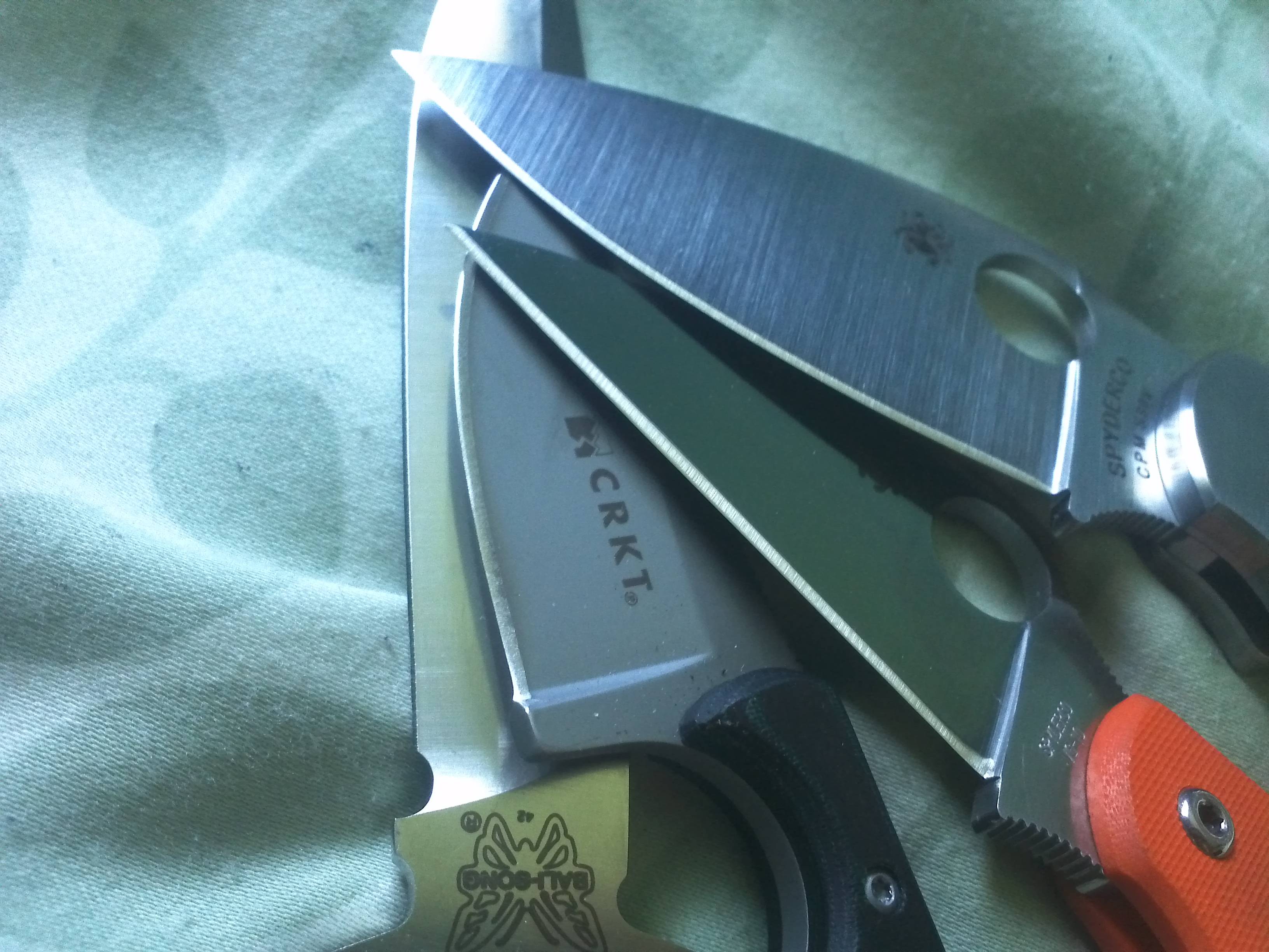

Every so often, I get a knife from a manufacturer (partial to Bussekins, ZT, and the like; all very reputable makers) that ships with an edge that is barely useable. I noticed that these edges to be somewhere around 40 degrees per side by rough estimate. This isn't a problem for people with Edge Pros or other very high quality sharpeners, but in my particular case, I'm stuck with a Lansky diamond hone set. It works very well for regular sharpening of smaller knives (~4" or less), but it's terrible for re-profiling. Ideally, I'd like to have my Scrapyard 511 around 30 degrees inclusive, but I'd spend the rest of the summer trying to get it there. As a result, I have to settle for shaving it down to 60 inclusive and not take full advantage of SR-101's ridiculous sharpenability. I'd love to get something better suited for the job, but it's just not in the cards right now.
Is there a reason why most manufacturers put such steep angles on blades from the factory? Or does it just depend on the person sharpening in the factory? I understand that it takes less time per knife and technically makes the edge more durable (thus freeing them from liability of people who abuse blades), but it's not a knife if you can't cut anything with it. In short, shouldn't a knife ship from the factory with ideal, or at least functional cutting geometry?

Easy--because thicker edges don't take off as much material from the primary grind so it's faster to grind an obtuse edge at the factory than a thin one. Long story short, it's corner cutting. Whether it's the fault of the company or the fault of the individual doing the grinding is harder to pin down in most cases.
My Spydercos have always been around 30 inclusive, my Benchmades on the other hand. They must be around 60 to 70 inclusive. CRKT a very nice thin grind aswell, but I only have one. My Benchmades are horrible. It's just easier and quicker to do a steep angle.

That's about what I thought. Makes for a very disappointing first impression, not to mention the amount of work involved with re-profiling in some cases.

I think they do it because so many users are so dumb: using knives in the way that kills the edge immediately or simply cutting themselves badly if it is ground too thin or too sharp. And most users have very different sharpness standards anyway. I know from my own experience.
From those users who really like it very sharp many can do re-profiling relatively easily and do not see it an issue.
So the manufacturers have to look at it statistically and weight all pros and cons. For those who operate in niche markets (targeting collectors or self-defence enthusiasts for example) it pays off to go more aggressive with sharpening. For those dealing in wider general market: better to be safe than sorry... It makes total sense to me, no BS.

Come on now. If one thing can be said about the Busse-kin companies, they are not prone to cutting corners. If you don't like the angle, give them a call or an email and see if they will reprofile it for you. Heck, they are the first to bend over backwards for their customers. I can only speculate as to why the edge angles are so large. Probably because it appeals to every common denominator. It always easier to take metal off later than to put it back.
There are a few sharpening services that use the Edge-pro as part of their main equipment. I'm sure they would be very happy to put any edge you want on just about any knife you can mail to them.
