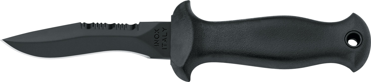

I’ve been looking for a new Spearfishing knife and recently picked up a Riffe Wrangler Dual Serration
I also picked up a Spyderco Fish Hunter but do to its poor sheath retention have relegated it to a rod and reel knife vs something I’m gonna swim with
Now the job of a spear fishing knife is to stick fish in the brain and cut through super lines like Dynemma and heavy mono.
So ya need something pointy and serrations are desirable
For those of you not familiar with Riffe they are a great company with a rich history in Spearfishing and it’s Founder Jay Riffe is a legend in the world of spearfishing
I’ve been using Riffe Spearguns and on a recent trip to California and Baja Mexico I got to spend some time with J&J Spearfishings owner who is part of the Riffe Family and put the Wrangler to use killing some fish
The steel on this knife is Nitro B and while rust resistant if not really cleaned well after use will show rust quickly but that’s what salt and blood will do
What makes this knife system work is the sheath system and handle
It’s not fancy but the large drain holes and the way the knife snaps in as well as the small lanyard bungee that wraps around the tip of the sheath for extra security but still enables the knife to deploy by just yanking it hard and moving your hand out is well thought out
If Spyderco would have put more thought in their sheath I might have never picked up the Riffe
Yes I could do a custom sheath for the Spyderco but the Riffe knife package is close to what a good sheath bender would charge for a sheath
I still have aspirations to have Matt Gregory make me a custom Spearfishing knife and sheath over the winter when he has time but for now the Riffe Wrangler in its different configurations is a winner and priced very reasonable

I'm 99.9% sure that MAC knives out of Italy (owned by Boker, as is FOX) makes the Riffe knife. They make MOST dive knives in the market and private label them for dozens of small-time, niche spearfishing brands.
Some ppl request sheite 304 steel to keep prices low and others spend a bit more for quality. Riffe is using their best material, but the knife and sheath design is not my favorite .
Americans like big (4"+) spearfishing knives... But the rest of the world uses 3-3.5" blades and in my opinion, anything over 3.5" risks an accidental hand-stab while subduing your catch. 4"+ might be fine if you're only targeting 200# yellowtail, otherwise 3.5" is perfect and much safer on fish right down to 1#.
I use a 3.5" recurved blade of theirs in 4116 steel presently. It eliminates the "dagger" illegality I face traveling to some places, while still being a super useful fish "silencer", and also has other utility and geometry advantages that a triangular profiled dagger does not.
Any knife with this shaped handle, the ubiquitous related plastic moulded sheath or a handle like the Riffe knife is made by MAC.
In my opinion and experience, the single best placement for a freedive knife is at 12:00 on your belt, so it can be reached with either hand.
This necessitates a sheath that has virtually no length of handle sticking up above the belt, so that it does not dig into your stomach when bending over, putting on fins, etc. No handle sticking up also reduces entanglement issues.
When I carry 2 knives (most times), they are on either side of my belt buckle.
If 3, then it goes at 6:00. I never wear a knife on my calf or arm and try not to wear one on either the 3:00 or 9:00 side of the belt.
The "Riffe" style of sheath leaves something to be desired in this regard. It works well for calf placement or hip placement, but as I said... Those are suboptimal locations and can even lead to increased risk of entanglement as well.
A symmetrical handle also better allows for ambidextrous use and if you're caught if some fishing line, netting or need to cut your shooting / reel line in a damn hurry, centreline knife placement and an ambidextrous handle is really the only option.
If Spyderco wants input on a design refinement, I'm available and very happy to discuss with @Sal Glesser
I know many ppl who would love a quality spearo knife, but the blade design and sheath system of the Spyderco just doesn't quite fit the bill. And yes, I get that it was a modification of the existing aqua salt design and had those constraints.
My little 3.5" knives with robust tips have taken down some large fish with insanely thick skulls.
I'd love a refined design in serrated H1 and have a design / idea for an amazing usable sheath that would be CHEAP and ideal for freedivers / spearfishernen.
Until then, the 9cm recurved MAC is the best compromise I've found through my years of spearfishing.
