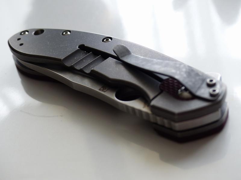

Your Southards looked so good that it inspired me to change the color on mine as well. After reading this thread several times I went out to Walmart today and bought some Rit Dye.
3 cups of water
1/2 bottle of Rit Dye (Wine)
2 tablespoons of vinegar
I simmered the bar stop for 75 minutes and the scale for 90 minutes
I really like how it came out as it is a rich deep burgundy. I hope my first attempt at including photos works. Sorry if they seem a little dark but its as close as I could get to the actual color. When I would play with light or settings the photos had much more red than the real thing. Thanks for this thread!
