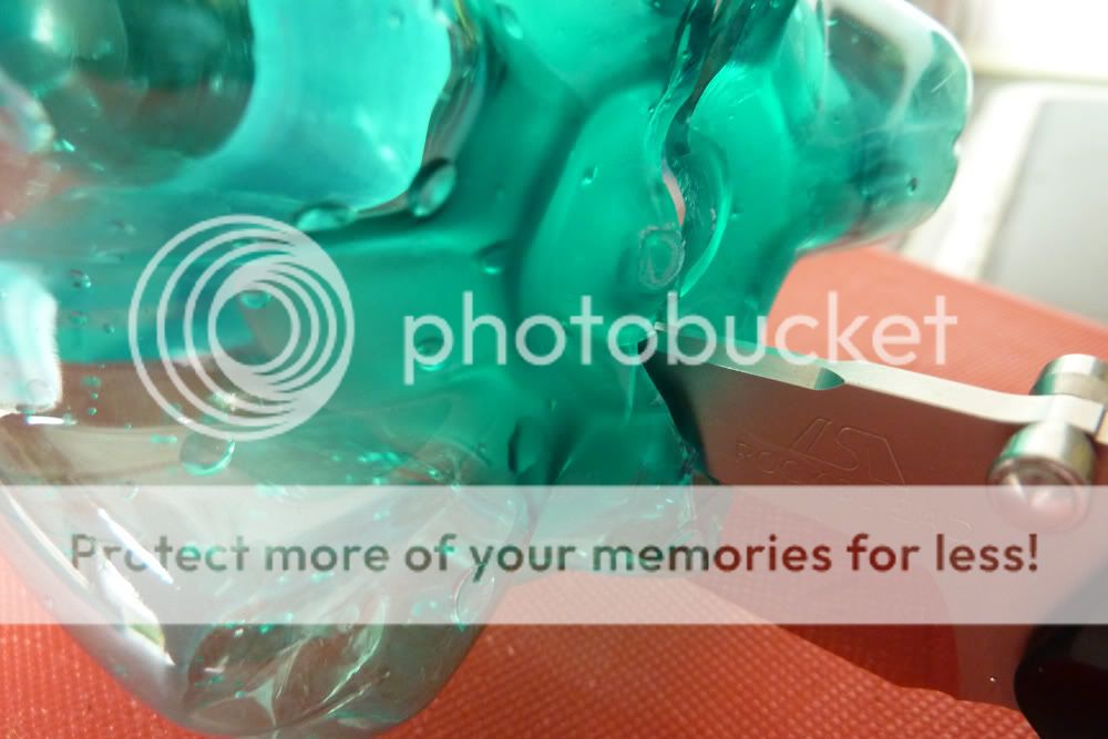

I have update it with my mighty bottle but cutting test...
The edge and the grind are so powerful... And the ergos are with no surprises: the torque is transmit to the blade at 100%.
(This is not the case of every knives YMMV !Many knives that I love were not able to cut the but of a plastic bottle as easy as this one.
The grind, the ergos and the way the force is applied to the medium are very important factors.)
