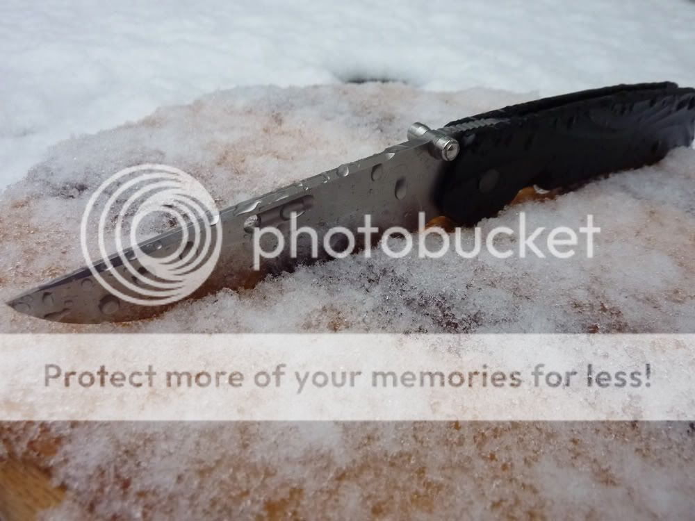

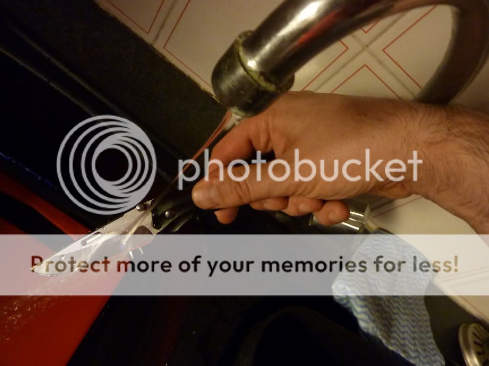

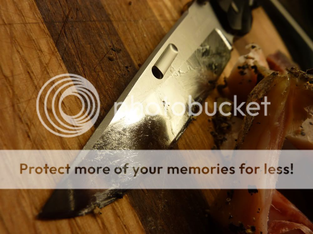

A little update:
http://nemoknivesreview.wordpress.com/2010/12/08/rockstead-higo-j-part-iii-masamune-in-winter/
Cheers
Nemo

The mirror ZDP as you see it has been EDCed since september...
Scratches will come but so far so good ! ;-)
Not a big deal as I'm used to Jacques Mongin's folder mirror finish...;)

I did not cut anything. But the tip may have been in contact with an hard surface without me noticying it....
The more I think about it (and when I see how I could fix it)
I think it was the very edge which rolled chaotically giving the look of a bad chipping but which could be fixed with a light sharpening (without removing matter)
The edge has touched something hard (it's happen at the tip and this could have happen without me to notice it)................
