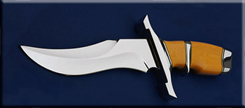

Hey Bootstrap,
I came across this early Arctic Fox and thought you might enjoy seeing it. Look anything like yours?

Hey Bootstrap,
Actually, no it doesn't look anything like my AF, The blade is roughly the same but my handle is thicker top to bottom and my handle length is noticeably shorter.

That last picture with the Rosewood or Cocobolo is just like mine. One thing that no one has mentioned is Rod's trick of making the handle fit your hand perfectly. When I arrived at his shop, we shook hands with our left hand. When asked why he did that he said that that way he could make the handle fit my hand perfectly; and when finished, it did. When someone ordered one of my knives long distance, i'd insist on a tracing of the hand that would hold the knife and from that it was easy to design a handle that would feel almost as good as your d##k.
