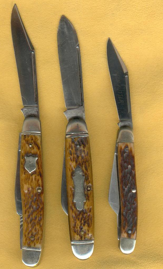

These next three just may show the difference between Early and Late Rogers (style - sheesh) bone! Or not??
Whatta yathink??
Charlie I think those 3 are all early...
Elliott Yours is Pocket worn early Rogers Bone... I think. :)
Elliott, I am more sure of yours than most. Like Darrell says!
