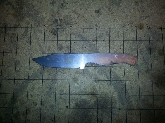

I've seen some interesting ways of getting the rough general blade shape through drilling and such without a band saw and was hoping for some helpful hints/tutorials on how to do it. I don't have a band saw and want to see what I can do without one!

4" angle grinder with cut-off and grinding wheels and lots of safety gear. I have a metal cutting bandsaw and actually prefer the angle grinder. As long as you follow the safety rules, there isnt much you can't cut. Plus cut-off wheels and grinding wheels are a buck or so a pop. Much less than bandsaw blades...
This is post angle grinder cutout. Took about 10 minutes.

I too use an angle grinder. I cut straight lines with a cut off wheel just outside my layout. Then I switch to a flap disc wheel on my angle grinder and finish it to the layout. I find the flap disc wheel to work better than a grinding wheel as it removes material quickly yet doesn't try to dig in at any certain spot.

I've tried a hacksaw a few times and to say the least it's tiresome and very very time consuming so I was hoping for an easier option! The angle grinder sounds like an excellent idea though and considering they're less than 50 bucks, I think I'll have to pick one up!
High tension hacksaw for me as well, a good blade and lube to keep I cool, it goes quite quick. Regular hacksaws suck. Must be a high tension hacksaw.

i like that klein high tension hacksaw and lenox blades. the buck bros ones wont cut it. standard tips for this is: Try to be cutting no more than an inch away from where the steel is clamped in the vise. You can cut fast but beware the more heat the less life of the blade. The blades are designed to cut one way only. Let the saw do the cutting!
Hacksaw worked just fine for me. Then I switched to 4.5" angle grinder cut-off wheel. I've made about 50 knives with a 1/16" cutoff wheel from Home Depot for profiling and I've never had a wheel come apart. They are quite strong. I also cut in straight lines, of course. And I wear safety gear.
I decided to go check out the sales over at home depot and picked up a 4.5" angle grinder for 30 bucks plus a few cutoff wheels. Thanks guys!
