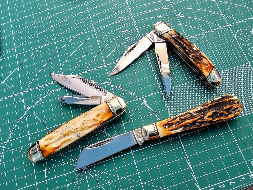

I picked up a few of the Cinnamon Bone Stag series recently. One of the knives had a really gritty opening so I used some dish soap, hot water and a toothbrush to scrub it.
Wouldn't you know, the black stuff on the 'stag' rubbed off pretty easily. It also left the knife looking fairly unattractive. Further experimentation revealed that the black stuff is soluable in rubbing alcohol. So, I went through a couple of them with the toothbrush and alcohol.
Ultimately, that black stuff appears to be a paste of sorts rather than an actual dye. It didn't penetrate the bone at all. The rest of the colors are actually flame burned, so there is no real dye on these.

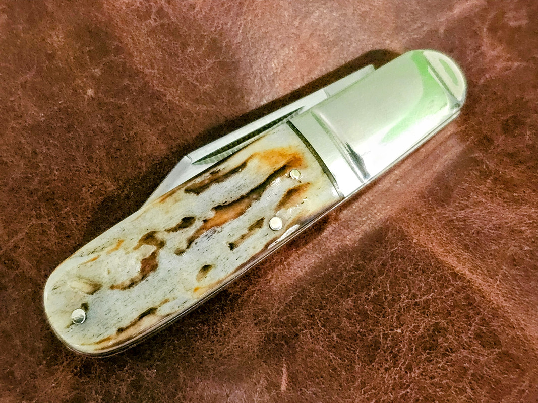

Here's the Barlow post alcohol scrub. Sorry for the crummy photos.... I had bad lightning and wanted to get it into it's new suit ASAP.

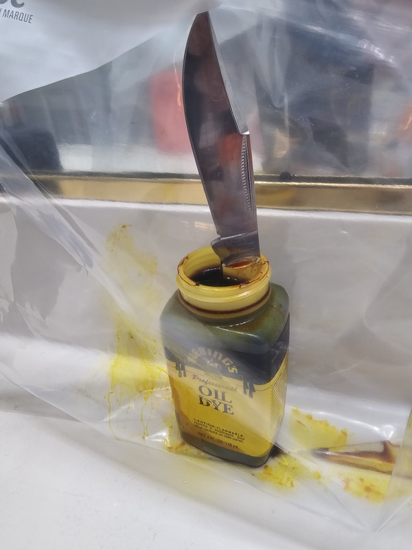

I forgot to take photos of every knife in every stage, but here's the Cinnamon Bone Stag Bow Trapper post alcohol scrub, soaking in yellow dye..... on to a few different brown tones after this..... Usually the knife has to soak for at least 24 hours to get good saturation. The leather dye is alcohol based so I seal it up in a ziplock bag. This is so the dye won't evaporate, dry out, or absorb any moisture from the air.
For some reason, California has decided I can't buy Fiebings leather dye here any more so I used this one from Angelus, which seems to give similar results. Smells about the same as Fiebings..... go figure.
This color is called Brick.
Once I'm satisfied with the color saturation, the knife goes into a clean ziplock bag and multiple rubbing alcohol rinses until it runs clear. Then it's polished with a bit of flitz and a polishing pad on the dremel.

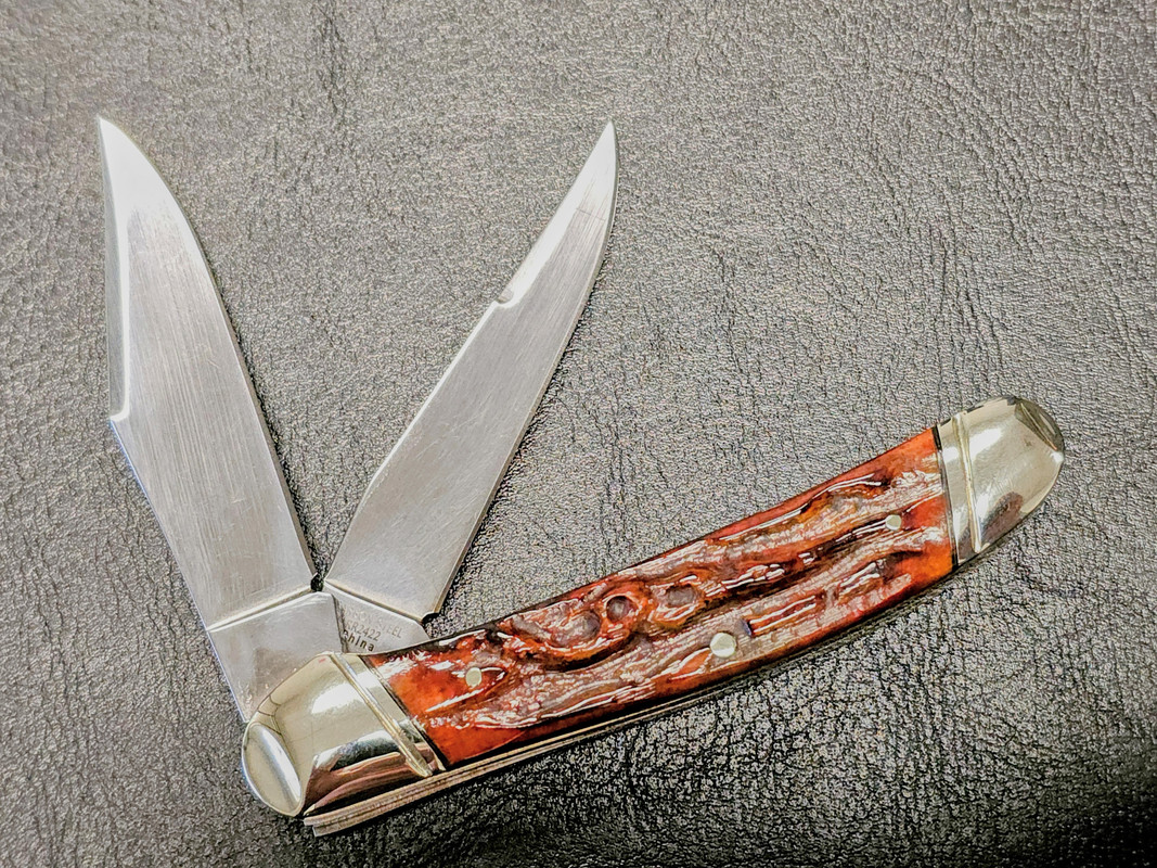

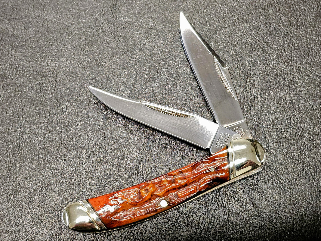

An observant eye will notice that these handle covers are obviously cut with a computer controlled mill. Not only can you see the straight lined grooves in the recesses, but it's also the same exact 'stag' pattern on each side. This is true of all the Cinnmon Bone Stag knives. The grooves were more noticeable after the dyeing process, so I rolled up some 320 grit sandpaper and did the best I could without obliterating the shape too much. In hand with my crummy eyesight, the grooves aren't too noticeable.
Final result....
I'll post the Bow Trapper at some point after it's finished.
Hope that wasn't too long winded.... the whole process is actually rather simple and yields much better results than using RIT..... no boiling water and no salt or corrosion to worry about!

You aren't kidding! Despite my Bone Stag woes, these are actually pretty fantastic knives. I'm actually not disappointed by the bone stag.... I look at it as an opportunity to make them unique and I'm very pleased with the results so far. Nothing quite like doing a little modification to make a knife special.
These look a little rough, but they will be wearing new suits in no time! BTW, aside from the black paste coming off, these are all excellent examples..... love em!
These two are excellent. The large one is basically a 1 for 1 copy of the case large stockman where it even fits into the same wet formed leather sheath.
The red one is about the same as a #47 except it has two springs.
After rounding all of the sharp edges and spending a little time on these, they are very nice knives. If that large one didn't have the stupid R in the bolster I'd probably carry it all the time. I don't know why that bothers me so much but it does lol!
