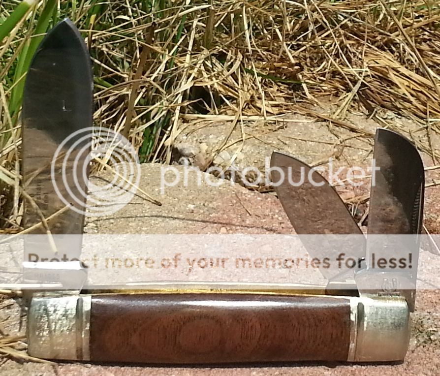

On Monday we had rain all day, and I was cooped up in the house with the kids. We were all getting a little stir crazy, so in the late afternoon I put on a movie for them and snuck out to the garage to mess around with my Rough Riders. I love that these knives are inexpensive enough that I don't worry about messing with them. I have practiced jigging the scales on my smooth bone trapper, and Monday I went ahead and replaced the scales on my whittler. This is what it originally looked like:
I do quite a bit of smoking (meats) and I have a friend that chops wood for the local Boy Scouts troop to sell, so last year he brought me some logs that he thought I might use for smoking. I don't know what kind of wood it is, and haven't used any, so I went ahead and cut up one of the logs he left and shaped a couple scales out of it. I finished it with ultra thin CA. I think it turned out OK, though I still don't know what the wood is. (I've never been good at identifying woods)

Nice job with the covers. Good looking knife. How did you finish them? What is ultra thin CA?
Thank you very much. It was my first time attempting to replace scales on a knife. CA is Cyanoacrylate, which is super glue. If you go to a hobby shop they'll have it in all different thicknesses. (ultra thin, thin, medium, etc.) I had some gaps, which I filled with sawdust from sanding the wood and then rubbed some medium CA on it. It basically superglued all of the sawdust into a solid, which matched the color of the wood because it's the same wood. Then I wiped it all with ultra thin CA, which is thin enough that it soaks into the wood. It leaves it with a smooth hard texture like a polyurethane, but instead of sitting on top of the wood it's down inside of the wood. It's really neat stuff, and I think I paid $10 for the two bottles. A little goes a long way, and I could probably do another 15 knives or so with those two bottles. You just have to use a little at a time and go quickly. It's super glue, so your work time is 5 seconds or so before it's setting up.
Thanks! I'm excited to experiment with CA. Probably on a Rough Rider.
