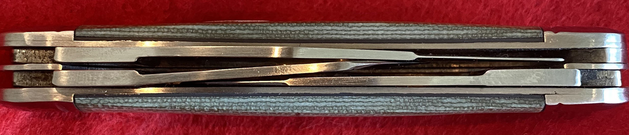

I recently bought one of the new Classic Micarta line, the sowbelly stockman line. I liked the knife quite a lot, but unfortunately it had some kind of blade stick/binding on the sheepsfoot blade. Part of the problem is the the two secondary blades have not been designed correctly. The spey blade uses a left offset, while the sheepsfoot at the opposite end has a right offset. This means that they live up directly and will strike each other on closing. The "cure" they used is to crink the sheepsfoot excessively. I have bought a few Rough Rider models and generally found them to be good to great value for what you are paying. I was wondering if this is common to all their stockman models, and to the Marbles stockmans too, or if this is something specific to this particular model? Any thoughts would be greatly appreciated!
I do have one 3 blade stockman and two 4 blade stockmans from other manufacturers, and they all have the opposite blades offset on the same side so that they nestle correctly. So what gives, Rough Rider?
On all my several Rough Rider stockman (all serpentine frame, and 3 7/8 closed and larger) and my one Marbles stockman (D2 with black canvas micarta covers, sow belly) the Spey/Budding blade is not kinked. Only the sheepsfoot is.
On the Marbles sow belly, there was significant blade rub on the Spey/Budding blade, against the sheepsfoot blade and liner.
I fixed it by slightly narrowing the inside of the Spey/Budding blade tip to clear the sheepsfoot, using my sharpening stone, and thinning the pile side liner maybe 1/1000 inch, also with a small diamond plate sharpening stone.
The pull dropped from well over a "10"/"the sheepsfoot had to be open to move the spey/budding blade" down to a "5".
On my 3 7/8 inch closed Rough Rider "Stone Worx", I had to slightly thin the inside of the Spey Budding blade tip to eliminate the rub on the sheepsfoot blade.
I no longer have any blade rub on those two knives, or any of my other Rough Rider stockman.

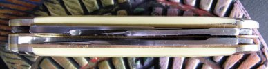

I'm not exactly clear about whether a blade offset is right or left, but here are some pics of the closed blades of some of my stockman knives from Rough Rider, Colt, and Marbles. Maybe the pics will give you some info related to your question.
(I've never noticed any kind of binding or excessive blade rub among the blades on any of these, or other stock knives I have from Rough Rider, Colt, and Marbles; these are the only ones for which I happen to have photos of the bladewell.)
Rough Rider carbon steel sowbelly stockman (clip blade at bottom of pic). Sheepsfoot looks slightly crinked to me. I'm not sure how you'd classify offsets; I'd say clip and spey are offset on their right (maximizing space between them), and sheep looks symmetrical to me.
Colt sowbelly stockman looks almost identical to me. Maybe less crink on sheepsfoot blade, but hard to tell because photo is from a different angle.
Marbles sowbelly stockman with drop point main (top of pic) and spey pivoting on one end and a smaller drop point or skinner on opposite end. I'd say all 3 blades are offset on their right, which I think is what you'd want, right? But there's still a fair amount of crink on the "middle" blade.
A Marbles stockman with normal blade configuration (slender clip and sheep on one end, spey on other) that's serpentine but not a sowbelly. All blades appear to be offset on their right, with a slight crink on center sheepsfoot.

I have this knife as well. I have always thought the sheep’s foot offset was a mistake just as you have stated. It seems logical that the krink would not have had to be so severe if the other handed offset would have been chosen. But what do I know? I’m no pocket knife scientist.
Jon that sheepfoot offset grind is definitely on the wrong side, not really sure why they'd do that. If it were on the other side it would have required only a slight amount of crinking. The type of setup on that knife would be better suited in a whittler with a large blade running down the center from the opposite side. Not sure what's going on with that large clip either, looks like it's crinked from the center of the blade! If they had put long drawn swedges on those blades instead of cut swedges it would have given the blades a lot more wiggle room too. The way the blades are ground they're only 3/4 the thickness of their tangs and they STILL don't fit correctly. Bad engineering there for sure.

Thanks Eric! Good thing we all have appropriately low expectations for this brand.
Definitely good to get my assertions approved by a real pocket knife scientist though! All the best my friend.
Perhaps they are using an existing sheepsfoot blade from another pattern.
I don't think that is it, because the new D2 knives have are the same and being a new steel to the line, they wouldn't be reusing blades from another pattern.
Unless you believe that RR knives are the only line produced in that factory. ;)
Otherwise... the only possibility left is that they don't know what they're doing. :D
I have a couple of RR small stockmans with that same quirk in the sheepsfoot offset. I had already come to the same conclusion you did.;)
