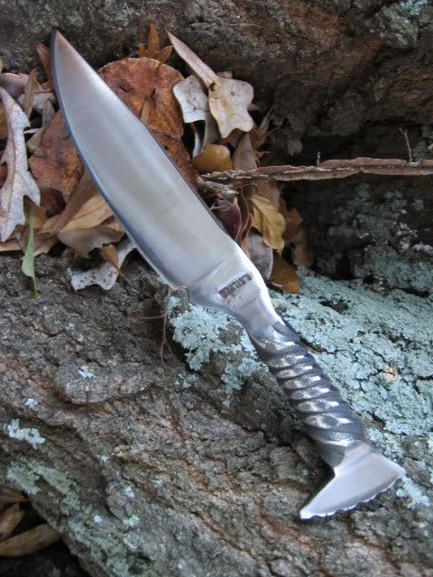

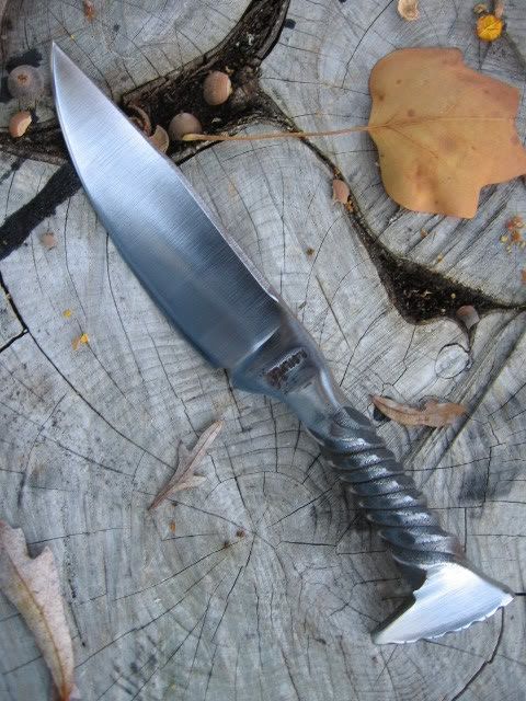

I think every new smith should use at least some spikes. They won't ever hold an edge like 1084. 1095, 5160, etc., but they are inexpensive, you can buy them in small quantities, and they move well under the hammer. There are patterns you can learn to put in the twist that look really good. When you become more advanced you can even forge weld some good steel to a spike for the edge and have a spike knife with a high performance edge that will take a heat treatment.
-Todd
