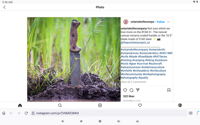

Rtak ii was 5160 wasn't it? If it has changed has anyone used both, any differences? Good or bad?
It was being offered in 5160 and a 1095...if it went 1075, the formula if 1075 they use is made for better heavy shock work at the cost of needing a small bit of more sharpening. See Pocket Knife Jimmy (The under glass imprisoner of great knives!) thread on the 1075 switch.
As of November 5, 2021 Ontario shows the RATK 2 with 5160 from Instagram. I doubt the steel has changes from then to now.
