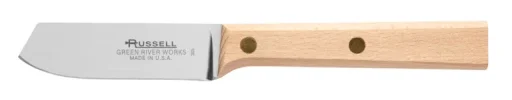

I like Russell Green River Knives. I just ordered one of these! Thanks for the info!HJE listed the Russell rope knife as Stainless steel, but the spine of the blade sure didn't look like Stainless steel to me, so I dripped a bit of cold bluing on the blade and it turned black instantly.
This thing is definitely carbon steel I figured I'd just live with the SS blade when I ordered it, but I'm definitely happy that it's carbon steel.
It's about 2.5mm thick with a full flat grind so it's nice and thin , but not too thin and is still good and stiff.
I think this blade has a lot of potential.
I don't know exactly where I'll go with it, but for now I just rounded the end of the handle off.
Looks Great!I decided to turn it into a spear point and I rehandled it in some walnut.
I just winged it so I'm not sure how I feel about it yet, but if I'm not happy it's still a functional knife and I can always order another one.
I actually really liked the factory blade profile, it just didn't look that great with this handle.
It ended up looking like a jumbo version of the old hickory folder Ontario had come out with a few years ago.
