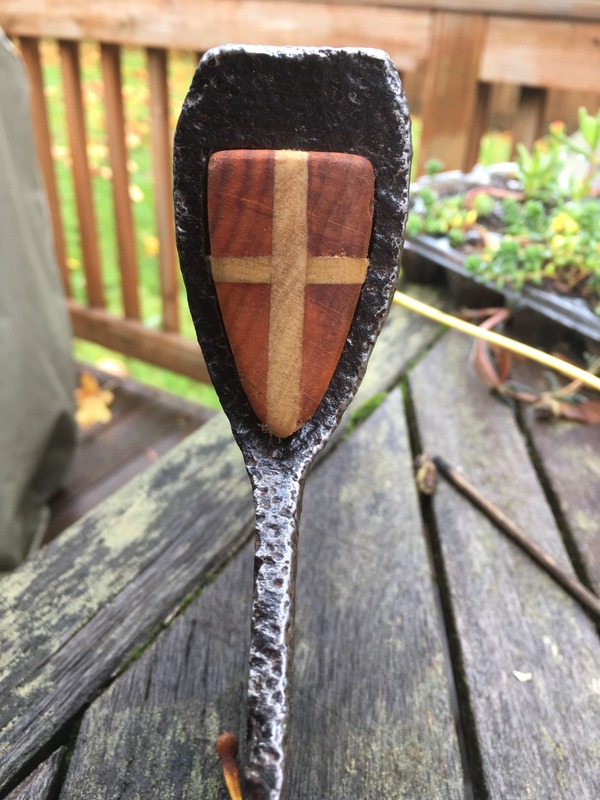

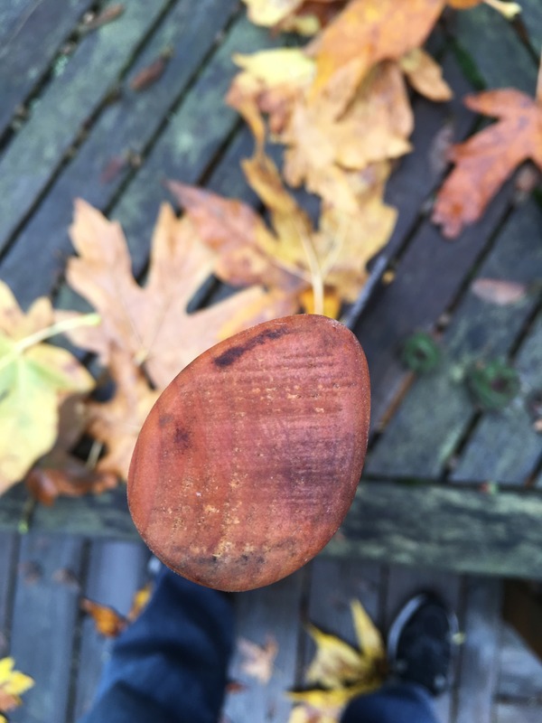

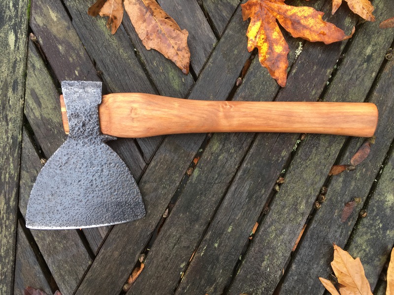

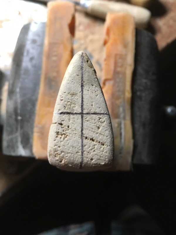

Just finished a Russian hatchet and I didn’t really want to post this many pictures in the “What did you hang today” thread (seemed excessive).
I think the pattern is interesting in comparison to classic American axes. They are kind of general purpose I suppose but they remove wood from stuff pretty well if they are sharp. Something different at least.
Happy with how it turned out.
Russian топор (Topor) from Latvia, 14inches overall.

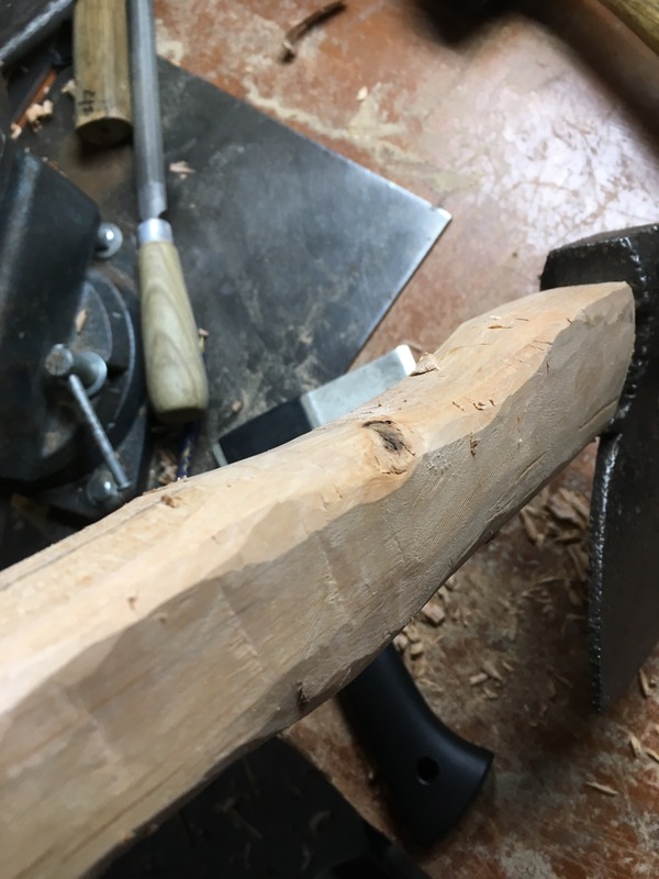

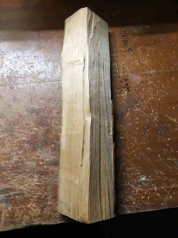

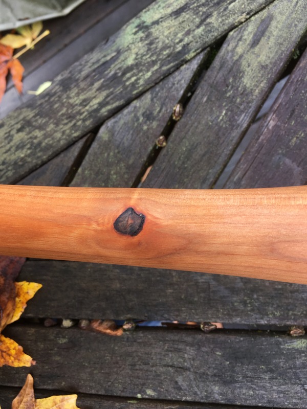

A piece of Birch – to burn or not?
Not.

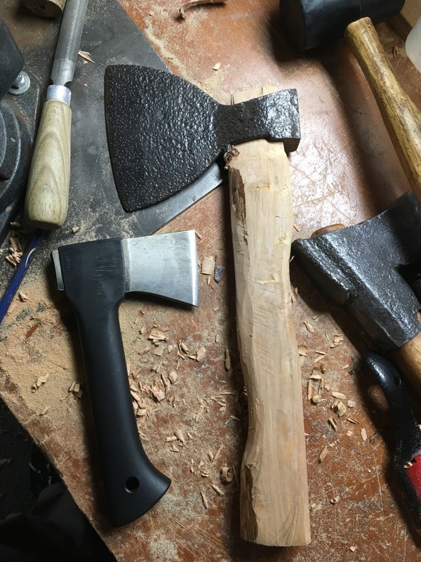

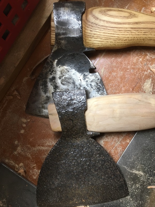

Slightly larger one behind it.
Knot a problem lol
I guess I like them.
Lovely work! Would love to get my hands on one or three myself one of these days.
I think I speak for everyone here when I say that we just want to see an excessive amount of axe pictures, and don't care what thread they are in!!
nice job. lots of personality on those

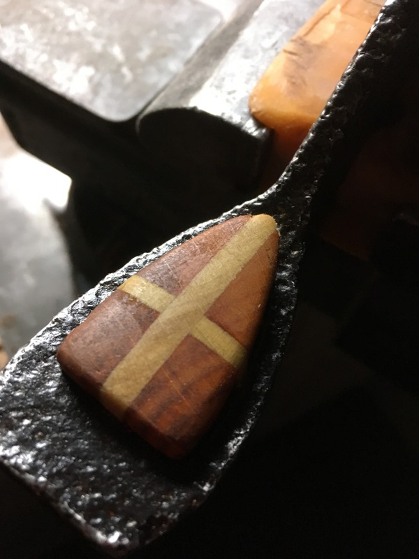

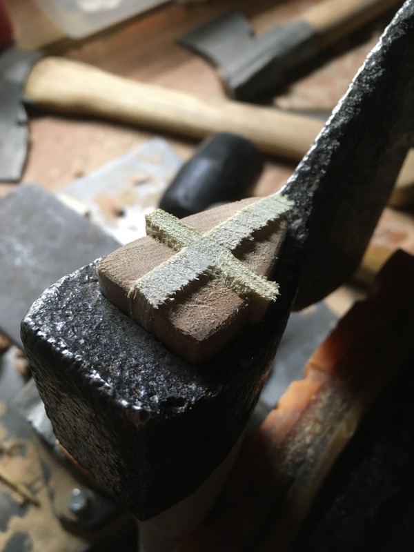

Nicely done, I like that the wood choice is something that would have been used traditionally on this style axe. Also a really nice job with the cross wedge!
Great job,Agent_H,i think you've interpreted the hang and the general sense of the tool Very correctly.

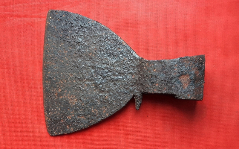

P.S. Hope that it's ok-i borrowed one of your photos to ask some more experienced people if they could id this axe more precisely.
Nowadays,one's automatic attribution of the above would be a "sapper" axe,one of the common army tools for both of the World Wars.
I,however,don't go for that,as well as believe that not only thi particular axe,but more importantly it's Type,is quite a bit older.

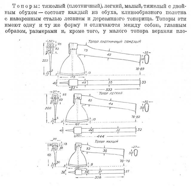

So far,i can only find an illustration from an old carpentry book(the book itself nobody can identify,alas).Not being able to post photos,here's a link to a forum where it's mentioned:http://rusknife.com/topic/15766-чертежи-схемы-клейма-топоров/page-3, Post# 72.
There,the axes shown are described only as the laerger/heavier,and the lesser/lighter Carpenter axes,the heavier one being said to have a "double"(thickness)-poll.That,i believe,is what you have....
Agent great job, the cross wedge looks fantastic and pulls it all together. Also I'm a big fan of knots.
First, thank you for the kind words on the axe! – appreciate the feedback.
I enjoyed the challenge of figuring out what it was supposed to look like, making it, and essentially learning a bit in the process.
really cool old axe. Not at all what I expected when you started to hang it.
Me either Bigfattyt. That was actually the point when I stopped and reminded myself that it shouldn’t look like a “conventional” curved handle. I made that mistake on the last one and had to compromise some to get it to straighten out.
now i need one
They are interesting for sure. I think we all need one as much as I needed one lol.
Jake, thank you for taking interest and helping us find out more about the pattern. Is the cut-out on the blade a nail-puller of sorts?
*Is this the reference from rusknife you where describing? The poster mentions he thinks is it pre-war.
Thank you,Agent _H,that is the chart.They're all labelled as "carpenter's" axes,and from top to bottom as "heavy',"light",and "small".
It's not easy to call the vintage of the book itself;it's written using the modern alphabet( so after the soviet alphabet reforms of the 20-ies),but could also be a re-print of an older text.
Actually,looking at the drawings now,i'm seeing yours as the bottom,the small axe,judging by the poll-sides of an eye proportion.
I've no idea about that notch/indent....A number of discussions has been held on that subject(not unlike the "spur"...),and no clear consensus ever gets reached...

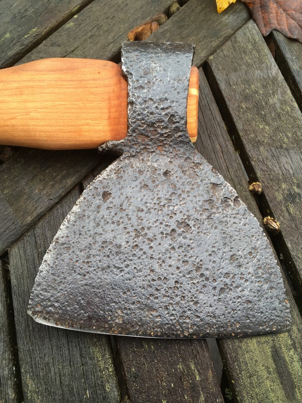

What i CAN say about yours,as a smith and an avid observer of axes,is that it was forged without cutting corners.A heavier poll like that is not easy to isolate,it really complicates a forging process vs simply bending an evenly-thick stock about a mandrel.
In one of the photos above it looks like a significant width of the steel edge remains,and that it's most probably been "overlaid"(vs an inserted bit).
Overall,it doesn't have the look of the slap-dash soviet products,but looks competently and harmoniously designed and skillfully forged.(So my vote would be that it dates back to the late 1900's).
Possibly,if the dimentions fit closely one of the axes on the chart,the overall length can tell you the amount of wear....But it actually looks hardly worn,if at all.
Axes like this were sometimes used as a single-edged tool,too,it just depended on the owner...But the bevels on yours also speak of little,if any,wear...
Well done. Very impressive job of cross wedging, and making all that look pretty too!

One thing I was curious about was the shape of the eye in a tonop head. It is not explicit in the drawing posted from the rusknife site (in post #15). Straight, Taper (which way), hourglass?
BTW, excellent workmanship on the cross wedge.
Bob
EDIT to add:
Found this drawing on page one post #5 in the rusknife site thread posted:
In the bottom right view the eye looks tapered bottom (larger) to top (smaller). While the top view seems to indicate straight.
