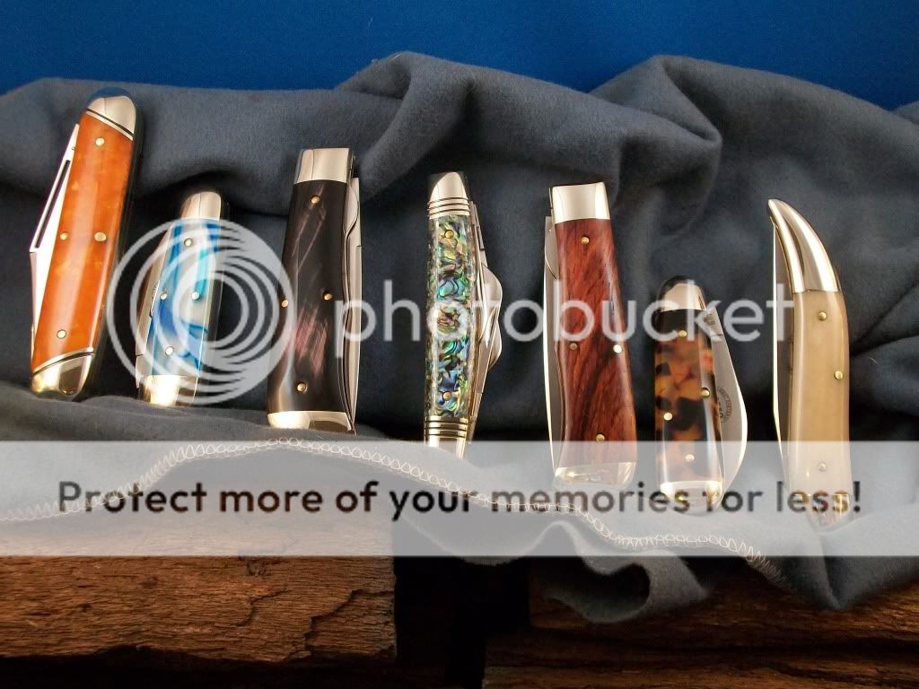

orange crush,polor ice,red buffalo,abalone,rosewood,tortoiseshell, & smooth bone . all gec personally i like a mixture of syns & naturals with a slight perferance towards bone & stag. how about you guys? do you also think some syns are great looking.?
