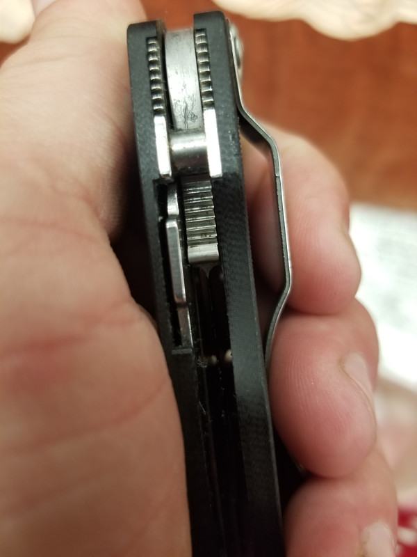

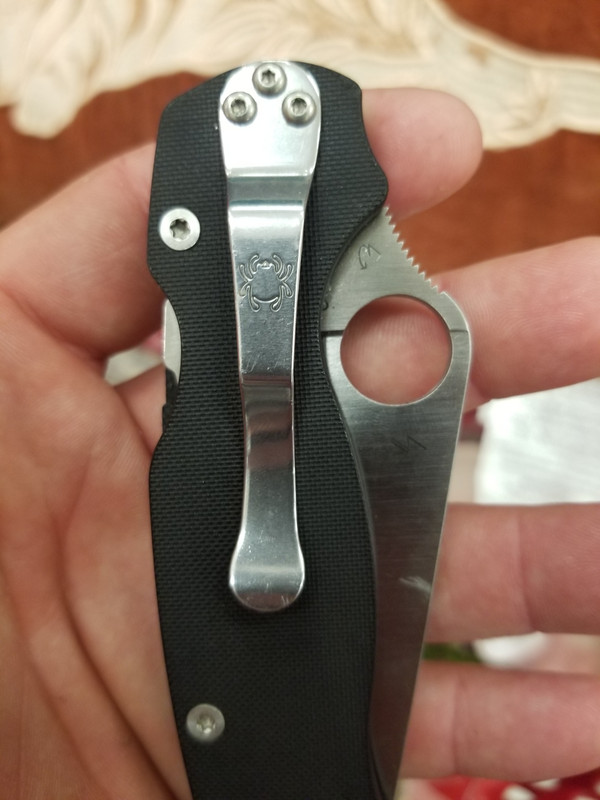

When I read your initial description I was wondering the same thing. I'm slightly embarrassed to admit to how many PM2's I have owned, but it's enough for me to say with as many issues as you're claiming, I would almost bet money that it's not genuine. I've seen PM2 lemons, but never one that had THAT many flaws. If you throw up some pictures, guys will likely be able to say with more certainty. Specifically the off-set dimples on the steel liners, the thumb ramp jimping, the scales, and the logo.

To me, the stripped screws/ holes is a red flag; indicates someone’s owned/ played with it previously.
Shouldn’t be that way factory new.

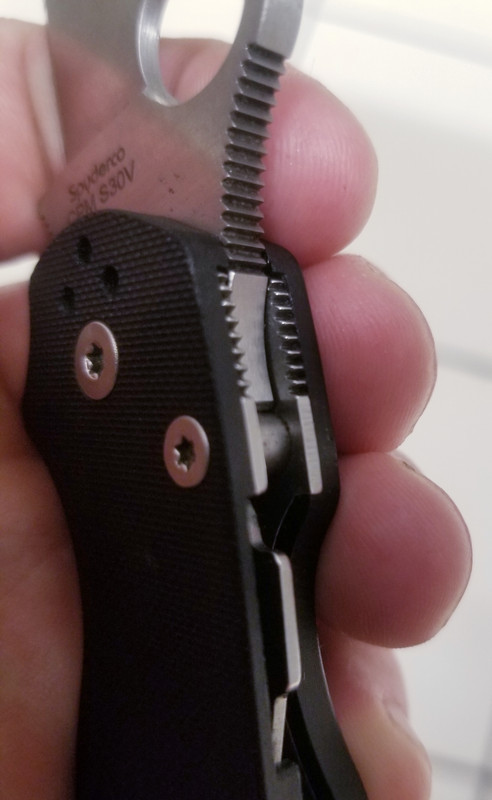

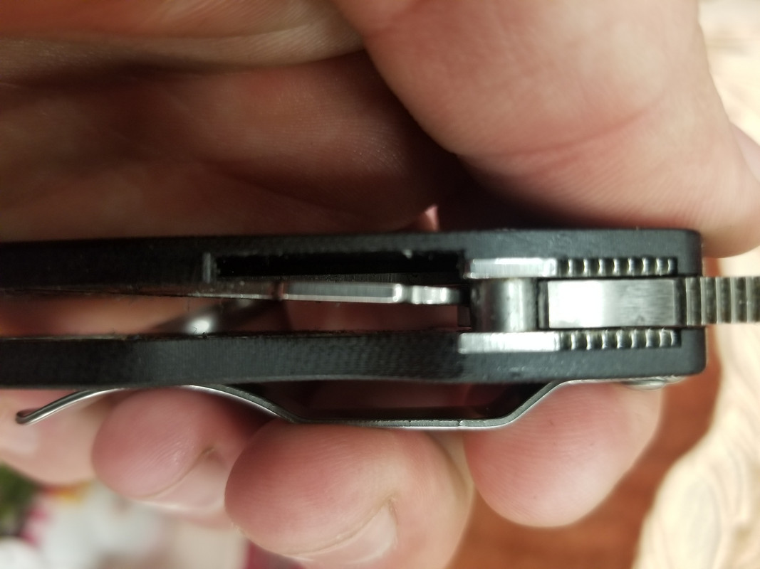

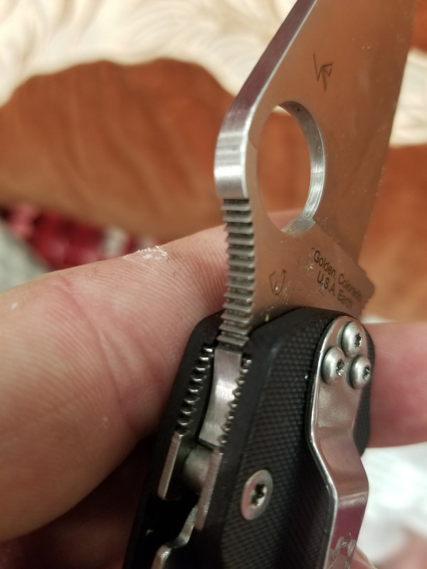

Pictures incoming. This will be a slow process. Let me know what exactly you all need to see
What’s the 2 letter code on the end of the box?
I’ll defer to the identification experts on your pics but the issues you describe strongly point to a counterfeit.
S30V isn’t a good steel for fine edges (usually) but the overall knife build issues aren’t what you usually see of a PM2.
I am certainly not an expert, but I don't see anything that screams knockoff. The last thing I would check is the dimples on the steel liners, the fakes will often have them, but on the genuine PM2's they are off set from each other (at least I have never seen a fake that has them offset). It's hard to get in a photo if the knife isn't disassembled, so just check yourself and let us know. I'm not a S30V guy, but it isn't known for dulling quickly. Chips, yes. Poor edge retention, no.

Looks like all four of mine do. Mine all have a bit of side to side slop, and the S30V does indeed chip even under what I consider normal use.
It would send it in to address the stripped clip screws.

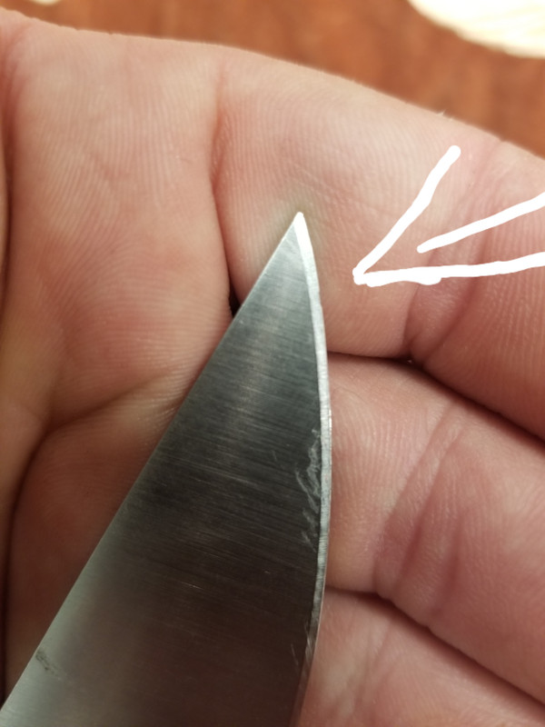

Have you sharpened it yet? I see the blunted spot you are talking about.
I do see what appears to be tape goo on the blade.
One thing I have found in my limited Spyderco experience, is that they often have a wickedly sharp edge, with a bit of a bur/wire edge that will feel super sharp, but fold from side to side easily until the edge is re-sharpened I've had this on a usa made delica.
I'm not an expert on sporting fakes, but it looks legit to me.
Likely some one messed it up, and returned it.

It's not blunted, it chipped. My phone doesn't take great pictures, haha.
I haven't really sharpened it yet. Only stropping and ceramic touch ups. Going to take it to the stone tonight, if the kiddo goes to bed early enough.
