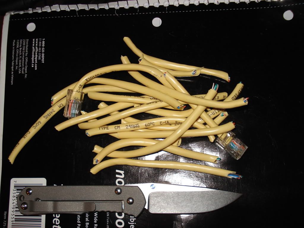

After reading some of this post I was wondering how good my sebbie's s30v is so I cut up this phone cord real quick and it was still sharp enough to shave with after it was done...
Which isn't the best test but it's not bad.
Now I'm going to go strop it and keep edcing it.
