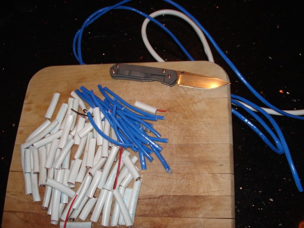

Well after hearing that guy's edge rolled cutting a wire(which I think it did) I decided to see if that was a isolated incident or if all sebbies are as bad as some people are saying and here's waht happened.
You can't tell from the picture but that's alot of wire cut up atleast a few feet...
The blue is cat 5 and the white is coax...
It had no rolling and was still shave sharp after I got tired and stopped cutting all the wires.
I'm very pleased with the sebenza's performance...
As opposed to my ritter mini grip which had rolling after extremely light use...
But after I resharpenned it and stroped it the ritter mini grip became my favorite...
Until I got the sebbie that is.
They're both great knives but if I had to choose(price not being a factor) I would take the sebbie any day of the week.

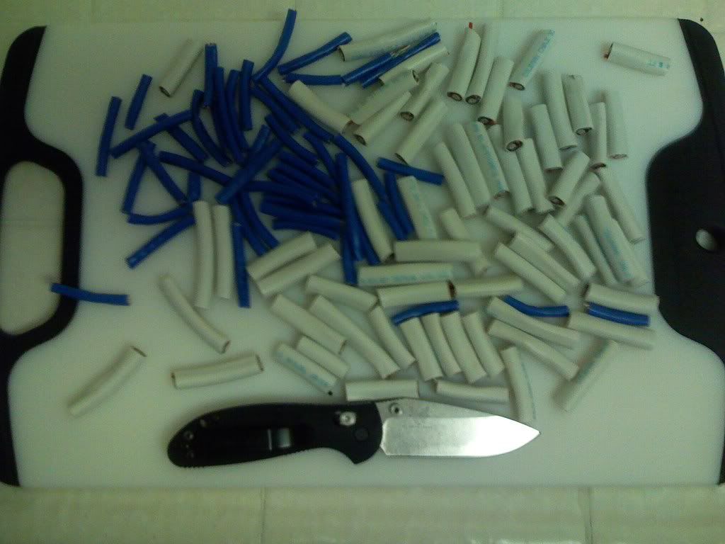

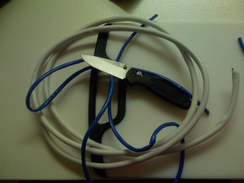

I tried this same experiment today with a g10 delica and a mini ritter when I ran into some problems.
After one single cut through the coax with the mini ritter it glided through but there was a very small chip in the blade.
And I dont want to ruin the knife so I stopped.
I had trouble trying to take a picture of it with my iphone because it's a small chip.
And the delica has to be retried when I have some work gloves because the hump started hurted my hand while trying to make the first cut through the coax.
I will let you guys know when I complete this.
I might work up the courage to just go all out and mess the ritter up.
Allright I did it!
And here are the pics
Sorry for the quality they were taken with a iphone.
The ritter did much better than I thought it would!
Although it chipped and the mini sebenza didn't...
The mini ritter seemed to cut a little better than the mini benza.
I have to say I'm impressed with the mini ritter.
It suffered a few chips but it could still shave.
And the chips which I will try to take a picture of when my girl gets home with the digital camera.
And if you don't mind sharpening that's really only a minor problem.
I'm sure I could have cut ten times that much if I had the patience and a pair of gloves.
I already got a big blister doing it.
IMO although the small sebenza wins without a doubt becuase it sustained no visible damage the mini ritter is much cheaper and if you not how to sharpen the chipping is a minor problem.
Althought they both use s30v there seems to be a difference between the two.

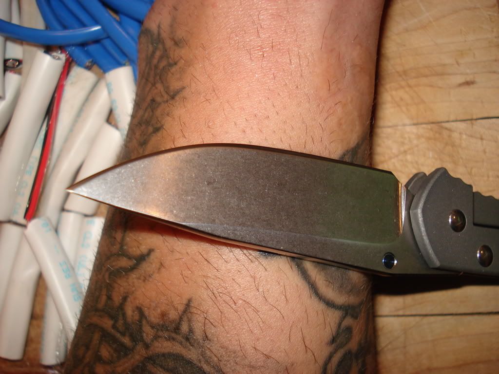

I counted around 20 small chips on the blade.
On second thought this knife got smashed by the small sebenza in terms of durability.
But the mini ritter seemed to cut slightly better.
So draw your own conclusion.
