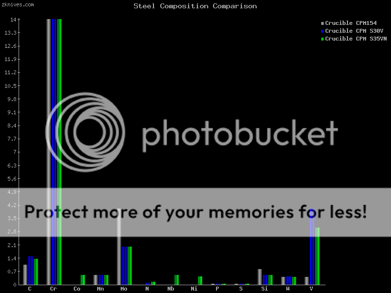

Here is a graph that shows the composition of the steels CPM-154/RWL34 (these two are very similar, only real difference from what I understand is the small variations in Vanadium), CPM-S30V and CPM-S35VN.
Lets go over the main differences.
Molybdenum (Mo)
: A carbide former, prevents brittleness & maintains the steel's strength at high temperatures. Improves machinability and resistance to corrosion. Present in many steels, and air-hardening steels (e.g. A2, ATS-34) always have 1% or more Molybdenum.
Nitrogen (N)
- Nitrogen acts very similar to Carbon in the alloy. N substitutes C in small amounts(or even large, with modern technologies), for hardness. Obviously, Nitrogen forms Nitrides, not Carbides. INFI has N, and there's few more, with Sandvik being the champion having 3% N in the alloy, completely substituting C. Sadly, not available for knife makers. Because Nitrogen is less prone to form Chromium nitrides than Carbon is to form Chromium carbides, its presence improves corrosion resistance, leaving more free Chromium in the alloy. Since Nitrogen is less reactive in forming Nitrides, it can be used for added hardness without increasing carbide size and volume, e.g. Sandvik 14C28N steel.
Niobium (Nb)
- Niobium is a strong carbide former and forms very hard, very small, simple carbides[NbC]. Improves ductility, hardness, wear and corrosion resistance. Also, refines grain. Also known as Columbium.
Nickel (Ni)
- Adds toughness. Present in L6 and AUS6 and AUS8. Nickel is widely believed to play a role in corrosion resistance as well, but this is probably incorrect. One more reason Ni is added to the alloy is that it creates brighter portion in damascus steels.
Vanadium (V)
- Contributes to wear resistance and hardenability, and as a carbide former (in fact, vanadium carbides are the hardest carbides) it contributes to wear resistance. It also refines the grain of the steel, which contributes to toughness and allows the blade to take a very sharp edge. A number of steels have vanadium, but M2, Vascowear, and CPM 10V, S90V, S125V (in order of increasing amounts) have high amounts of vanadium.
Resource used is Zknives.com if you are interested.
I do feel that RWL-34/CPM-154 and CPM-S35VN are focused on offering a balance for the maker and user. There are more then likely other steels also out there from makers such as Duratech, Bohler and Carpenter that seem to be very similar but I am to lazy to search for them now :)
