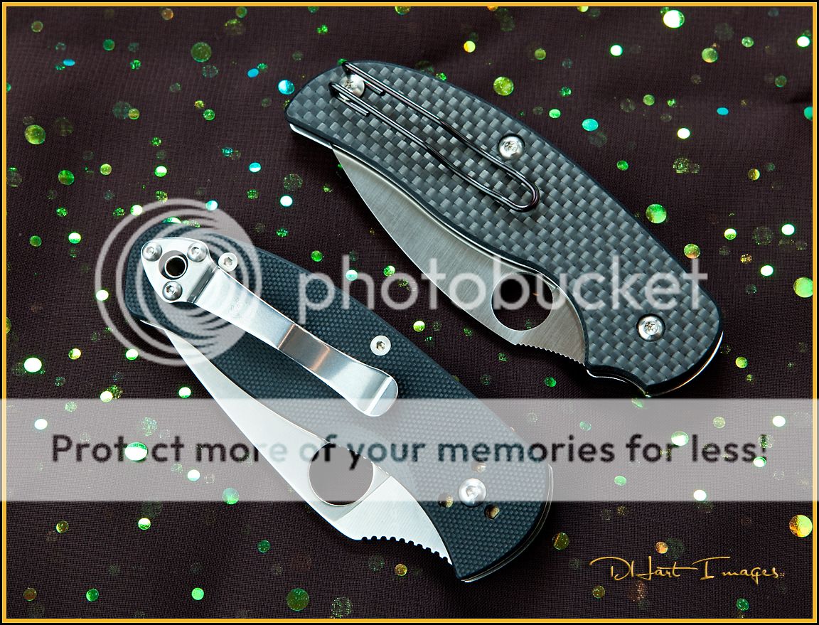

I recently purchased a Sage 1 and a Persistence. Much has been said about these two knives individually. Interestingly, I find that they are so close
to one another in size and shape that a comparison seemed appropriate.
Here's a quick rundown on the specs, as I measured them today:
Knife......... Cost..Blade...Weight...Closed...Open....Lock...Scales...Steel
Persistence..$25...2.8".....3.7 oz.....4.25"......6.8"....Liner....G10...8Cr13MoV
Sage 1........$80...3.0".....3.2 oz.....4.13"......7.12"....Liner....CF........S30V
The G10 scales on the Persistence are less elegant looking than the carbon fiber scales on the Sage, but a bit "grippier" in the hand.
The attachment screws on the Sage are torx head whereas those on the Persistence are hex. (The Persistence hex heads are metric, I believe, as my closest USA hex wrench was not quite a perfect fit.)

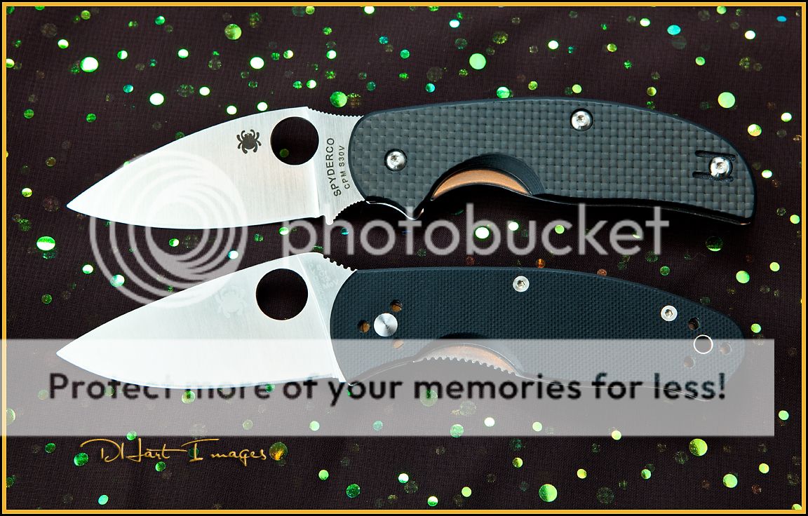

I removed the blade and phosphor bronze washers from the Persistence to do a fluff n buff. I expected to find two washers, but to my surprise, I found SIX!
Overall length of the closed knives is practically identical.
(EDIT: sorry about the busy-ness of the background... in hindsight I would have chosen something much simpler... but these are done now, so be it.)
The black wire pocket clip on the Sage allows deeper pocket carry by about 1/2" and is less obtrusive visually.
The stainless clip on the Persistence is extremely strong... too much so in my view.
The Persistence allows the clip to be placed for tip-up, tip-down, left-hand, or right-hand positioning.
The Sage allows only tip-up, right-hand or left-hand. I prefer right-hand tip-up, so this is a non-issue for me.

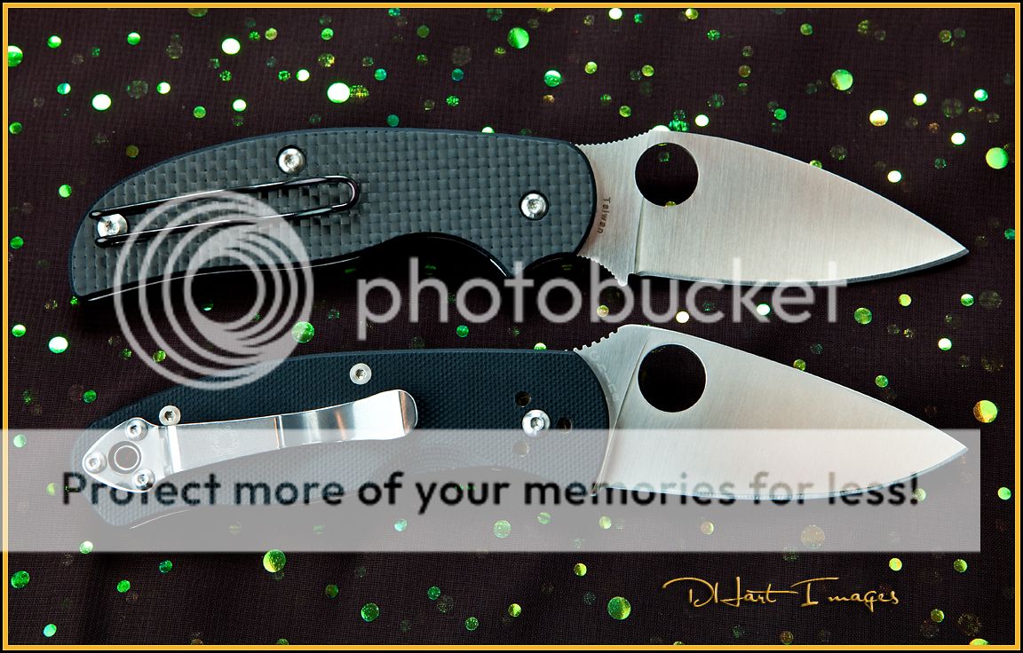

The blade length and shape are quite similar. Overall length open is virtually the same.
Note the cutting edge of the Persistence blade comes fully back to the handle.... you can choke up
wonderfully close to the cutting edge and still have your hand comfortable and fully on the handle.

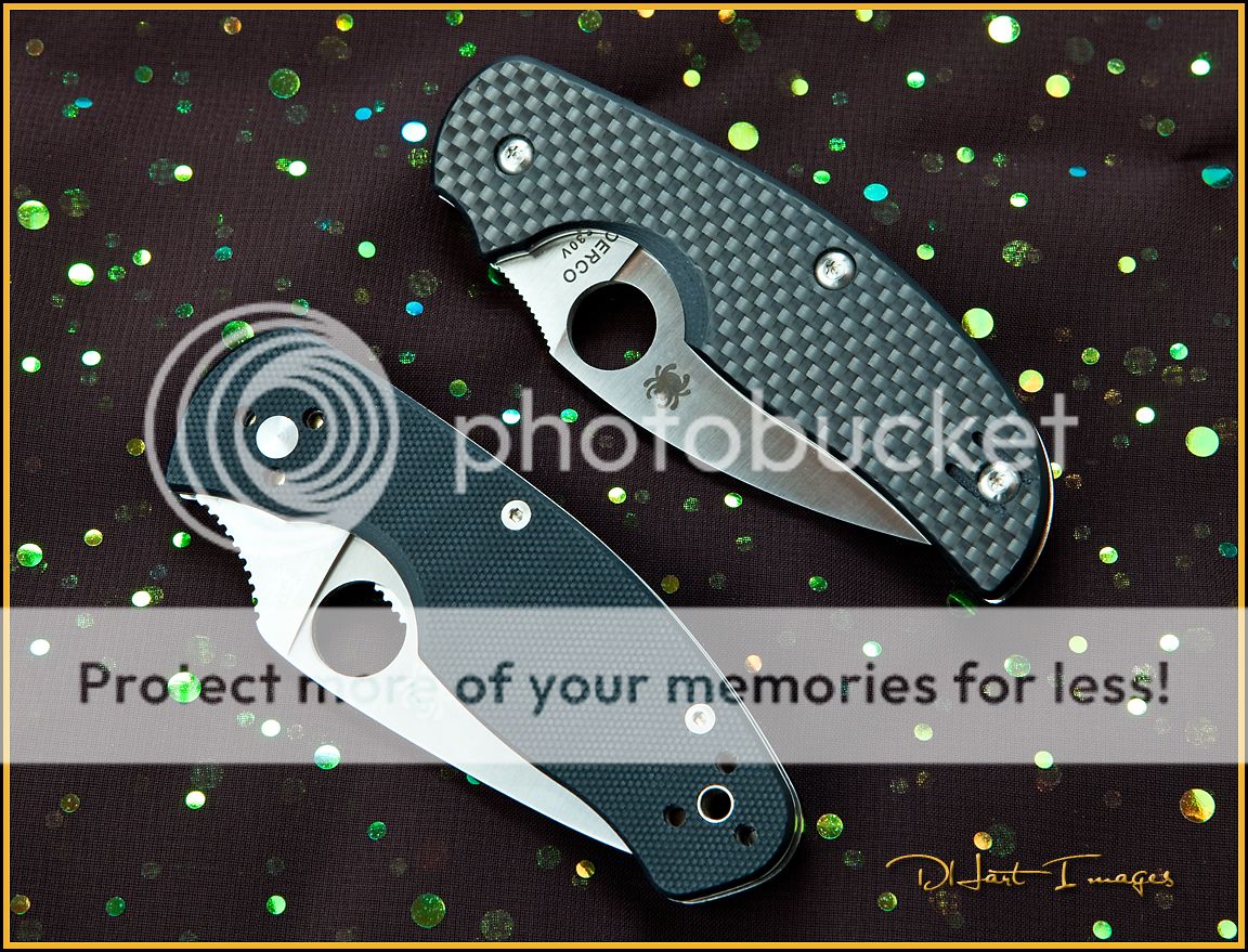

The way the Persistence fits in the hand, for me, is about perfect. The handle is just right. There is no extra handle
hanging out the back of my hand and one can get right up to the cutting edge, without going forward of the grip,
as is necessary with the Sage if you want to grip closer to the cutting edge.
There's just one way to hold the Persistence - fully on the grip itself - and I really like this!
The Persistence offers a lanyard hole. A lanyard hole is not available on the Sage.

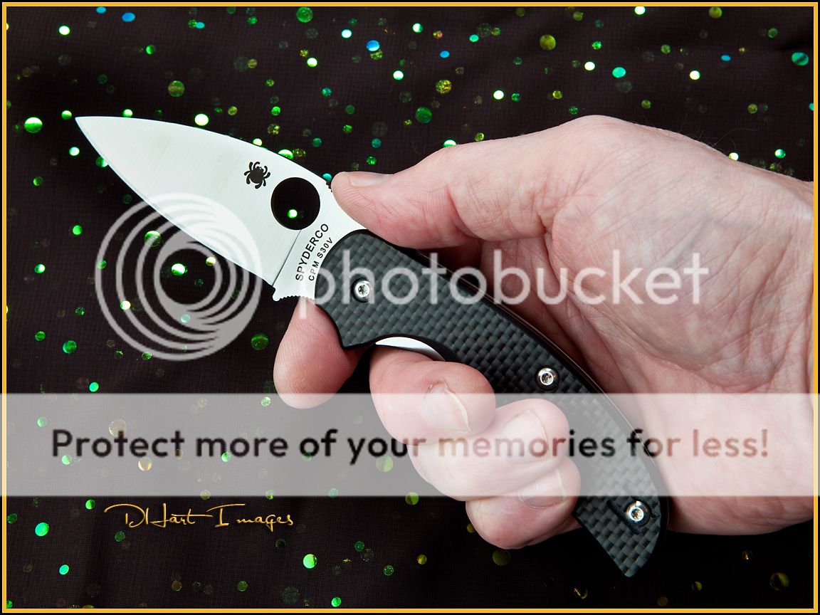

With the Sage, the best grip is obtained by moving the first finger up into the choil area, which leaves a bit of grip hanging out
the bottom of my hand. Not a problem, really, just an observation. Of course, you can also hold the Sage with the hand farther
back, entirely on the grip area, extending the blade farther out from the hand if desired... though the feel in the hand this way,
to me, is not so comfortable.

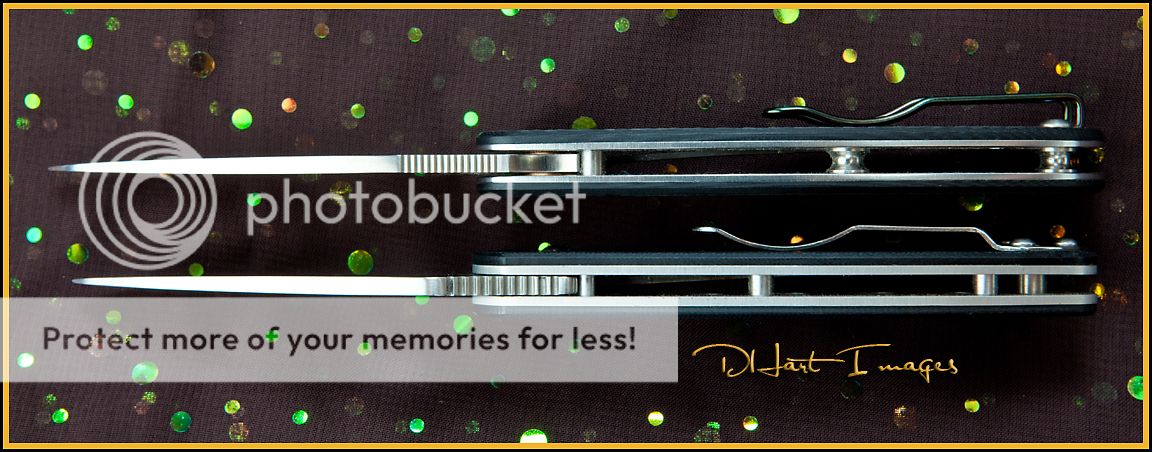

This shows the difference in thickness of the liners. The thin Sage liners help achieve the Sage's lighter weight.
The thicker liners of the Persistence give a somewhat "beefier" feel and, I suppose, it could easily be argued that
the liner lock on the Persistence may be more durable, stronger, and possibly longer lasting.
The additional polishing given to the Sage's liner is apparent here:
