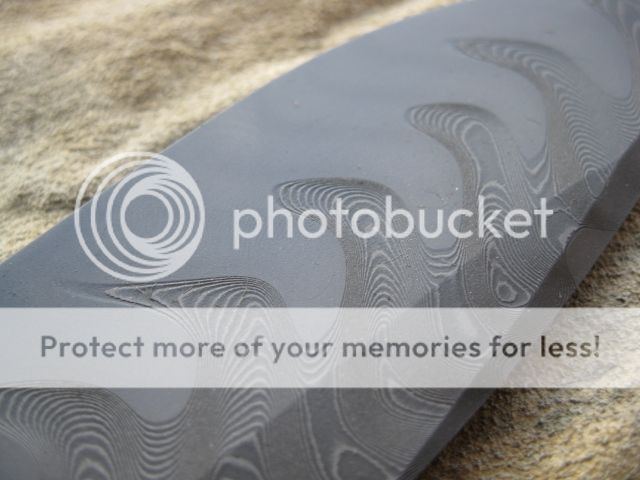

I do agree with STeven about the blade however. The transition line looks terrible and it looks like the patterned steel (which is assumed to be softer) goes right to the edge in one place?

The edge is stelite, so technically that is softer than the jacket material, which is all blade quality stainless...
It doesn't bother me to have a post like yours , sir. Not everything does it for everyone, no one needs anything in this forum so there is a certain level of emotion attached to everything here. I just find it a shame that every time I post in this forum, there is one person that alway speaks negatively to the laminate materials that I use....

I think what your getting is that it is considered a flaw when a temper line or a lamination line touch or come very close to a cutting edge
Maybe not so much when dealing with lamination lines but please don't be offended when people offer constructive criticism

I think that the operative word here is Stellite.....how many times has anyone seen it laminated, let alone with stainless Damascus? My edc blades are either Stellite or cast Colbalt and, IMHO, makes for a viable blade and smacks of the exotic....something different and out-of-the-box, kinda like Les. ;)
I give Chad kudos for even pulling this thing off, no matter where the weld line ends up.... :)
I remember Steve Schwazer beating on a piece of Stellite trying to forge a blade and I seem to remember it took several days to draw the stock out and finally got to grind it....only made one, ever. Grinding it is one thing, forging/welding it, especially to a dis-similar ferrous metal is a completely different animal to my notion.
I know that Chad worked a looooong time and ruined a lot of material figuring it out, same as his Mokuti....a small fortune. Neat stuff to my notion and this just makes me want to remind Chad he was gonna make me some. :D

Apparently it DOES bother you or why post about it? Actually there are TWO people that think the transition line doesn't look so good.
But those are merely opinions...NOT a personal insult to your knife. The engraving is exceptional!

I didn't even think Stellite could be welded to a carbon based steel! A feat in itself!
Hi.
I am not nearly knowledgeble enough to understand all that was involved in making this knife, but can you explain the purpose of having a core which is exposed at the edge and which is softer than the outer clad?
Thanks!!!
Stellite is not very hard, but it's very abrasive resistant as well as being virtually corrosion proof. As I understand the chemistry it's cobalt based as opposed to being iron based like steel is.
It's a specialized material, not suitable for every use, but if you wanted to say, cut card board. Your arm would give up before the edge did.
My wife has a stellite knife that she uses in the kitchen, according to her it doesn't stay supper sharp very long, but it stays "good and sharp" for a very long time.
I used it in this piece for visual contrast, the process of etching the Damascus to show the pattern has no effect on it so it stays bright.
Contrast to this blade where the edge is 3v (also by Chad Nichols), this edge should be about 47% tougher than woodpecker lips.
Pardon the dirty blade...
I remember going to dinner with several people at Blade Show West. Chad told us he had spent lots of money but was not successful with the 6K san mai. I described to Chad how I would do the 6K san mai. My information was based on working with Rob Simonich laminating Talonite to titanium. I encouraged Chad to keep going. We took Chad to dinner again the next day after the show and I further encouraged him to keep trying. A few months later he was selling the material and he thanked me for my help.
More than a year later Chad calls and says, in so many words, he is going to knock off Timascus™. I told him, "Do not use our patented process and don't catch yourself on fire." I seriously doubt Chad spent more time and/or money knocking off Timascus™ than we did developing it. It definitely is not worth a pity party. :rolleyes:
BTW, the material Steve Schwazer forged was Talonite (Stellite 6BH). Kit Carson finished the knife after Steve forged it.
