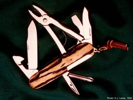

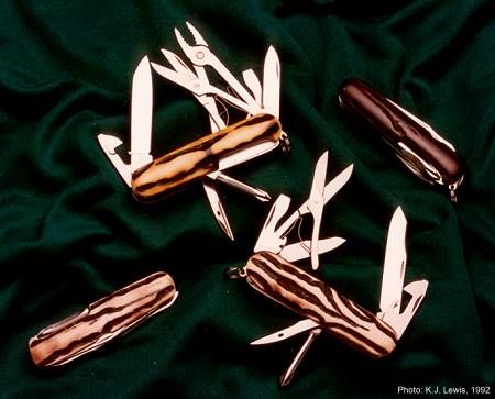

Here are a couple of pics of some modified SAKs - not just the handles but some mods on the tools too:
There were done by KJ Lewis a while back -
he's the one who customized my EDC Victorinox Scientist:
my daily carry for 19 years.......
unfortunately he no longer does this kind of work.
Please come back and show us a pic of your modification?

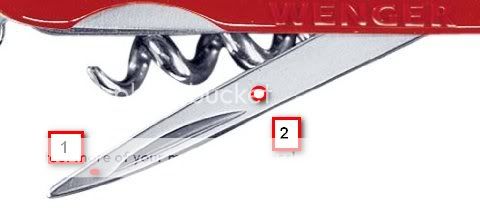

UNBELIEVABLE!!! SAK Quality....
Both nailfiles can actually stand even further out - but this is approx where they will naturally "snap shut" :eek: (cough, cough, splutter!) -
this was only from fanning open all the tools to pose for photographs - so did not last long
Hopefully these may be just a bad batch (although I have two Wengers and a single SwissBuck made by Wenger, and I dare not try any more Wengers to find out) - and with the new ownership perhaps these can be regarded as an anomaly.
