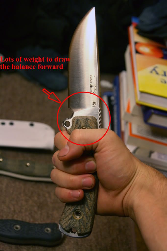

I can't say for the SAR3, 6 or 8, though I'd be curious about the sar3 given how tiny it is. I can give an opinion on the SAR4:
Yes the SAR4's pommel is HUGE and it has a ton of weight in the handle. However, it has a lot of metal and handle slab in the ricasso area forward of the index finger. When you are in the choked up grip as shown in the image, it doesn't feel nearly as off balanced as the SAR5, where, when in the choked up grip, all of the full thickness metal and all of the handle slab is to the rear of your index finger. On the sar4 when the knife feels like it's going to slip backwards in your hand it is immediately bolstered by the gaurd. It feels safe. The sar5 doesn't in my hand.

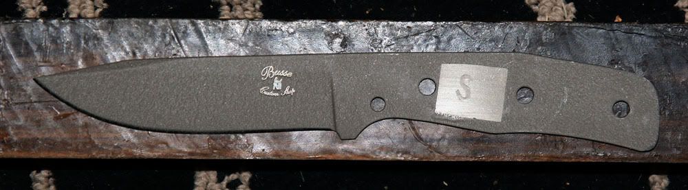

The knife pictured has been heavily modified by the custom shop, and I have taken 1/2" off the pommel from that initial modification. It is in no way a representation of the sar5's original handle.
Though this is not the particular SAR5 I started out with before sending it to the custom shop, this is what all factory SAR5's look like:
This is what it looked like after the custom shop flattened the back of the pommel (reducing size and rearward weight) and contoured the finger swell (reducing size and rearward weight).
This is where I cut off 1/2" from the pommel, reducing rearward weight even more.
This is the final shape and scales seen in the pictures you posted. It feels nothing like the original knife, the balance point is at the index finger rather then at the ring finger when choked up. It's palm swell is located at the center of my palm when choked up, instead of at my pinky's metacarpel.

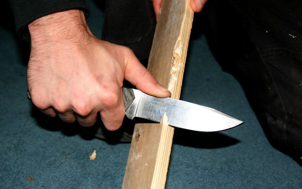

If you grip the unmodified sar5 so that your palm is centered on the palm swell and squeeze it for strength, you get a grip roughly like this (same grip as shown in the very first picture)
where for control you want your grip to be closer to your work, something akin to this
When I choke up on a knife for control, I want a full set of scales instead of a squared off peice of metal. I'd still prefer scales over even the nuclear meltdown treatment because it gives more hand more material to grip on, reducing the amount of fatigue over a long period of use.

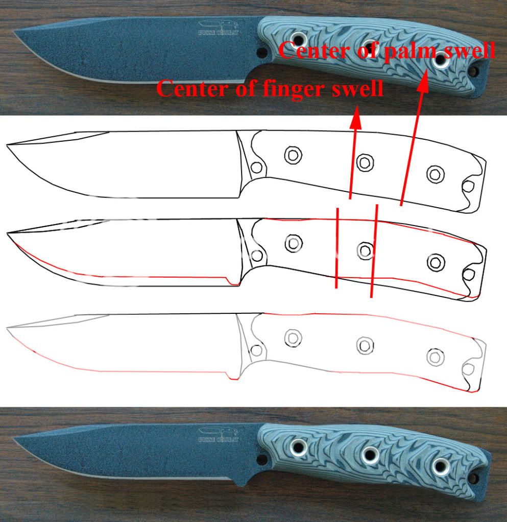

This is the drawing (minus the text/lines I just added) I sent to garth to have my sar5 modified as seen in the pictures I posted. The second line drawing shows a correct anatomical spacing of finger arch and palm arch when in a chocked up grip, about 1/2" apart. The first lined drawing shows the too-far-apart spacing, in order to center you palms arch around the palm swell you have to use a choked back hand position like the one shown in my last post, putting an inch between your index finger and the edge. The bottom image is a photoshopped version of the top image, it does not exist in real life..

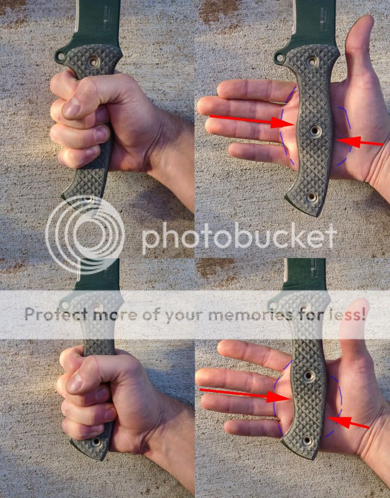

This is an example of a good placement between finger swell and palm swell. You can see that when I make a closed fist, the finger swell matches the center of my finger arch, and the palm swell matches the center of my palm arch. But if I choke down, now both swells are putting pressure solely on my index finger and index metacarpel, the curves no longer match up. When you offset the fingerswell and the palm swell to much like on the SAR5, the palm swell is sitting right on top of you pinky metacarpel in a choked up position.:
While spacing of the two swells can create problems of grip position and comfort when choked up (one of the reasons I never liked the active duty handles), the radius of the swell can also cause problems where it is putting too much pressure on the finger bones or the metacarpels/tendons/artery system of the palm.

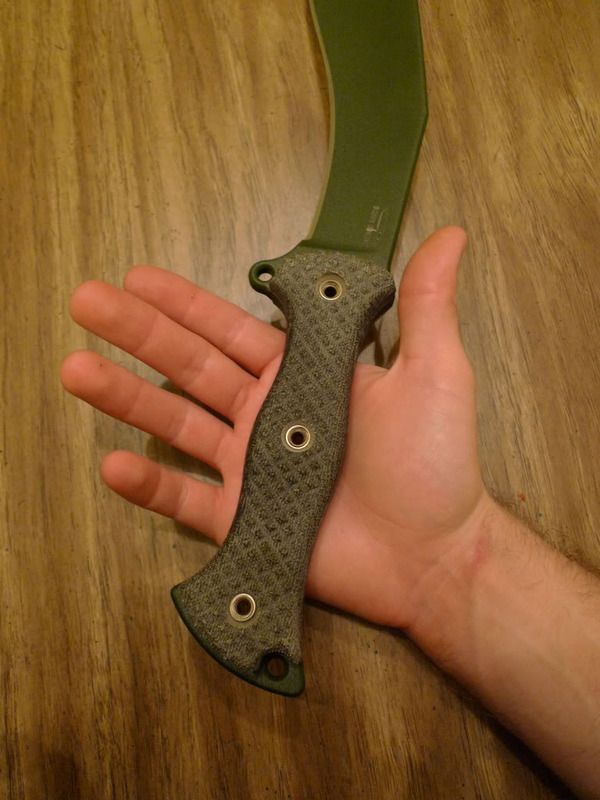

These swells were too severe for my hand, I found that they hurt my finger bones and metacarpels when gripping it hard:
Where this handle has a longer radius for the finger swell, and a very long radius for the palm swell. When I grip this, it is a much more natural match up for the radius of the arch of my fingers and palm.
This can be a problem because of the bloodflow system to the hand. Note the curvature in the drawing of the fingers and where the center of it lines up with the center of the superficial palmar arch. They are about 1/2" or less apart.

Things I'm not saying:
-All handles have to be exactly like my sar5 in order to feel right in the hand
-Any handle that strays from the 1/2" seperation of finger and palm swell will feel terrible in every single hand that tries it
-All hands are identical in size
-All people experience a given item in an identical manner
Yes some people have larger hands, and yes some people will love handles that I hate. As far as swells that are too-severe, having a higher degree of hand musculature and thickening of palm skin helps to reduce the feeling of the swell pressing into your bones. The less muscle/calousing you have the more your going to feel a severe palm swell. This is what I'd call a variable design problem, your trying to fit as many hands as possible, some people will have an anatomy that does well with it and some won't.
But with finger to palm spacing, I would consider that a static problem that is there regardless of the persons musculature or thickness of skin. It is hand geometry that simply doesn't change for normal human hands. Some people won't find it an issue, but the problem will still be there. The sar5 wants you to grip it farther back just like the image above of the pumpkin orange and green sar5 because the palm curve sits properly in the palm in that position.
Sure, if you have hands the size of Bigfoot Silva your hand might cover the distance and have your finger press right up against the edge when your palm is centered on the palm swell of the SAR5 - but that would put you in a very, very small minority of humanity.
