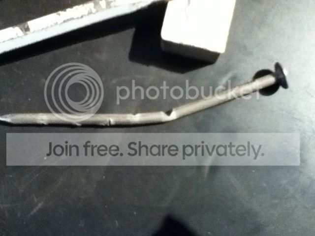

See bellow :
Granted I didn’t sharpen the chisels special for this test. They looked perfectly usable; sharp enough; no dings in the edges. I can’t say that for the way they tend to be when brand new out of the factory packaging but that is a rant for another time.
I put the block of aluminum on a stump that I have sitting on the floor in the shop. I set up the nail across it and with the larger of the two chisels (shown in the photo) in place; I whompped it pretty good with the mini sledge. After two or three licks it shot across the floor and I thought I had cut it.
Nope.
just got off center and pinched out from under the edge.
I did that a few times in different places as you can see along the nail.
I was sure with the medium blows this would cut it but it didn’t.
I got the smaller, shallower edged, slightly sharper chisel and went again a couple of times.
Same exact result but the smaller chisel was kind of vibrating and flexing and feeling not quite up to the task.
Then I put the nail right on a square of steel that is welded to the end of a vertical leg of steam pipe that I mount vises on and had another go.
Same result; after two or three pretty heavy blows it cut part way; shot out from under; not cut through.
In the photo you can see some of the other tools I use to “carve” steel and other metal. The broken files and the triangular deburing tool and the swivel deburing tool. The rat tail file that I sharpened is at work along with duplicates of these others.
So . . . I am going to aim for a knife for carving (deburing) mild steel and give up the nail cutting.

JR88FAN,
you were RIGHT : stick to diagonal cutters.
