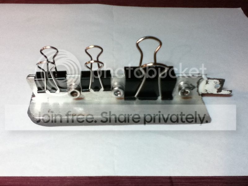

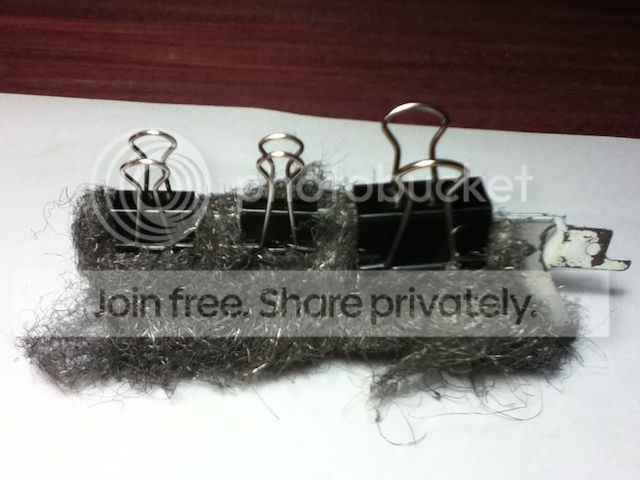

Here's the end effector I made for it out of a saw blade, some aluminum angle (back to back) and just a "hint" of closed cell foam padding. Don't laugh at the document clips they work super well and stay in place with very coarse steel wool and with wads of aluminum foil.
I have since gone with a narrower version than this one.

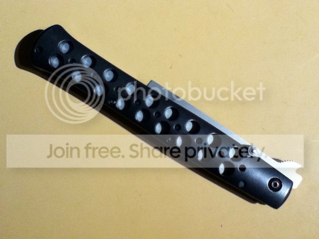

Pretty isn’t it ?

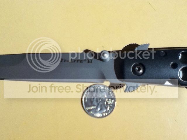

I found out from my Opinel #12 mod that I really like a knife with a huge handle and a fairly short blade. I can put lots of power into the blade but still have great control. The metal cutting / extreme use version I am going to make from the Ti Lite is the next step from the thin Opinel which is like a box knife that’s been on some buff up program.
Here where the left edge of the photo is cropped that is about where I am going to cut off this blade and turn it into a Razel sort of blade. I got to leave some taper on the spine there to tuck into the handle. I think I got that scoped but I am going to take it slow and see what I can learn. Any links to good discussion of the Razel edge design would be most appreciated.
Yup this is a long knife can it be longer than the Hold Out I ? I thought it wasn’t but it looks longer here. Won’t be for long though. I find tons of use for the Hold Out, at home, just as it is. For the Ti Lite ? Other than opening envelopes I have zero use for it with such a long blade. Around here, as an EDC at work, all it is going to do is get me in trouble with the law. So . . . soon it is going to be like three or three and a half inches blade length.

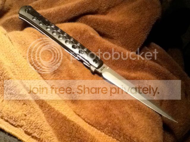

I opted to let go of my obsession with 3V, for now at least. People have said many steels if heat treated decently can be a mild steel cutter.
So
Here we are with CTS-XHP
Shaves nails with the factory grind; no problem. I haven’t hammered it through a nail. That I am going to take real easy and experiment with edge geometry until I get to where it isn’t getting dinged up before going for it. I won’t be cutting nails after that but I want that kind of edge durability for lots of other sorta similar daily cutting.
I dig the “sculpted” handle. I wish it came in Titanium . . . I wish I could get any knife in sculpted titanium for a $100. This 7075 aluminum should be pretty tuff. I believe I saw where it is forged not just machined so I know from actually taking components to failure aluminum made from some serious alloy and forged / heat treated is a whole monstrously different world from some sort of mild aluminum. Hugely different animal.
They call this coating Electric Discharge . . . looks like powder coat paint to me . . . does anybody know if this is something better than really durable paint ?

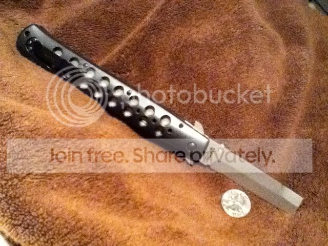

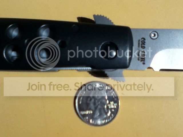

Step One
It begins
Remove everything that doesn't look like a Razel (and in the process make it legal length for my area).
A few minutes with a Dermal and an abrasive cut off wheel. Then a quick touch with a small grinding wheel to take off the rough and sharp edges. All but that one good one.
While I was at it I separated the blade from the handle and made it about a billion times easier to close one handed.

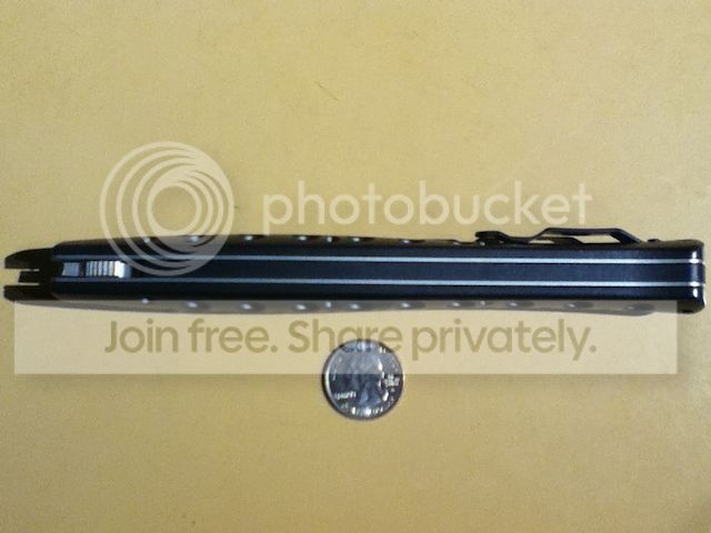

Note the corner that sticks up out of the blade slot when closed. That catches on my pocket before the pocket catch quilion and can start to open the knife while I draw it and not in a good way. Until I taper that corner the secret to a clean draw is twist first. No prob.
Also before I forget I used the suggestion to hook a loop of paracord behind the pocket clip and pull to open up the clip a little. Since this is a heat treated metal handle I wasn't leery about pulling the screws out of the handle or damaging something (well I was a little still ) but I tried it and it worked. I almost over did it but good enough.
Thank you sir; sorry I don't recall your name at the moment. Blame it on manic delirium.
While I was in the shop I spent some time carving nails and then it was back up stairs to take these photos of carnage and mayhem.
Dr. Frankenstein would be pleased.
More later . . . (still got to shape the chisel end and taper the top / spine corner so it doesn't catch on my pocket).

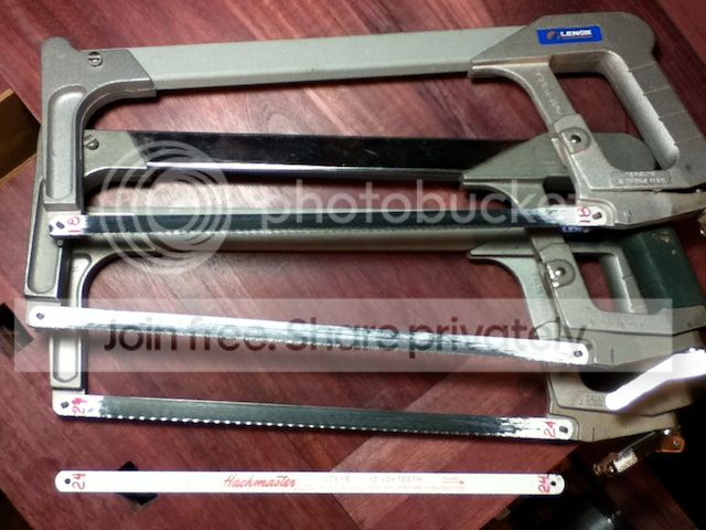

Where's your sense of adventure ?
Nah dude, nah I think you didn't read my comments on sawsalls above. They suck at sawing nails as such.
Too heavy for one thing. Like killing ants with atom bombs.
If I were to want to take the easy way out, the nambi pambi, I don't want to act all insane today rout, the I want to do this quietly and safely and with some measure of poise and . . .
well you get the gist . . .
I would just use one of these
But these can not do what I want to do with this knife and that is not so much nail cutting as metal carving and deburing and general other weirdness.
and huh . . . this is a knife forum not a power tool saws all forum. We do every thing with knifes. Even stuff that is not really recommended to do with knives. Why ? Because we are knife dudes, and dudetts and that's what knife dudes, and dudetts do.
