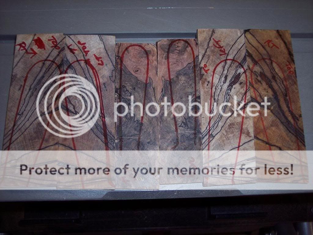

This a WIP I am doing on some Kitchen Blades. I am only doing the handles. The customers picked out some stabilized black line spalted maple.
Here are the blocks that were selected. I picked 2 end grain blocks for the bigger blades, in trying to keep with the same spalting pattern. The little paring blade required something a little fancier with some burl and lighter coloring. Note...These blocks have all been dried, sanded, and sent down to WSSI for stabilizing last year.

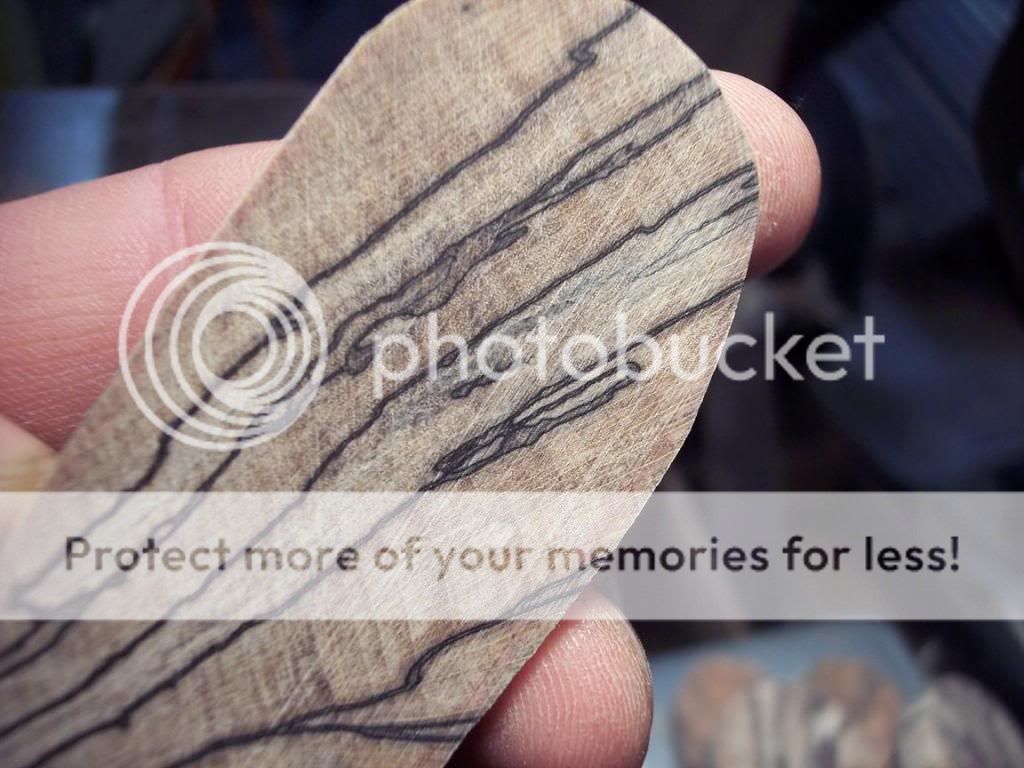

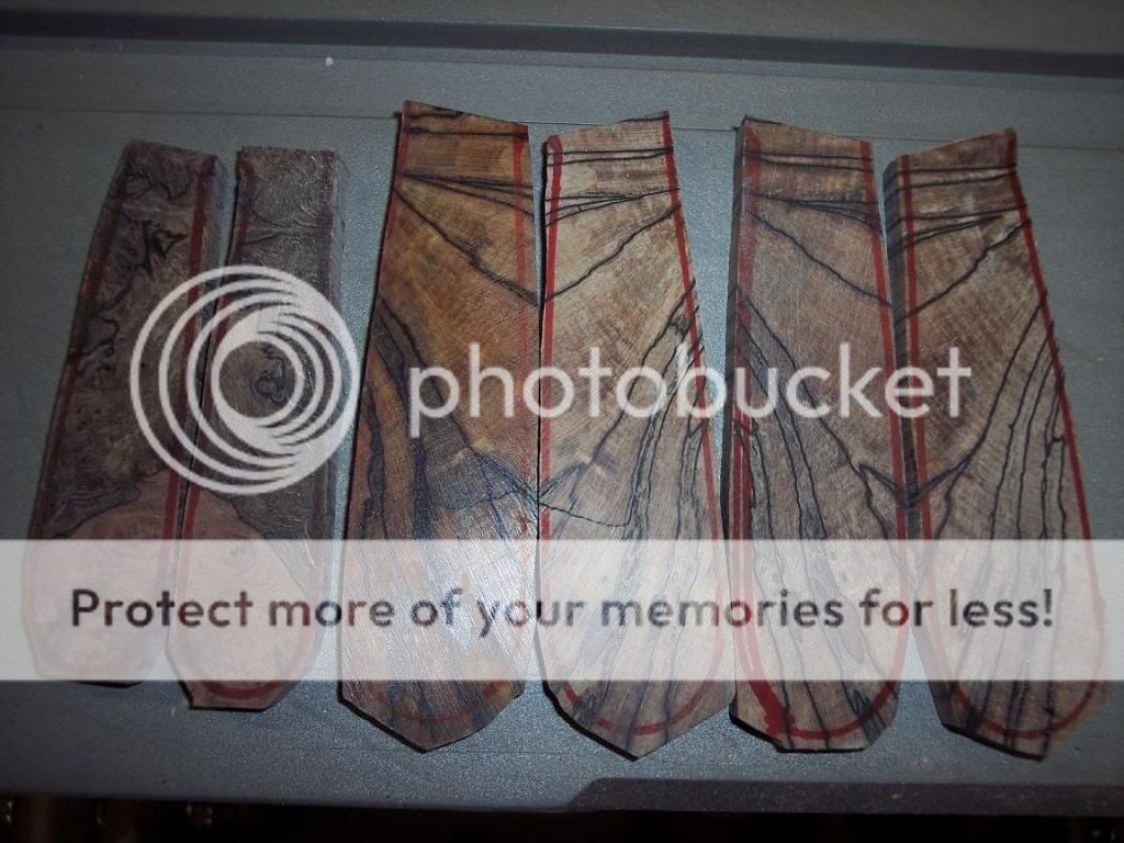

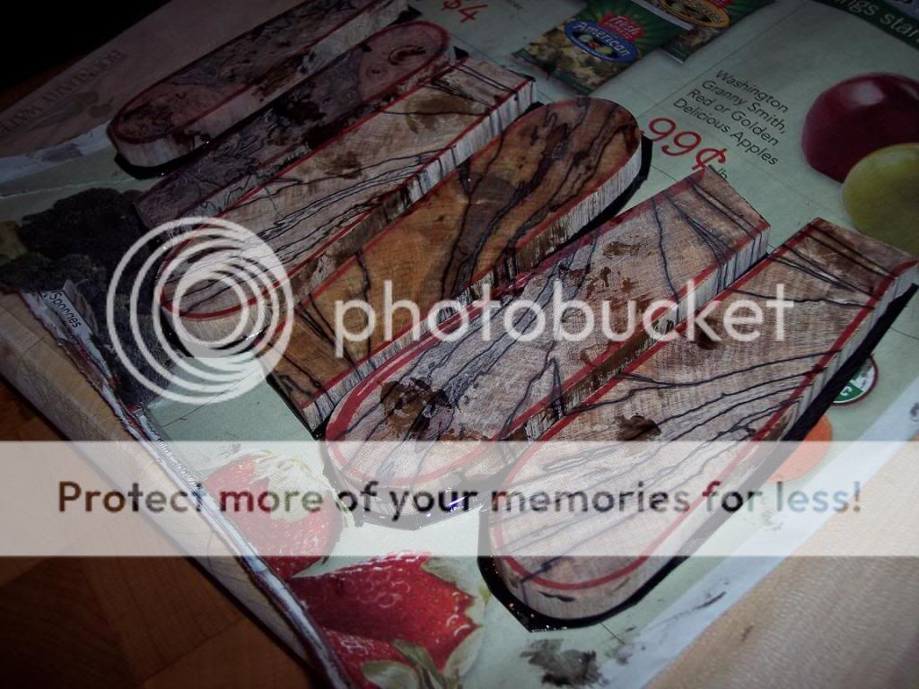

The next step was to bookmatch these blocks into scales, and decide how I wanted the spalting to appear on the handles. This was kind of tricky since I wanted to capture the best of the spalting, so I ended up slanting the blade as I traced it on the scale. I used a medium tip type marker to trace the outline of the blade in red. Since these are end grain blocks there is some cracking and so I will be generous with the epoxy.
Here you can see the blades cut out, and I left a little room around the red lines. I then sanded cleaned up the scales a little on the 1 x 42, and made sure they were flat for liners on the 4 x 36 sander.

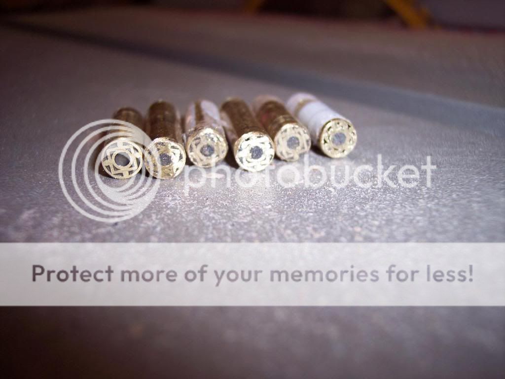

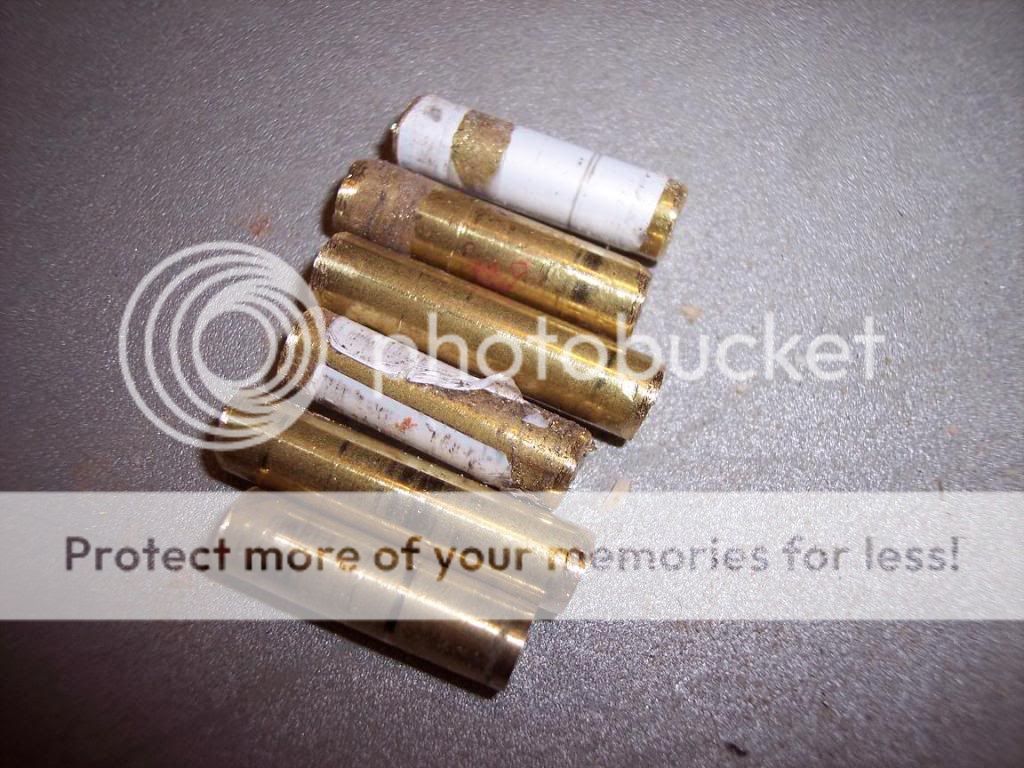

I then cut some mosaic pins on the metal bandsaw, and tried to get them somewhat the same size..... These are nice mosaics from John, with black epoxy centers.

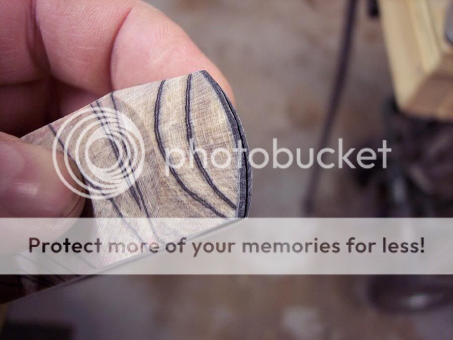

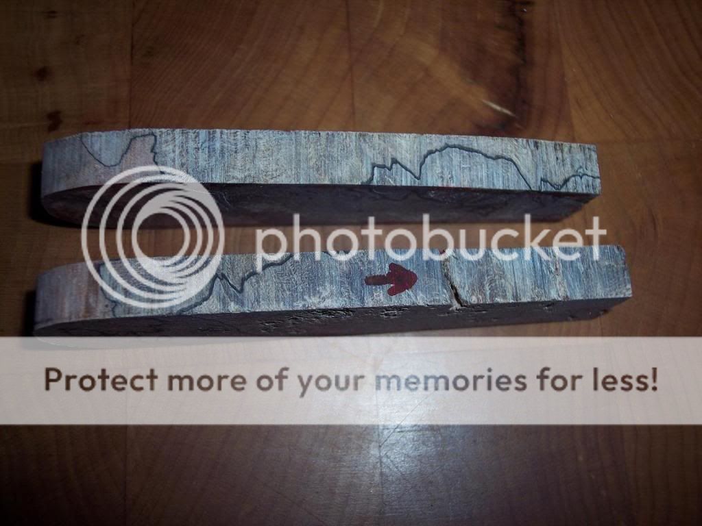

Here you can see the cracking that sometimes occurs in spalted burls and soft material as its stabilized. I will need to fill this in with black epoxy at some point. Not a huge deal, but important to fix.

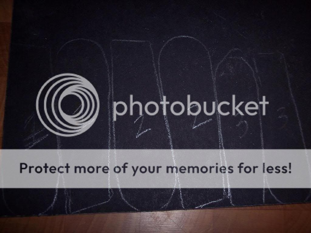

The next step is to trace out your liner material in pencil, and cut it out with a scissors. I like to label the scales by number, and the liners so I know which is left / right, top, in order to try and keep things organized. I picked some nice black liner material from Tracy at USAKnifemaker.com I got some in various thicknesses, but can't say enough about his great service and fast shipping.

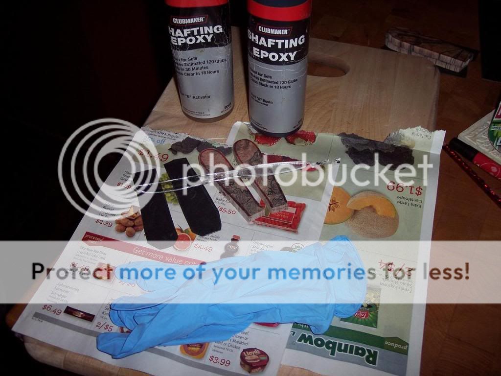

After these were cut out I got out the eopxy supplies. I like the golf epoxy long set that comes in black. I like to use the nitrile gloves from HF, and buy them by the box. I use a plastic knife for spreading the epoxy on the liners and scales. The teeth on the plastic knife has a trowel effect leaving little lines of epoxy which gives you just the right amount you want. I do this on both the liners and the scales. Then I lay the scales on top of the liners and add a little weight. This helps in getting a solid glue up, without squeezing out too much epoxy. This will then sit over night......

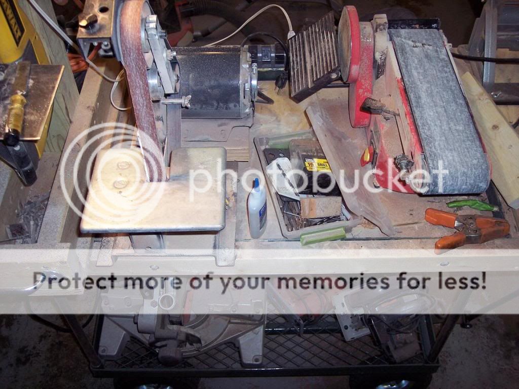

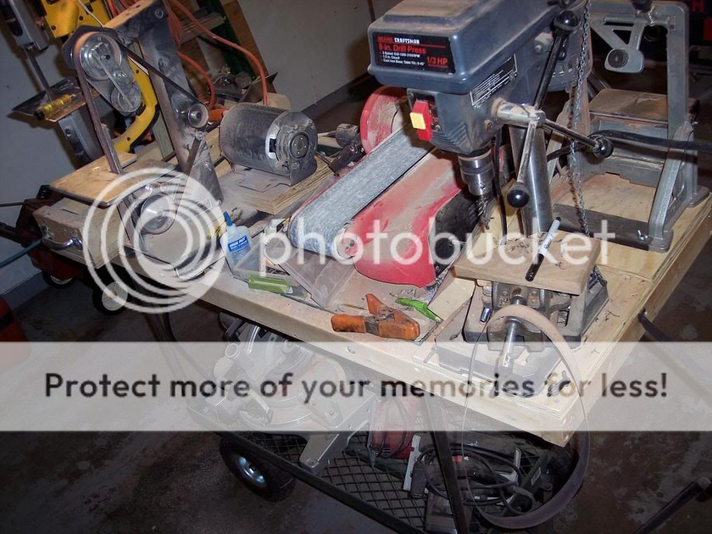

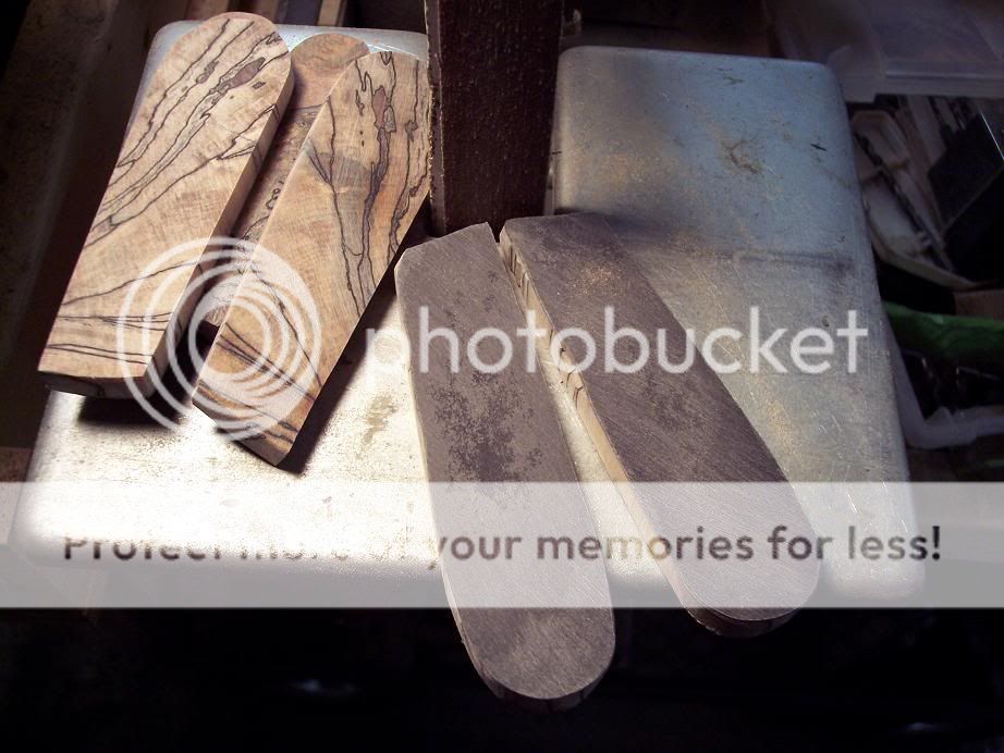

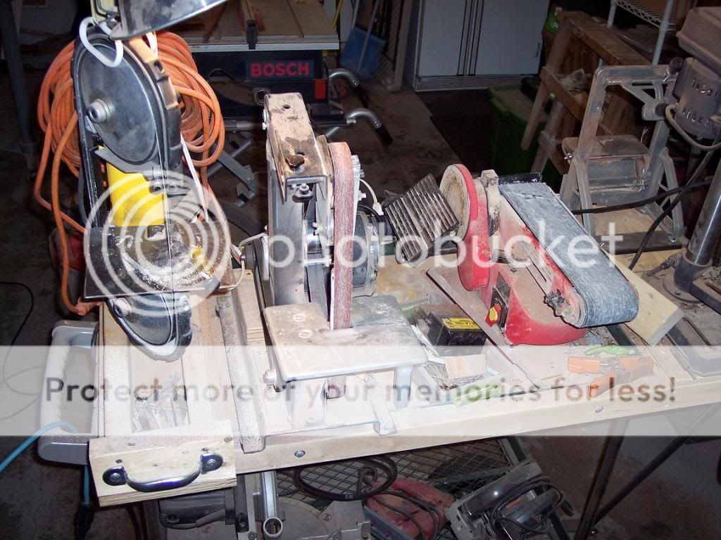

So the next part of the process is to clean up the scales that were glued up overnight. I have a cart that has some tools on it that I use for sanding. This is where I will be cleaning the scales up. I like this set up because I can roll the entire cart outside, and blow it off with the air hose. Pics are below.

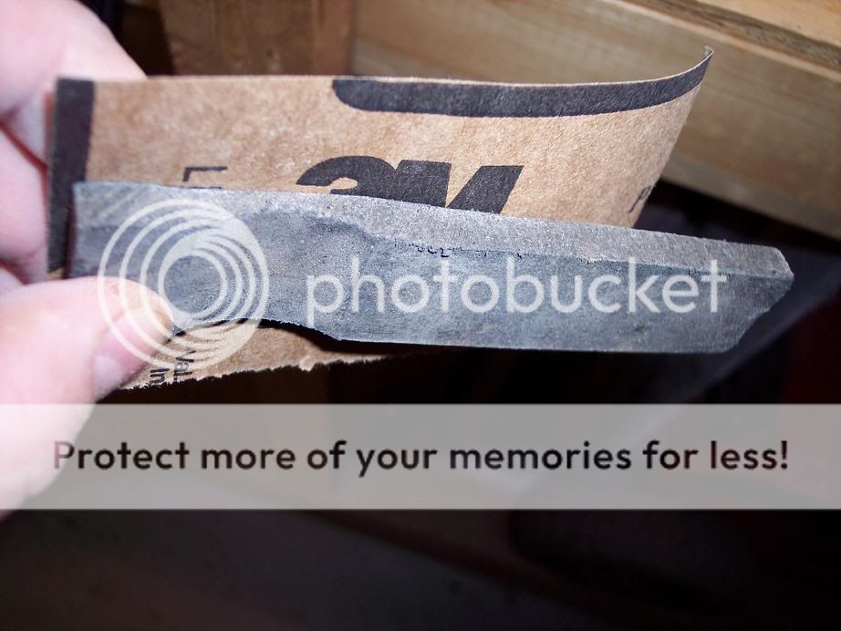

The next step is to bring the liners even with the scales and make sure the front and back are flat. I use the 4 x 36 sander for that, and it eats the liner up pretty fast. You need to use a light touch and not eat into the scales too far or you will need to start all over !!!

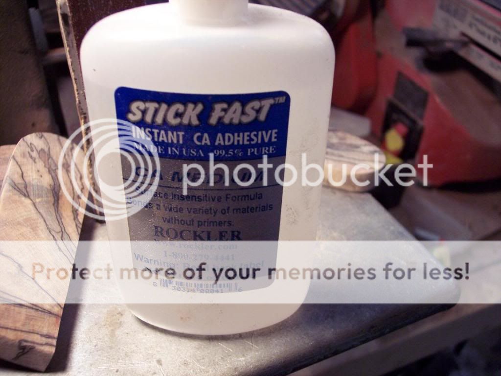

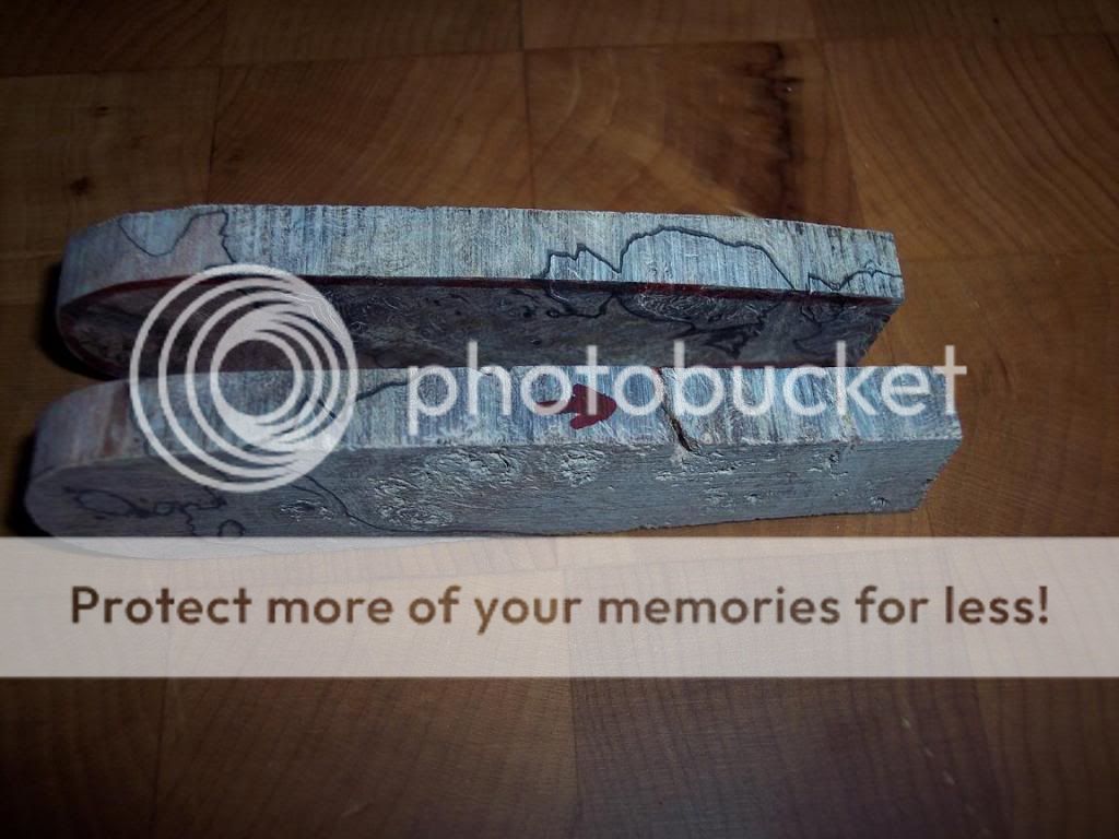

When the scales are cleaned up and ready to go you should look them over and see if there is any cracks or things that can be touched up now. I have a crack in one of my scales so I will fix that with some CA (superglue) I like Med thickness.
Crack is marked with an X
Put a little CA and lightly sand on the sander, to allow the CA and dust to fill the crack, and now the crack is gone.

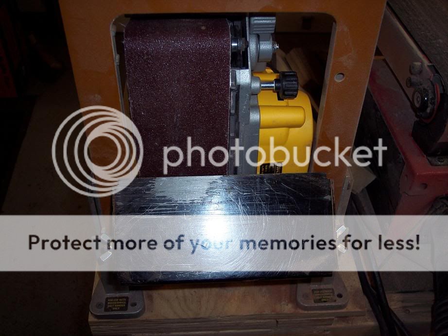

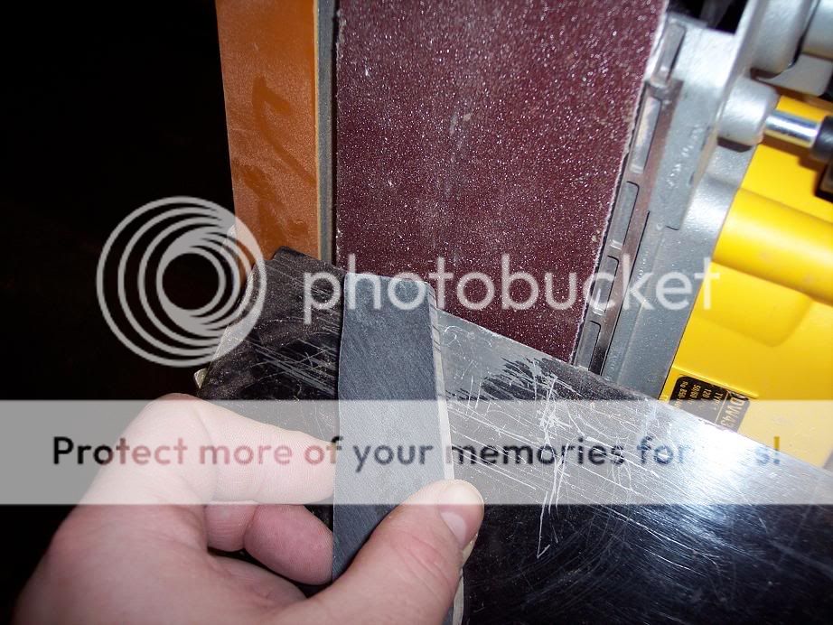

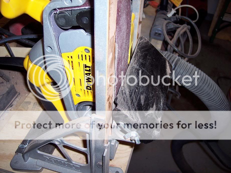

The next thing we need to do is shape, sand and finish the bolster area or front of the scales. This needs to be done now, because you won't be able to sand that area without scratching the blade once the scales are attached. For this process I like to use my dewalt belt sander that is in an upright stand and has an adjustable work rest. I can get a good angle and lock the rest in place so all my scales are the same. I recently had my sander in the shop and the repair guys complained and said they thought I was sanding bricks with it. I guess thats from all the white powder of the stabilized scales.....
Scales were kept long in the front so they could be shaped.
Over to the belt sander...

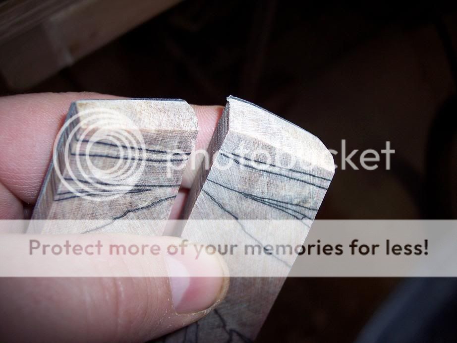

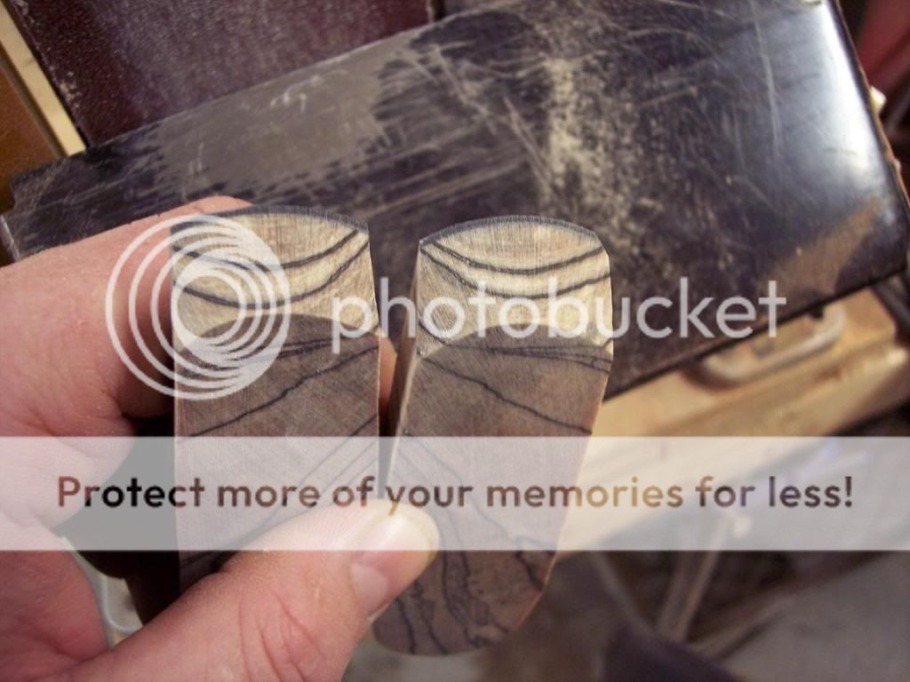

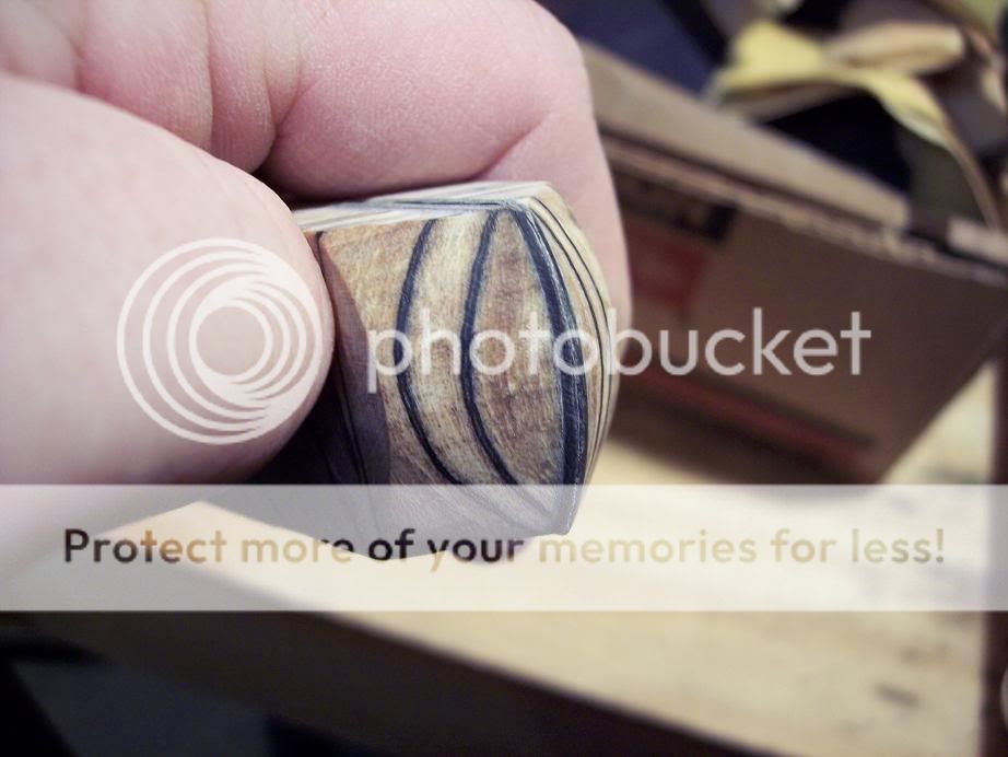

You can now see that the front of the scales have been rounded off at an angle. I did each scale individually and will match them up in just a minute. In order to get them matching up I use double faced carpet tape to tape them together temporarily. Line them up as close as possible, and in this case its easier cuz you have the lines to go by as a guide.

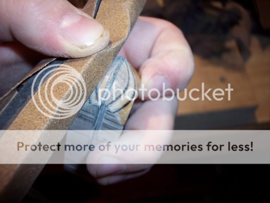

You can now go back to the belt sander with a very light touch and make the scales identical in the front. You can also do this by hand sanding as well if your nervous about taking off too much.....

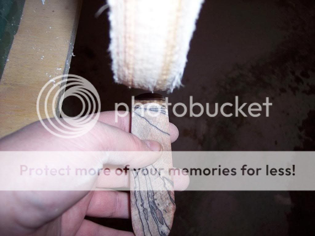

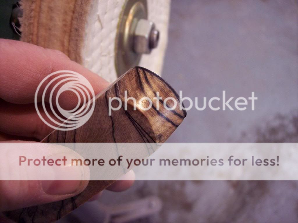

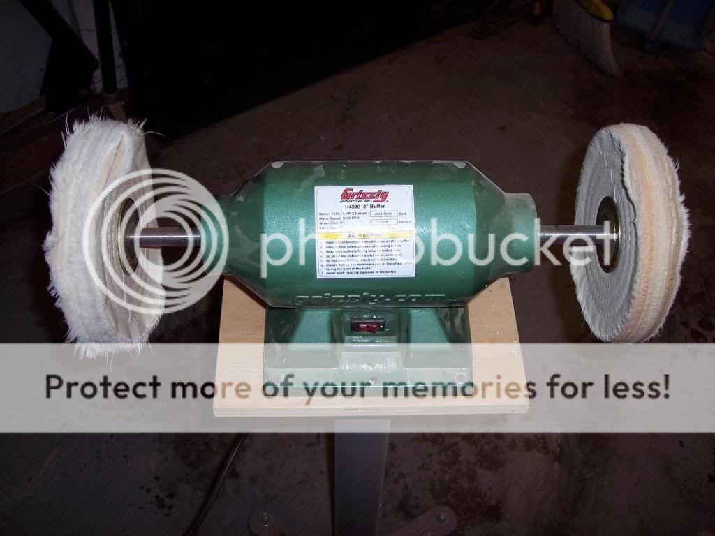

The next thing you need to do is hand sand the front the scales to a high grit level like 800-1000, and then buff. Stabilized scales need to be taken to a higher level of sanding versus raw wood. Once thats done tho buffing is really all that is needed to get a nice shine. I use a piece of rubber for a lot my hand sanding on scales and steel. Rob Johnson out Michigan sent me that little rubber piece and it works well for hand sanding with the finger notch in there. (Thanks Rob) I will hand sand these and then buff until I am satisfied with how they look.
I have a buffer on a stand, but you can buy attachments for cheap for your drill press and use that to buff as well. Be careful on the buffer it spins very fast and will pull stuff out your hands very quickly before you know it and whip it across the room.... Buffing at the bottom of the wheel is best.

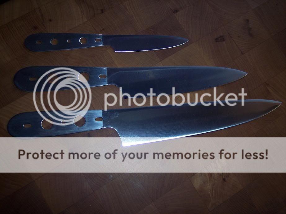

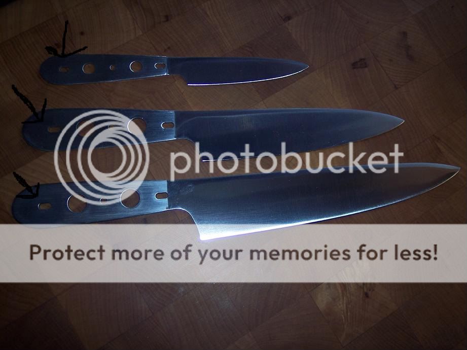

Heres what we are looking at..... 6" and 8" chef blades and a paring blade. These are AUS - 8 stainless, ground, heat treated, and ready for handles and reasonably priced.
For those of you interested in the cart. Heres a pic, and description with the link. I built a little wood platform on the top to attach stuff, and beefed up the support poles to make it taller.
Distribute up to 350 lbs of payload between two high-capacity steel grate shelves and enjoy the convenience of complete mobility! This ruggedly-constructed cart places a wealth of items within easy reach on its top shelf, while the lower shelf provides an excellent storage location for spares. Large 10" x 3 1/2" pneumatic lug wheels roll easily over a wide variety of surfaces. Includes a pivoting tube-steel steering handle. 38"L x 20"W x 32"H. Approximate shipping weight 70 lbs
Link ---> Amazon.com: Grizzly G8155 Nursery Double Cart: Home Improvement

Neato Larry. If you rough sand those pins before cutting them its a lot easier.
Thanks Andy....
Yeah the metal bandsaw likes to spin those pins as it gets going cutting them, and the smaller the pieces the more fun it gets.... Good tip. Thanks Larry

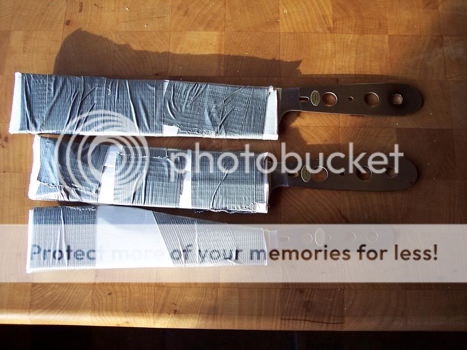

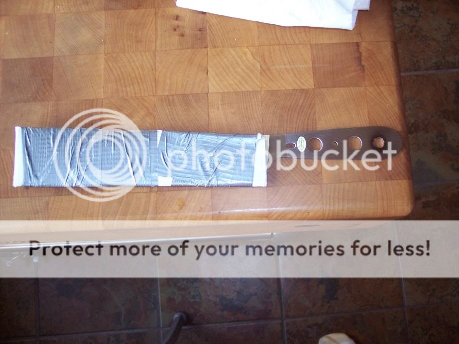

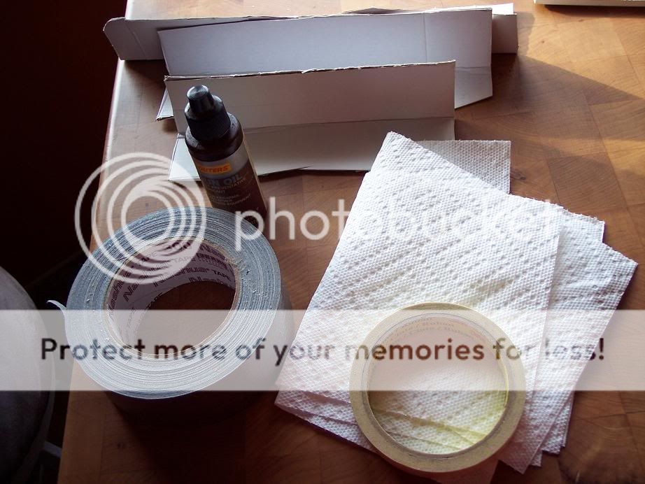

So the next thing you need to do is protect your blades from scratches and you from your blades. This seems like a tedious step but it helps in making sure that you don't have to spend 10 hours hand sanding scratches out of your blade. It also protects you from an already sharp blank in this case.
So the materials I use are easy lift tape (cuban tape). My wife hates when I use it for blades cuz its expensive and she uses it for picture framing, but I try to convince her Im only using a little a bit....... You also need papertowels, a little oil, thin cardboard and some duct tape.
Start with the oil and put a little oil on and smear it over the blade careful not to go to close to the handle or your tape won't stick. These are stainless blades but I do the oil for all blades and that helps to keep things protected from moisture collecting under the paper towel. You can get rust quickly on your carbon blades just from bringing them in from a cold shop to a warm house. So I get in the habit of using a little oil....

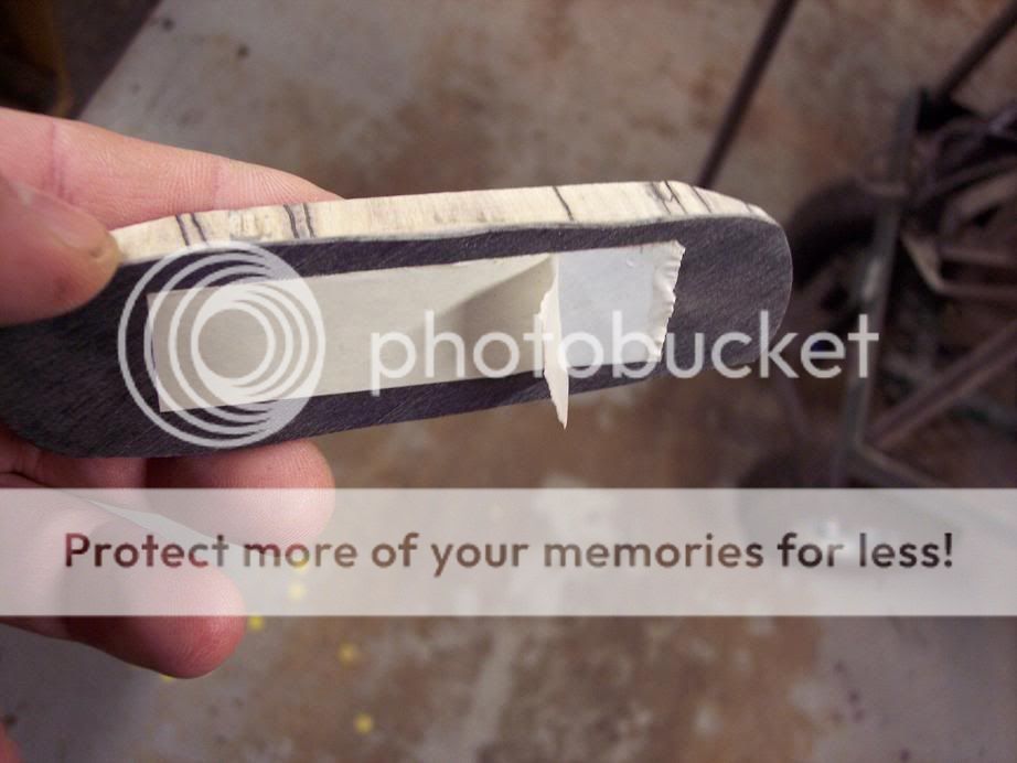

Then wrap your blades in paper towel and tape with the yellow tape near the handle only barely letting the tape get onto the blade.
Then wrap in the folded over cardboard and then duct tape it all together.....

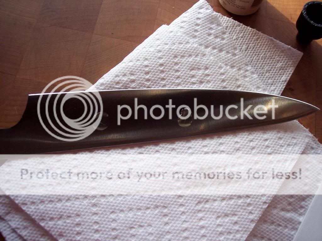

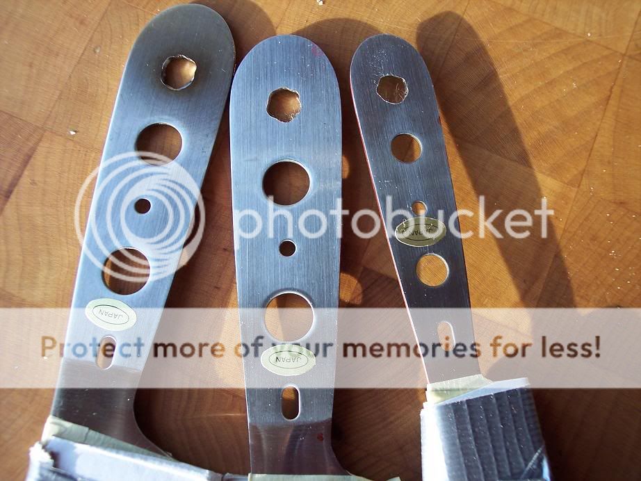

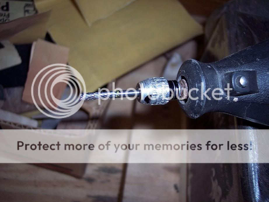

One of many downfalls of using blanks is that you don't get to choose where the holes go in the handle for pin placement. In this case the big holes which are big enough for my pins are too close together. So I need to make that small hole near the butt of the handle bigger. Tried the cobalt drill bit and the hardened steel laughed at me, so I need to get out the dremel with the tungsten cutter bit, and that widened the holes for me.
Original blanks and you can see the rear rectangle shaped pin holes (marked with the arrows) which aren't big enough for my mosaic pins right now......
Here you can see them widened after I used the cutter. Not pretty, but it got the job done.

Another option for wrapping the blades, I have really good luck with blue 1" painters tape, plus the good brands don't leave a residue.
I've found a jewelers saw is the best thing to cut your mosaic pins with. buy a bunch of blades, and learn to cut with a light touch, and they melt in two.
Bill those blanks came from Jantz supply....
Jasper you are absolutely right....Theres tons of different ways to do a lot of this stuff. I've probably bored some of you guys to death by now, but just thought maybe a few folks might pick up a tip or two from everyone's comments. I need to buy a jewelers saw for sure, its a great tool for guards as well.
