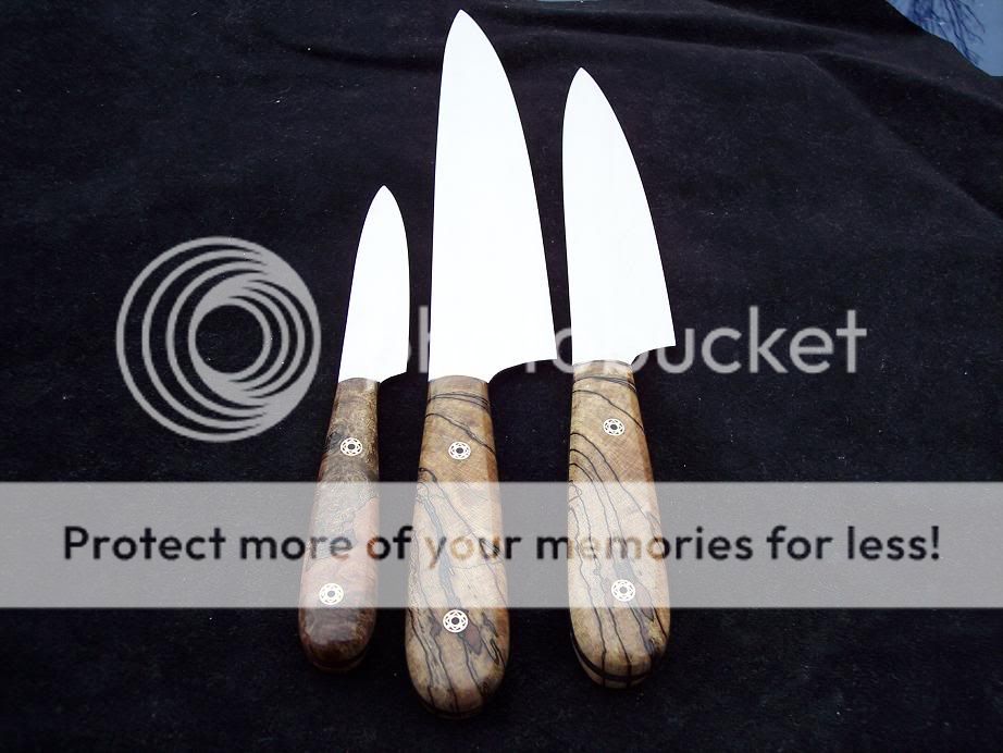

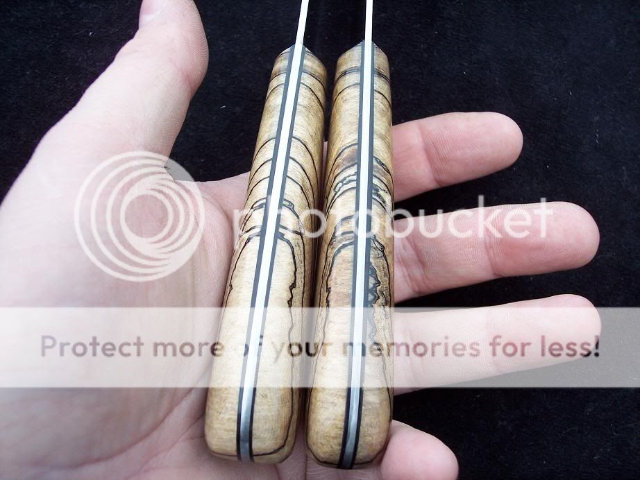

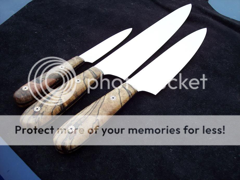

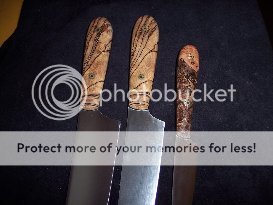

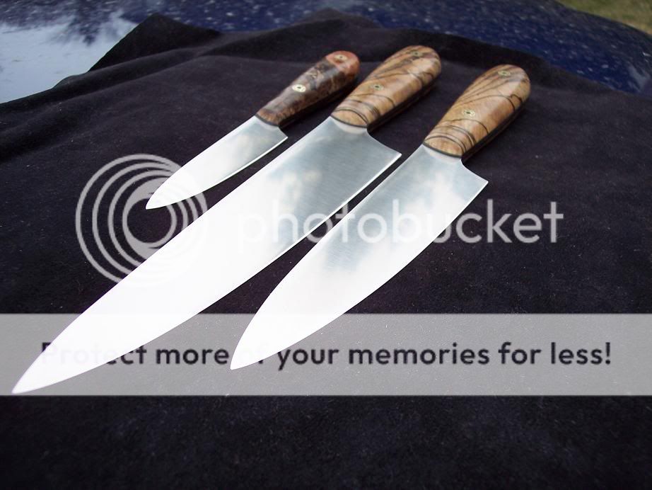

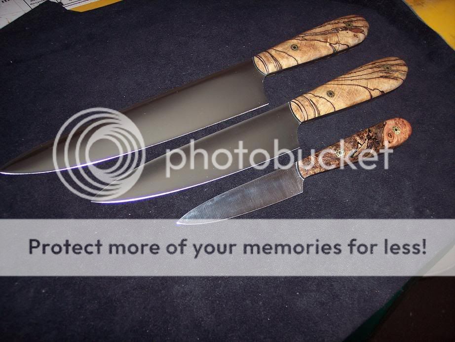

Got these sanded, and cleaned up....Heres a few final pics, and thanks for following along. -Larry
Great tutorial and beautiful knives.
Were there any final steps after the sanding? How fine did you go with the sandpaper grit? Any buffing or topcoat?
Just curious. This was one of the best step by step guides I have seen for scales. Thanks for sharing how you do it.
Thanks guys, I appreciate that. Yep, thats a 8" chef, 6" chef and paring blade. I sanded to about 600, then I used a little dab of oil (helps to see anything you might have missed) and final sand with steel wool at 000. Then a little Ren wax and buff. Thats about it really. I suppose the Ren wax isnt necessary, but I just got some, so I wanted to try it out. :D
