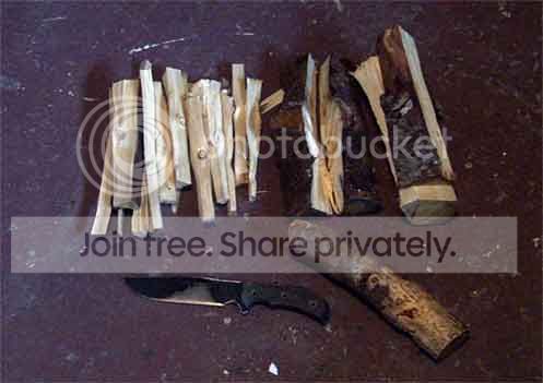

Here is a shot of a Ratweiler with an edge bevel at the same angle as the typical small scandinavian blades :
The edge isn't as wide because of the effect of the primary grind. This knife will actually outcut the Mora 2000 for general wood working, the edges are at the same angle and the Ratweiler is half as thick. The Ratweiler also isn't close to the limit of the geometry for such work because I still want to use it for chopping so I can't reduce it to pure light carving knife in edge profile.

However if you elimate that rather extreme criteria you can go fairly low, the above Ratweiler did the following with no problems :
Note the knots in the fine splits were chisel cut and the large knot in the round was split. I would not want to chisel cut the large one with the current profile but may test it out at a later date. The Extreme Judgement I had in 3V was not impressive steel wise, the edge both deformed and chipped readily. I don't think that's the true performance of the steel though and I would like to see more data on it from Crucible.
