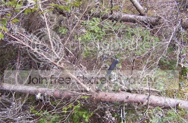

The main reason people by the way have durability issues with the single bevel is that they are usually hollow ground as again this is the cheapest way to make the knives. This is why when people convert them to convex there is a huge increase in durability. This is incorrectly attributed to the convex nature of the grind. The long Mora I have tore up readily on woods the first time I used it. The edge looked like this :
Once the edge was sharpened until the hollow removed the durability was fine and it easily handled limbing of hardwoods :
The performance would of course increase with the addition of a primary grind and suitable adjustment of the edge bevel to compensate, essentially making it into a small parang.
-Cliff
