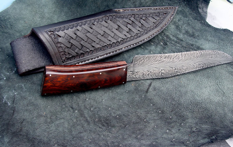

A lot of the fun from working with "W"s is their versatility. I've tried many of the different techniques including what you mention, all with good results. Most of all I like the feather pattern done with "W"s I wouldn't recommend it without a press unless you're feeling like Charles Atlas. :) I got a lot of static on this knife I built two years ago, but I must say after having it over time, it is one of my most prized possessions. We all have our little oddities.
