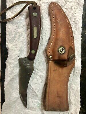

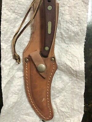

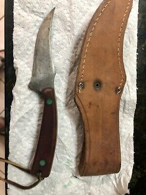

Bought my first 152 user with sheath for $20 off the bay. It'll need a little cleaning and blade work but it'll be in the field with me next time I go out.
Only other 152 I own is part of a scrimshaw set.
Nice one! Doesn't look like it needs much! And if you have read here much then you noticed that your sheath is the earliest type. It, and possibly the knife, are over forty years old! I would be interested in whether or not you find the thong useful. I never did.

I'll post up again. I've never been big on knife thongs and have removed any over the years that have come with them. Always seem to get in the way.
I agree knife doesn't need much just based on those pics. Sheath appears to be in great shape as well, no slice throughs apparent or cut thread.

As to the thong, I never liked the idea of having a knife attached to my wrist. Often in use I need to put it down and to have it swinging around all sharp and pointy doesn't seem like a good idea.
