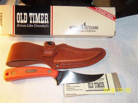

Another special issue Sharpfinger is the 152OTO knife with hunter orange Delrin handle and “LIMITED EDITION” shield. It was commissioned by Smokey Mountain Knife Works circa 1991 for inclusion in their "father and son" hunting sets with the 165OTO "DEERHUNTER", 15OTO "LIMITED EDITION", and 158OTO with an "OLD TIMER" shield. The original production 152OTO most often are found with sheaths having a deer head image embossed on the front. Quite a number of these orange handled knives appeared for sale after the Schrade closing, so they are unique, but not really rare. These used the 1095HC carbon steel blades and had the standard "Schrade USA 152" tangstamp. “Father and Son” sets (152OTO and 15OTO) were again offered in 1998 with the ad copy stating there were 3,000 pieces made. These Orange handled Sharpfingers had plain ground blades, but some knives seen have the later post-July 2001 hollow ground blades showing a subsequent order was placed by SMKW or another large retailer between then and July of 2004.
