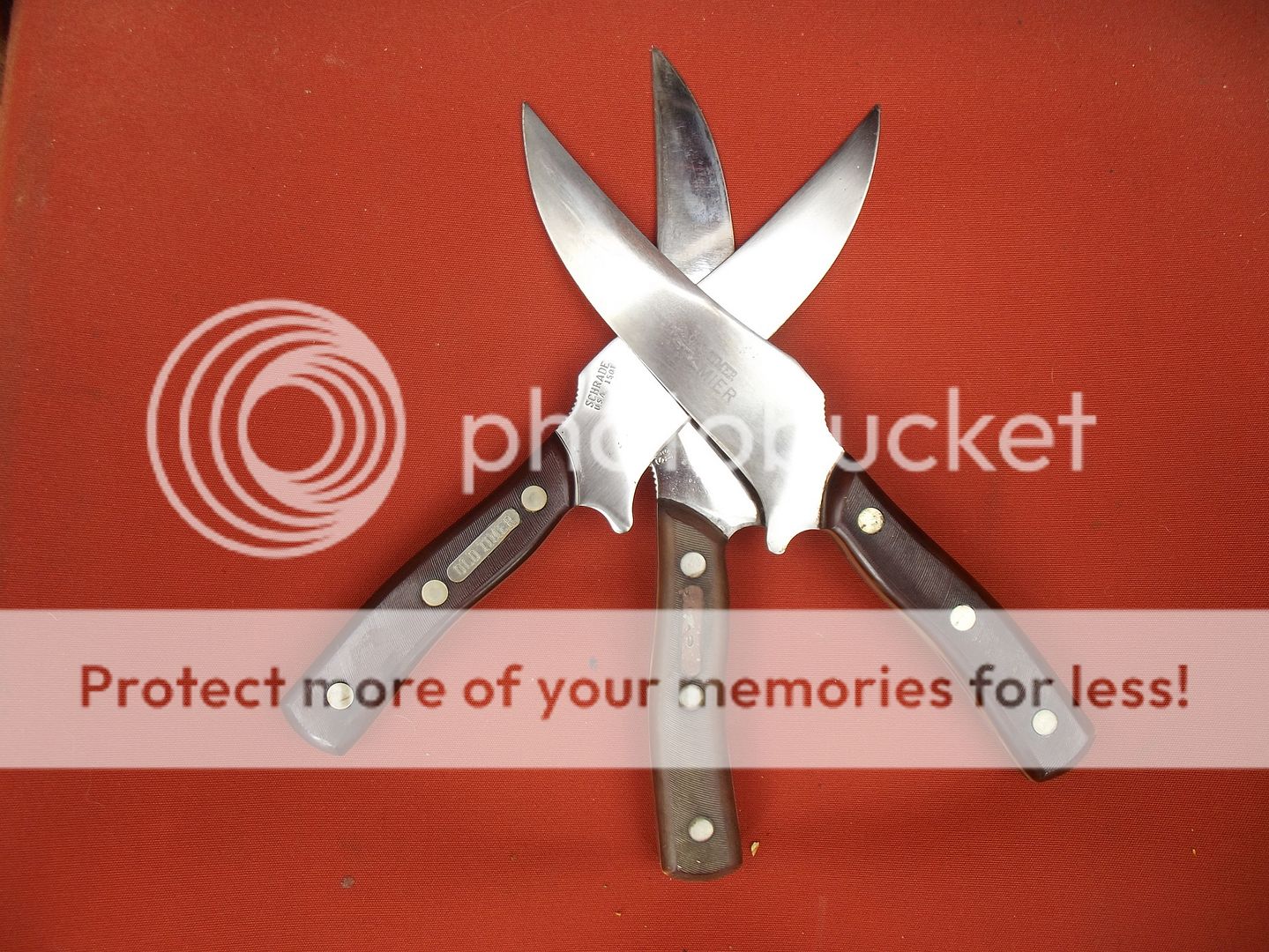

My favourite carbon!.. Schrade did it right .. FES
I kept the Craftsman and gave the others away..I love my Slayer
Beautiful FES! I have a large Old Timer like this and have thought of putting some stag on it...now I am obsessed with the idea after seeing this wonderful knife :thumbup: thanks for posting this pic!
As much as I love stag, there is no way I could ever rehandle my Deerslayer. It would be fantastic but that is one special knife to me.
Thank you Michael. This will be buried with me.
