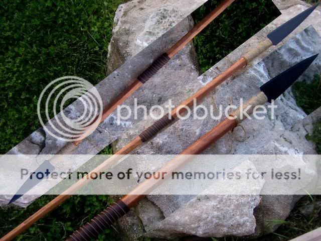

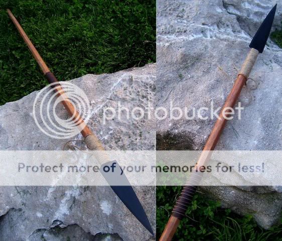

Scorpion Battle Spear - Influenced by the Historical Dory Spear – For Sale
Will be Putting out a video on it soon
Shop Details:
5160 Steel Spear Head was cut out and Normalized @ 1500 degrees until non magnetic, three times, to remove stresses and align crystals. Heat Hardened until spear head became nonmagnetic, then quenched in 125 degree quality oil. Tempered the spear head to a straw hardness @ 425 degrees for 1 hour, letting it air cool and repeating once more.
Measurements:
Total Length = 7 Foot
Blade Length = 10 “
Blade Width = 2”
Blade Thickness = ¼ “
Handle Length = 6 Foot 2”
Handle Width = 1 ¼
Handle: Pine
Weight = 2 Lbs
Asking $89 plus $26 shipping fee, if shipped in the US. You can send through Paypal to ScorpionBows@mchsi.com or mail M/O to our address (see web site for address).
Pictures below. Thanks.
