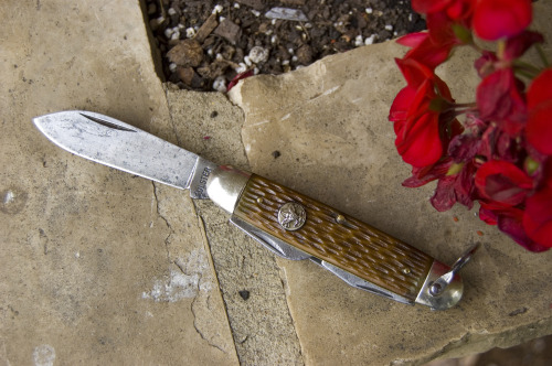

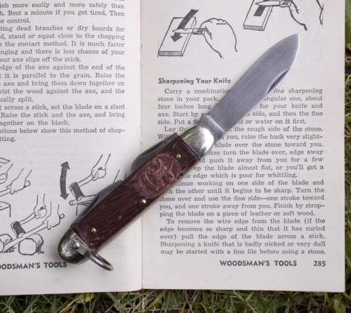

And here are two of mine:

The top one is an Imperial (ca.1958-62) , the lower one is Ulster (1962-79). Both are carbon steel.

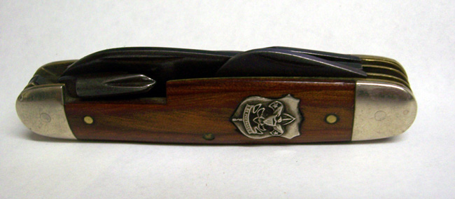

I also have a different Imperial ("5-blade" = flip-out Phillips head + usual four blades), made in 1952-62 —
IMPC5A, BSA #1046:
(Image is from the Scoutknives.net site)
All three are carbon steel.
