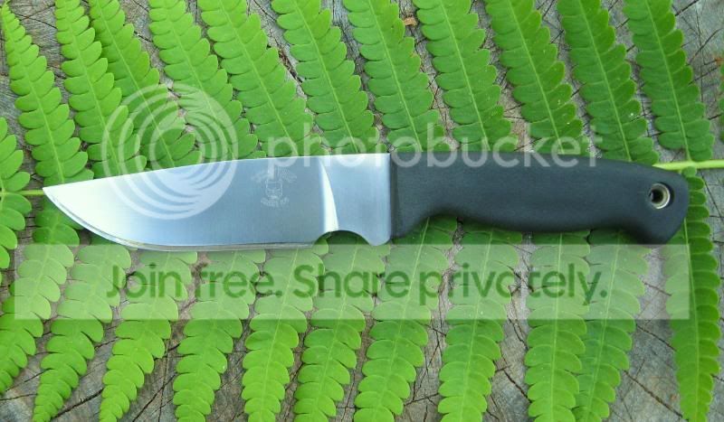

SOLID-built for the Pry Bar camp for sure. But at the same time DULL!!!! I expected a bit of an obtuse edge but I am having trouble getting it to cut paper, let alone anything on Manilla rope or shaving hair. The handle is a bit thin & square from first impressions, but is very solid in the hand. I stabbed a block of wood in both reverse and forward grip and the knife held solid, as well as a few seconds on my hanging training dummy (but hardly cut through the jean jacket). Don't care for the choil design- too far from the handle so Index finger is separated from the rest of the fingers. If the choil would touch the handle it would be more to my liking, rather than having the rounded portion between the choil and handle. I like some little features on the handle- there is a small divot on the thumb ramp and on the underside of the grip- this leaves a thumb ramp in both blade up and blade down grip, and the plunge lines are softened so they do not dig into the hand when choking up on the blade.
The pinkie catch works very well when I chopped with it- I only used a 2 finger grip on the handle and it felt secure. Chopped fairly well, a solid chopper for the size. The knife balances at the blade/handle junction, which surprised me as it chops with a blade heavy feel.
I took it to my Spyderco Sharpmaker and the 30 and 40 degree sticks only touched the shoulders of the bevel. I don't think I will try to get the bevels
down as I am a sloppy sharpener and don't want to scratch up the blade too much (still too new and new car syndrome). Maybe a bit of convexing at the high angle if that is OK with all involved.

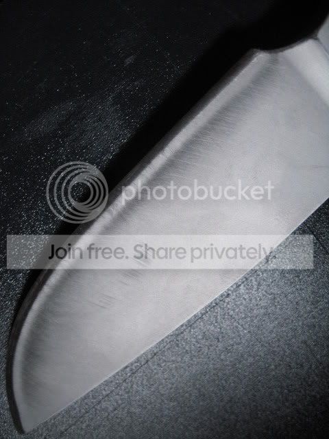

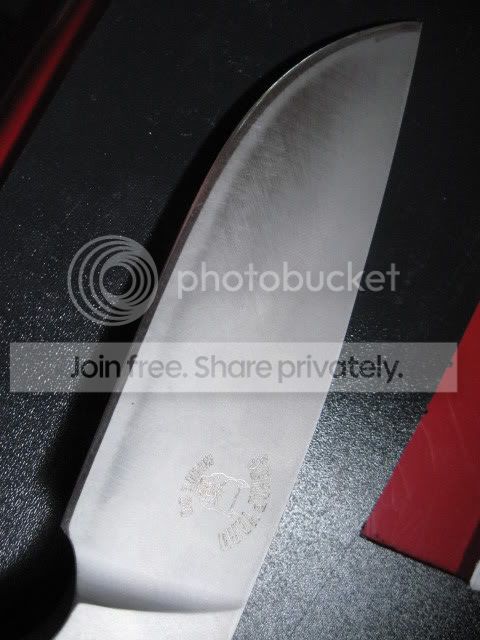

OK so I have been busy this weekend but managed some work with the knife. Here is what it looks like after a trip to my 4x36 grinder and diamond steel (messed up the finish a bit so I am to blame if it does not come back in new condition).
It isn't too pretty, and not as thin as I would take it if it were mine but I wanted to keep it as a sharpened prybar, as that seems to be its intended purpose. It is now hair scraping sharp, will slice paper at the right angle, and slices through my clothing dummy well enough.

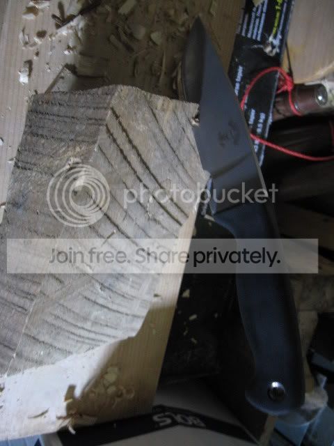

(My chopping block.)
(fuzz sitcks)

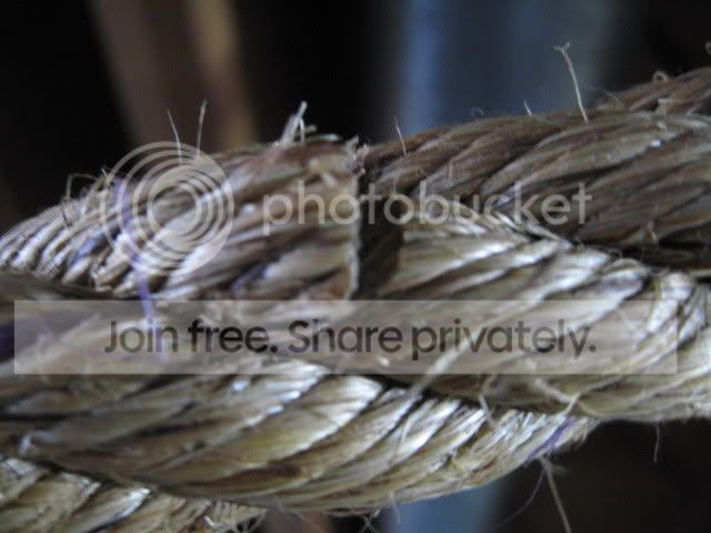

(light hearted swing at 1" manilla)

I'll admit that it has grown on me, but still don't care for the choil area- just too much separation between index and middle finger when using choil. I like the Res-C handle for chopping- it chops better than my other blades its size- but most of my blades this size are for slicing not chopping. The handle absorbs shock well- is more comfortable than I thought it would be upon first impressions. It is what I would consider for one knife only survival (solid) or military uses due to its thickness and mid size. I still don't think that it is for me, unless it is the right price (or if I messed it up too much "sharpening" it ;))

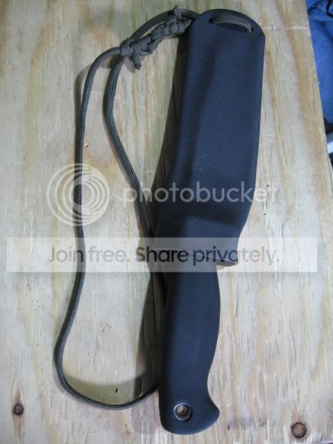

OOPS- almost forgot this:
Hope you don't mind me clothing your baby but it is snowing like crazy here and I can't in good conscience send it away without something to wear:D
It is one of my fold over Kydex sheaths, no rivets or glue in it. I have used these for a few years and have not had any problems on my knives. The neck cord is cheap paracord (not 5 strand), tied with multiple slip knots as I have a very big head and others will probably want to adjust it to fit their small heads (ummmm... not that small head guys:o) I wore it around today after making it and it actually carried very well for its size- surprised me. Very solid grip on the knife, but a quick jerk sets it free. The blade goes into the crease (not the fold over) and there is a bit of a thumb ramp.

Kris, I cant believe you messed up the knife like that expect to see a bill from me comming directly. (j/k) Dont worry it looks fine, and now it actually does cut as well as pry. Nice review and sheath. Thank you, I imagine it was getting cold without pants on.
