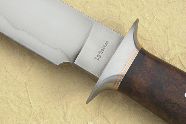

Man this is a great WIP. After seeing some of your knives I wondered how intentional that flat that transitions from the guard to the handle was. Now I realize that every single curve and detail are thought out and intentional. When you use the squishy backed sanding stick on the "ass end" of that handle does that wash out the G10 and if so is that intentional to have more of a spherical ass all the way across the g10 and steel?

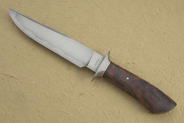

629hugo- the answer to that gets into a bit of semantics. When you're trying to keep transitions crisp and clean, I usually talk about avoiding "washing-out" an area. But it could also be described as smoothing/rounding over. Since we want the pommel/butt/ass-end to be nice and smooth AND since there are no metal parts to transition into... then a squishy block that helps round stuff over is good. I should point out that if this were a full tang knife and we had an exposed tang right in the middle of the pommel area... then I would use a more rigid block.
The way you worded your post was just fine, I sure didn't take any offense to it. I do try very hard to make sure that every aspect of my knives is done with an intention... I remember Ed Caffrey, MS, telling me about 17 years ago... "I try to make my knives in a way that everything looks like it was done on purpose."
That probably sounds a bit silly to a non-knife person... but any of us that make knives get it. As you're learning (well, this is sure true for me anyway!) there is often a gap between what we WANT the knife to be like, and what we are actually capable of building. The best example of that is the notion that most of us start out thinking we're going to build a museum quality knife right out of the gate, but the first knife ends up looking like a prison shank. :eek: :foot: :D
Just for the record--- the sides of my handles aren't actually FLAT...they're just a gentle arc that matches the sides of the guard. If you made them FLAT-FLAT, then it would be really easy to keep the transitions crisp and clean, but it wouldn't fit into the hand very well. With a gentle arc, it makes it harder to keep the transitions crisp, but it gives enough of a flat-ish area that the knife will VERY quickly and easily index in the user's hand... And IMHO has a nice look to it.
On some of my knives I make that whole plane crisp for aesthetic reasons. On some, I want it crisp at the guard to handle transition, but want it to fade away into the swells and recesses.
Just for a quick walk down memory lane and some visuals to help explain... Here is one of the first fighters where I was starting to get the handle shaping dialed in to produce something closer to the image I had in my head--- (this was around 15-16 years ago)
A few years down the road I was getting a lot closer to the vision in my head...
Fast forward a bit... and here is a photo of the first knife where I really made a concerted effort to keep that plane smooth but crisp, and actually achieved what I had in my mind's eye. This was one of my Js submission knives in 2007. I remember Dickie Robinson, MS (RIP) asking me, "How the heck did y'all do that, it reminds me of the shapes on a fine English stock?" Talk about making your head swell! ;) :D
On fighters like this one, I wanted the transitions near the guard to be super crisp for visual effect and functionally for easy indexing, but I wanted the transition into the palm recess to fade off smoothly...
Hope this helps clear up the mud a bit... :)
For what it's worth... I do realize that "plane" is, by definition, a flat surface... so I am probably confusing things a bit with my wording since I said the sides are not actually flat. :foot:
But I'm not sure of a better way to describe that area in simple terms. I could start blabbering about things like principle curvature, curvature from arc and chord length, and the surface's tangent plane... But I would probably only confuse everyone (including myself) except maybe a couple of super nerdy engineers. ;) :p
