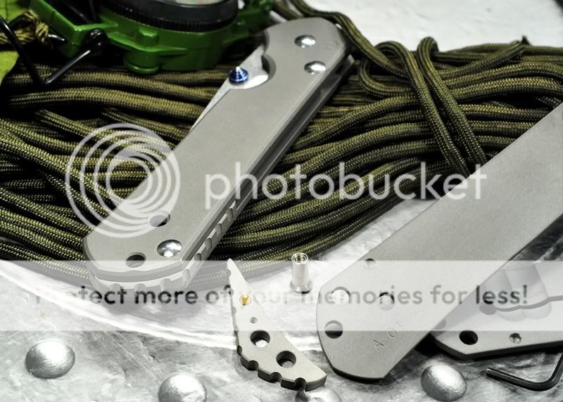

So... what about Sebenza backspacer v.2 guys? Thos one needs some drilling in the scales (about 0.100", but still). Brass pins stabilise the spacer, while the stainless post takes the whole impact (if used as an impact device). This design still allows to re-convert back to original look but leaves the lanyard hope open and fully usable even with the backspacer installed. Man, alligning this setup was not easy... remember, I didn't drill through the scales, only a bit into Ti on the inside. Works good. The owner, who is my friend, should like it :D
Nice work, a full back spacer up to the stop pin would look pretty good in that style I think :thumbup:
