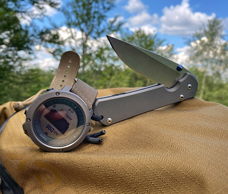

Checked my S31 after about two weeks now. No side-2-side play at all. Lock flex is just as it was. So far so good. Another day in the wild...
